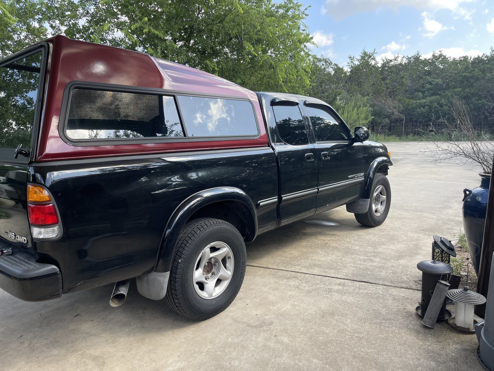

    jokes aside, my cap & bed floor & dog platform, 3-400lbs, leveled my truck pretty nice, and the 6112/5100 (no lift) handle everything the roads can throw at it with finesse and composure.

    leveled is leveled.
    Add 320lbs for me & my dog & it holds up to a bubble level on the rockers & crossmembers.
