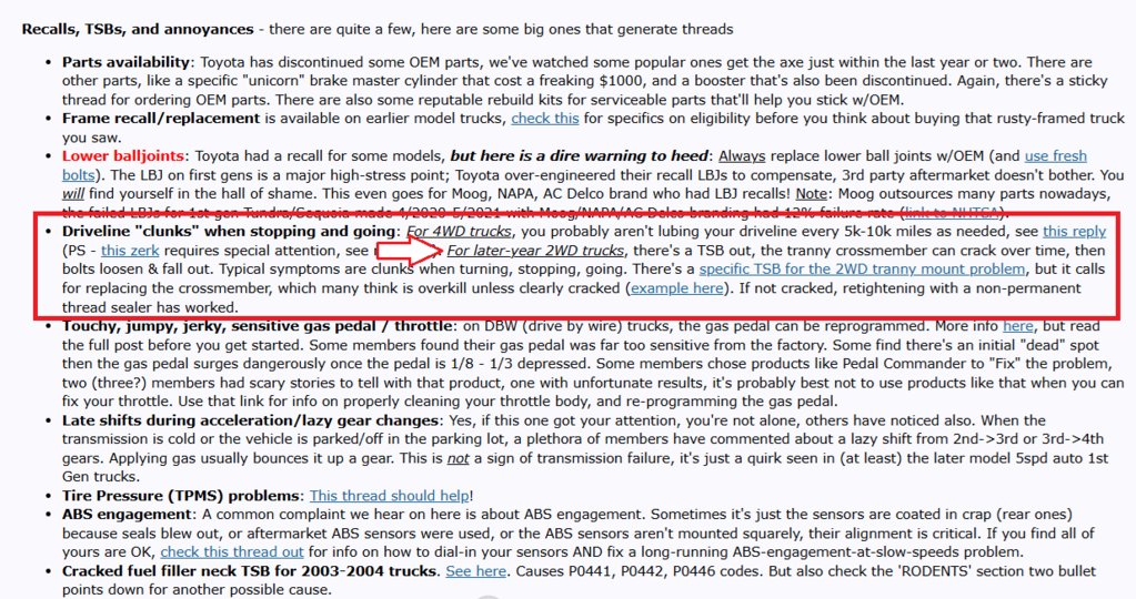

    Glad you got it solved. It was absolutely the transmission mount. We cover that problem HERE with tons of other problems, it's a very well-known issue.
    Thing is, that issue usually happens because the crossmember is physically cracked. Toyota has a TSB out for it. The only permanent solve is to replace the crossmember if cracked, or it'll happen again. Sometimes the cracks are hairline and you may not immediately see them. That thread I just linked with "HERE" takes you to the TSB and is also linking you with a picture of how invisible the cracks can be to spot.
