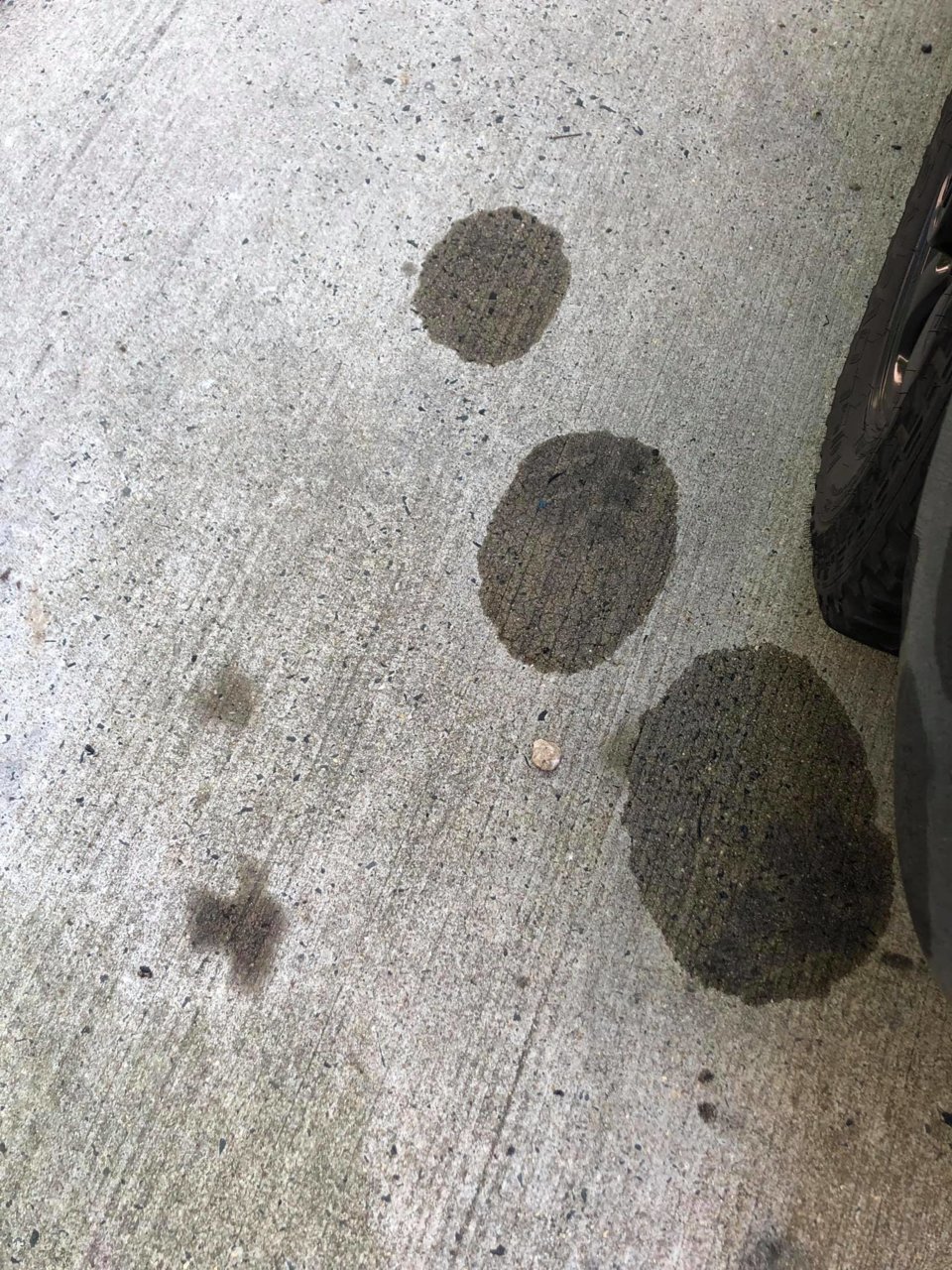

    3" Ready lift along with diff drop was installed by a known off road shop about 2 weeks ago. Afterwords I started noticing wet spots in my driveway.
    Current:
    Today I crawled underneath and found some, 3 actually, bolts going inside the diff that seem to be loose. I grab a wrench and tightened them down.
    Does anyone know the torque specs on these three bolts? Pictures below:
    Wet spots...

    I was losing fluid after the shop installed everything. You can see in the second picture how much of a gap is between the bolt head and diff. If you torqued them by hand and that's fine, I should be good to go. I gave them a good amount of force with my wrench. Thanks
