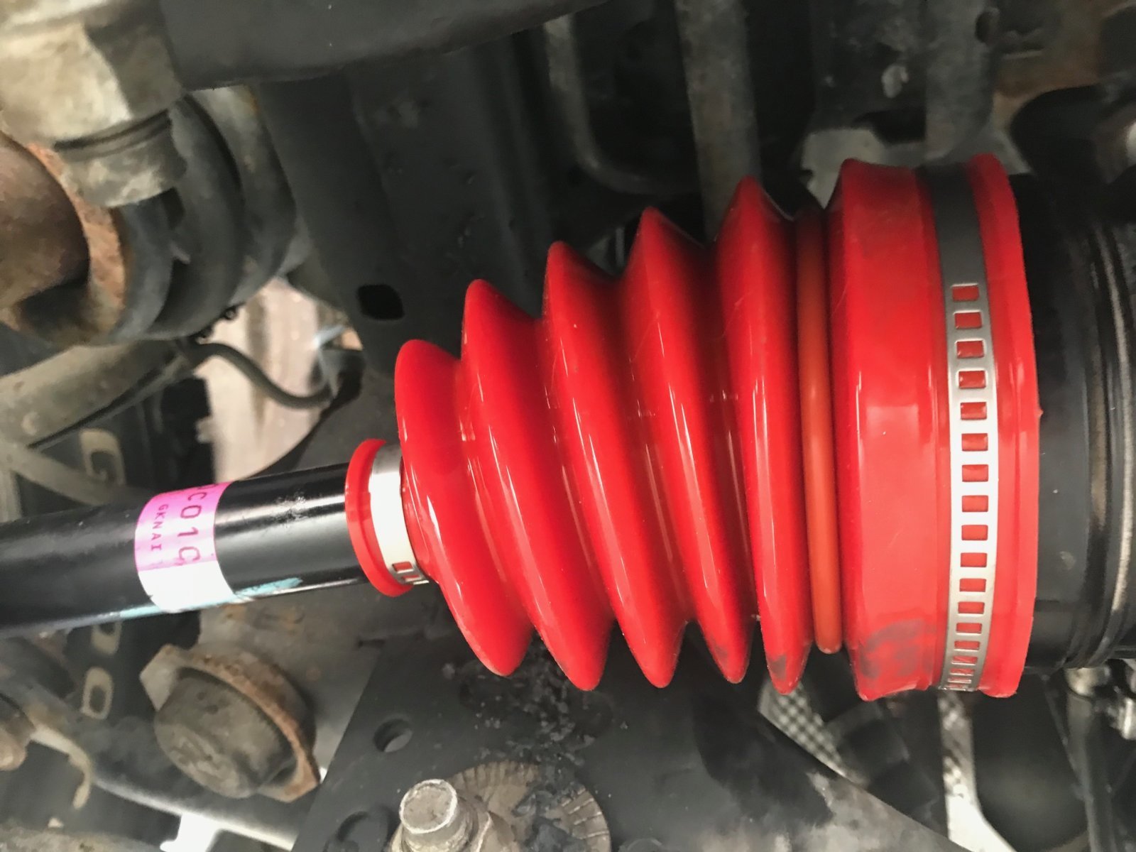

    Mine are hanging in just fine (all paved though for me)..

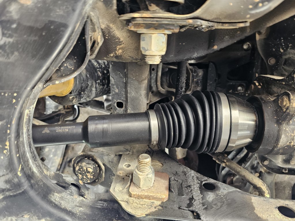

    I have an '05 with a 3" lift on 34's. Just replaced a boot while installing the lift. After a couple months and 2 off-road trips, OEM boots tore on both sides. Just upgraded. My mechanic has used these on several 1st Gen Tundras with good feedback.

    What are “these”?

    I also want to know what they are ?
    I did the off road solutions boot on a reman axle and I have been happy.

    That p/n is the same as on my Trakmotive extended travel CVs.

    Yes. They're the TrakMotive extended travel CV axles.
