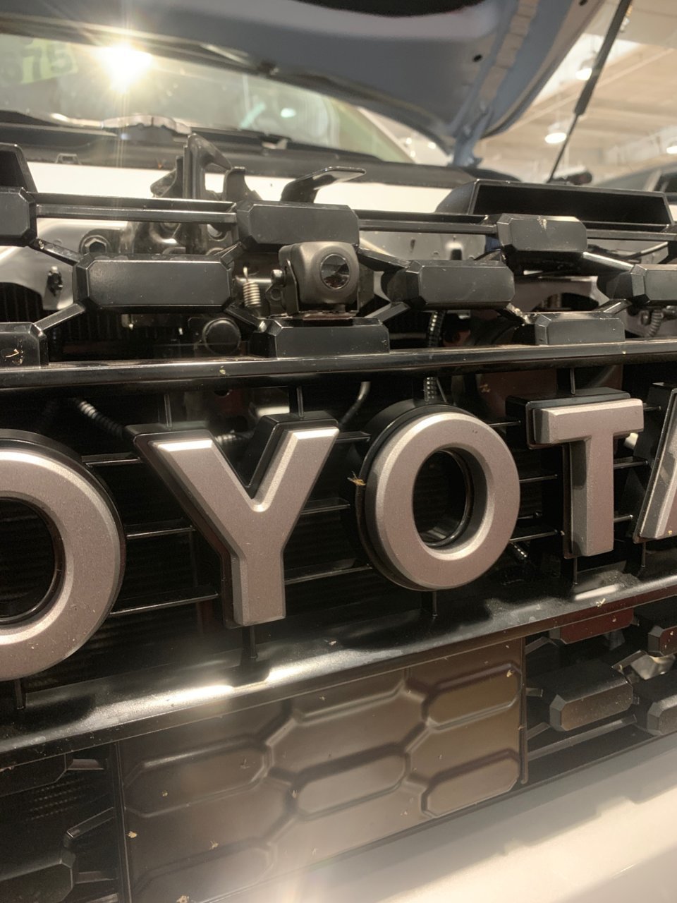

    yup! I have a camera installed in my grill.
    let me find the link for the FRAC

    Does anyone have this front camera frac harness or a different variation on a 2012 tundra? I have the display in the rearview mirror currently for the reverse cam... Wanting to add an anytime front camera to also display on mirror.
    Thoughts or ideas are always welcome. Thanks

    I used this one from the FRAC harness thread and made a bracket to mount it below the emblem on the grille of my 19. I put the camera in today and hope to find some time this weekend to finish hooking up the FRAC harness in the dash.
    https://www.amazon.com/gp/product/B07H852D49/ref=ppx_yo_dt_b_asin_title_o06_s00?ie=UTF8&psc=1
