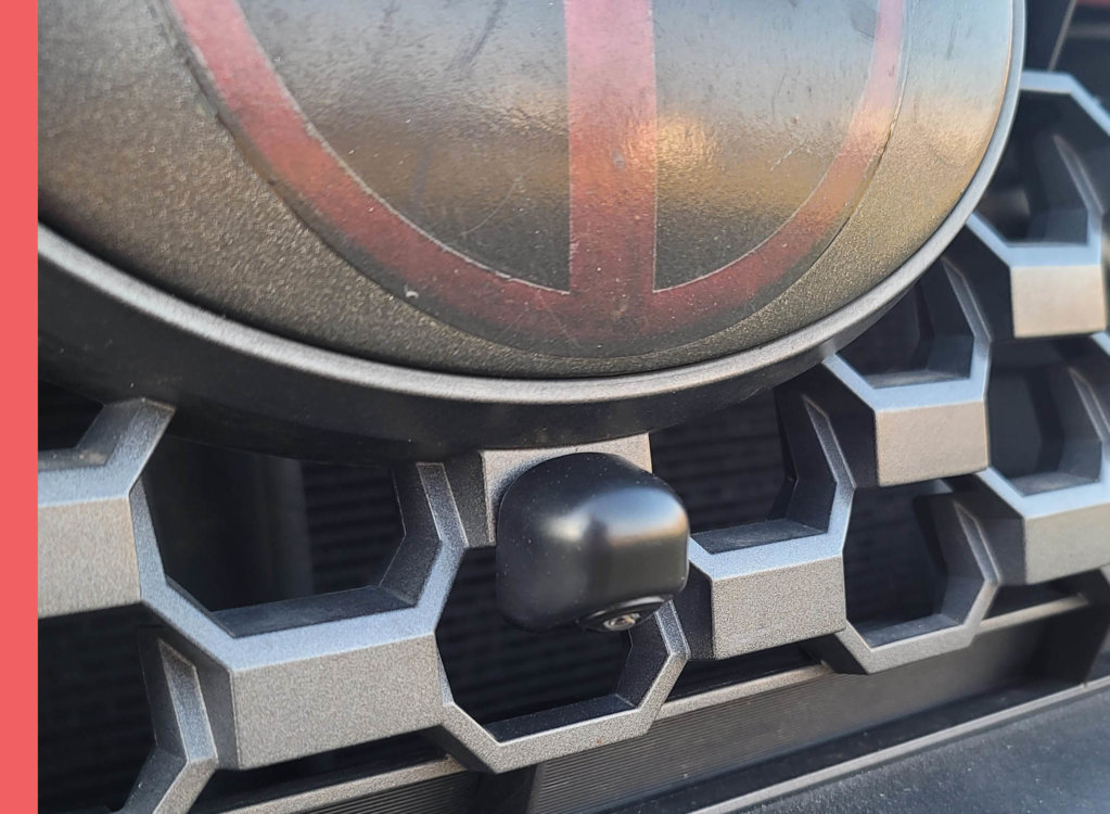

  29. Mar 6, 2025 at 6:12 PM
    #29
    Mosey
    Mosey New Member
    Feb 21, 2025
    #130719
    17
    2018 Tundra Crewmax
    Natika camera, Mounted horizontally rather than vertically. Drilled a single 5/16 inch hole, filed down the plastic lip on the back side of the grill, and tightened the restraining nut. Snipped the appropriate wires per the directions for the correct view on the Head Unit. Wiring harness is run on the drivers side around the battery and fuse box and through the rubber grommet in the firewall on that side. Power is drawn from an 'Add-A-Tap' on the DRL fuse in the box under the hood.
