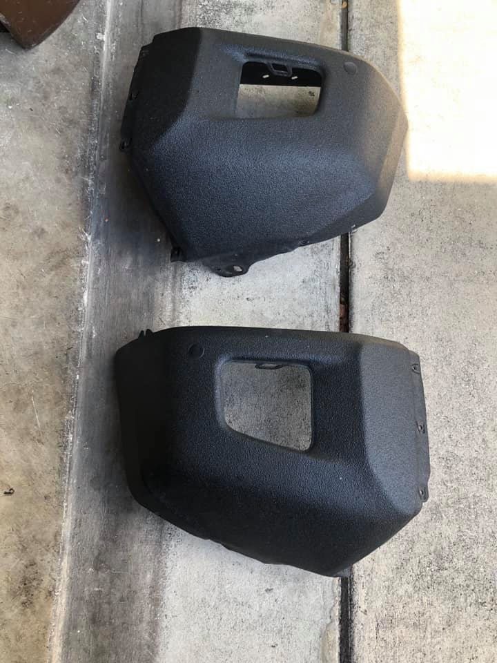

    So I bought some new front bumper ends that are rhino lined. Going to replace my shotty platidipped chrome ones.
    Not finding a lot on how to get to them. By the looks of it I need to remove the front bumper center valance. Then that should expose all the screws for the bumper ends?
    Anyone got any advice, write ups or videos to follow? Thanks!

    Save yourself some time and remove entire bumper. Six screws from frame and disconnect the fogs.

    X2. It’s not difficult to do the whole thing and then dissemble once it’s off.

    I never found anything good showing how to do it so I just winged it, ha. Took off some screws that I didn’t have to buy got it all off pretty easy.
