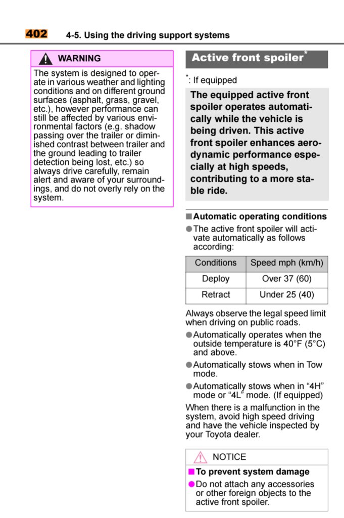

    I think the owners manual says it's for stability, not for mpgs.

    It’s based off of mph. I think it activates above 30 or 40 mph. I removed mine and kept the motor plugged in.

    Yes, like a supercar rear spoiler. It physically moves into place above something like 40mph. Retracts below 25. It's not visible unless you get underneath your truck.

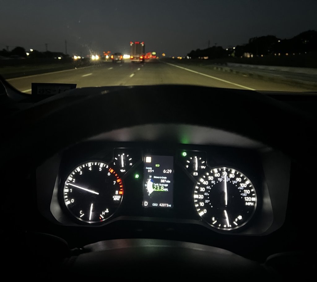

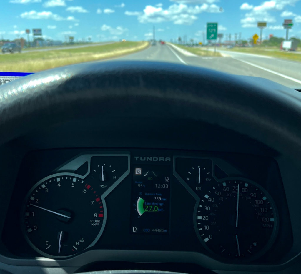

    I have wondered the same thing about the spoiler and here is what I found.
    When my spoiler was broken.
    Working spoiler.
    I mostly do highway so these numbers are definitely not normal and I usually hover around 70 mph just cruising and rolling with the grade. When the spoiler was broken I had a hard time getting to higher speeds, this could be a fluke but just my observation and the working spoiler lets me cruise easier.
    City driving is still around 18 - 21 mpg avg which I doubt will ever change unless I got lighter weight wheels and tires.
