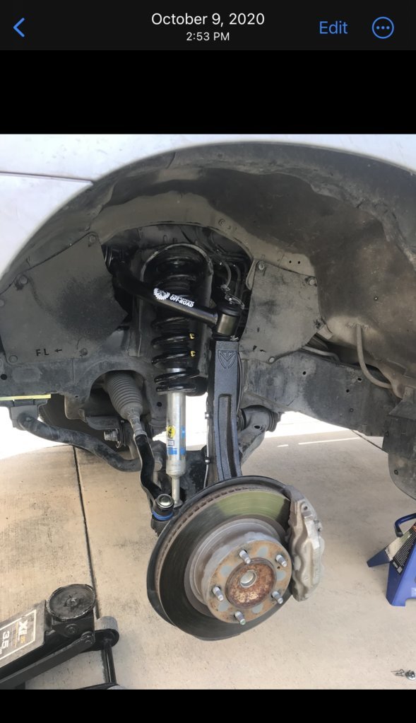

    Didn’t see too much info on these here, but want I did said they didn’t look beefy, wouldn’t hold up, hit the spring pockets, etc.
    Just wanted to put my $.02 in. These got here today (and are already on the truck lol) and package was great. I pulled them out and they were definitely beefy! Forgot to get a pic with a tape measure. I did have to gently pry them apart when putting them on. This actually turned out to be good because that was enough to hold them on when trying to put that 4ft bolt back in.
    Have a video too of moving them when they were mounted up. These do not hit the spring pockets at all. Must have fixed their design. I did see they had a silver colored model too, but I got the black ones. Even this design has been fixed. Honestly couldn’t be happier with them. We’ll see how they hold up!

    Got aligned today and was quite surprised at how much these helped!
    Only thing out of spec was toe, and just barely. Everything else was golden.

    For clarity, pics show the UCA’s with stock suspension. Have to swap UCA’s first then lift it. I’m lifted on Toytec BOSS coilovers, 2x CB shims on drivers side, 1x CB shim on pass side; 1.5” block in the rear.

    Correct, lifted, alignment was near spot on. They fixed the toe a few hundredths; everything else was green. Absolutely no rubbing of the control arms on the spring pocket, and not hitting the coilovers.
    Yeah I’d take it off road. They’re really beefy.
