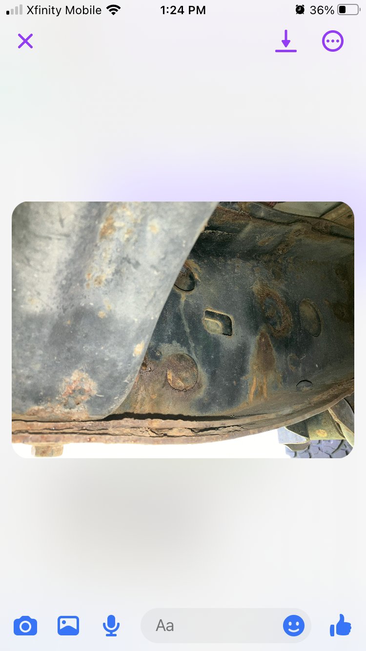

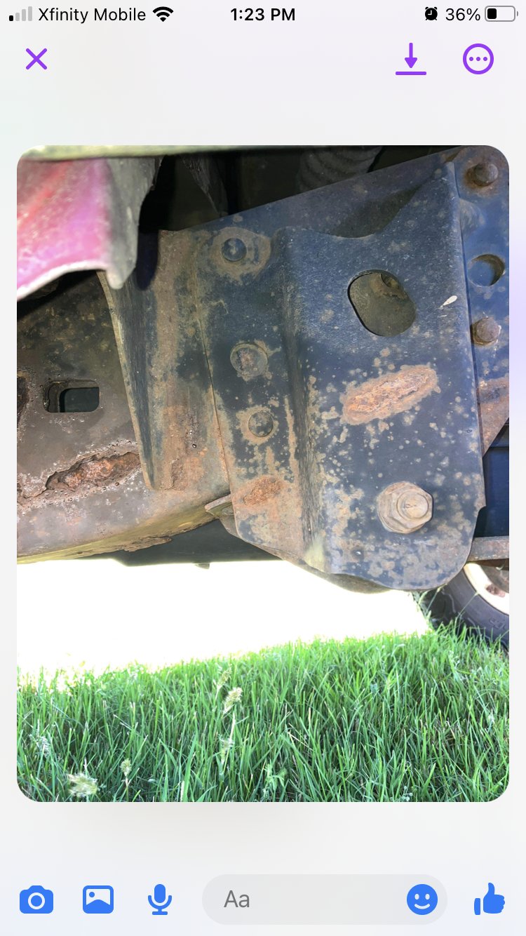

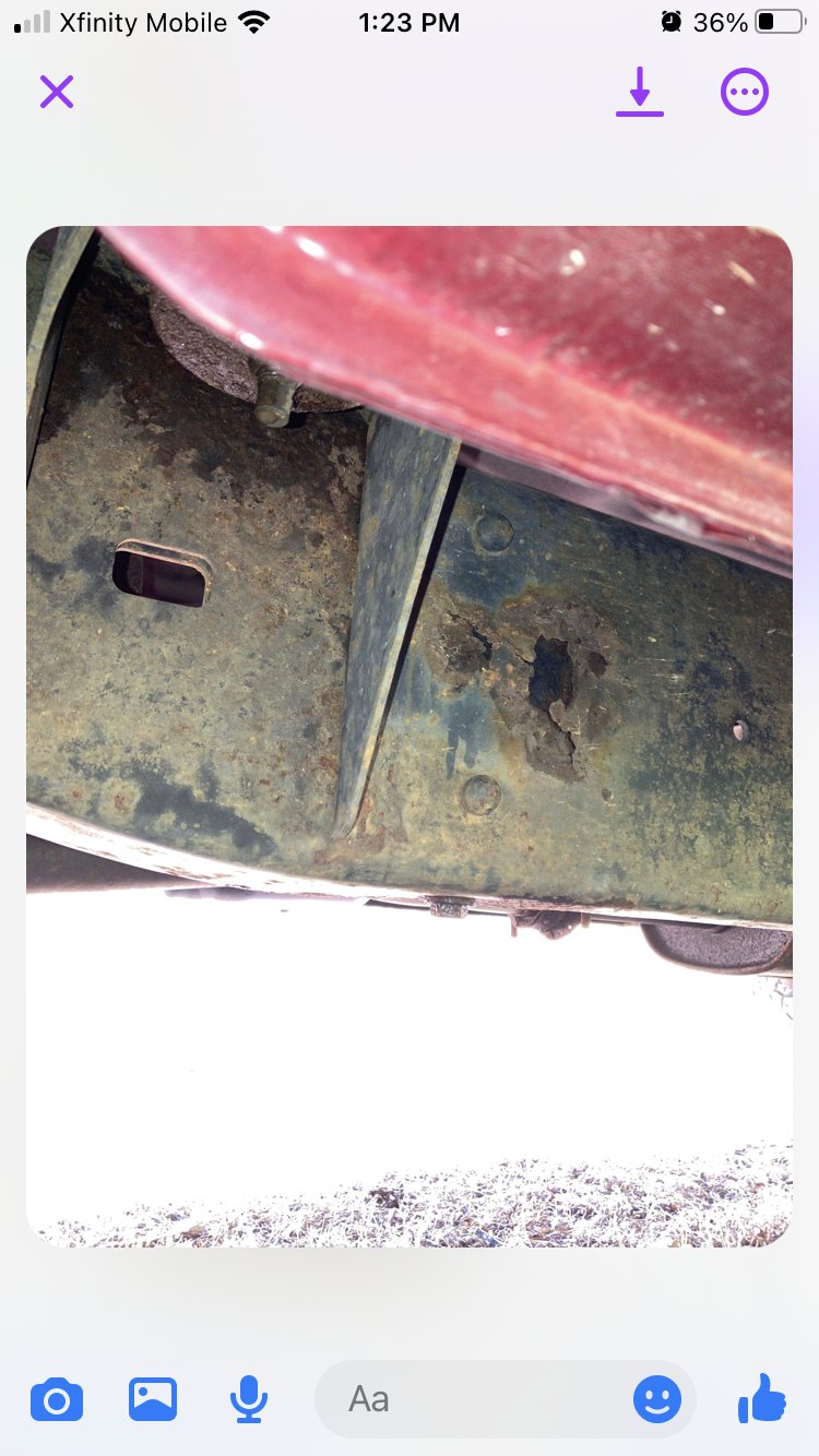

    Hey folks,
    looking at buying a first gen tundra after selling my gen 3 tacoma. I’ll be using primarily as a secondary vehicle for firewood/mulch/work. I’m lookin at this truck, 200k miles, recent timing belt/water pump, steering rack, new BFG ATs and cap for ~$6k.
    Im concerned about rust though. What’s your opinion on these pics? Too far gone or fine for a few years as a work truck? Seller says you can’t poke through anything with a ballpin hammer/icepick.
    Thanks in advance!
    —Weston

    Stop looking at it and run for the hills. Unless they’re giving it away for free, move on.

    That first picture says it all. Seller is lying or being optimistic. That's a $1000 truck at best

    Yea run from the one in the photos.
    Look down south or get detailed pics of the franes

    Run like hell! That frame is fucked!

    If everything else is perfect on that truck. $2k tops. If everything else is PERFECT
    That frame is fucked. Your paying for an engine and possibly hard to find parts lol

    Knowing any of those parts which are metal may be diminished value due to rust.
