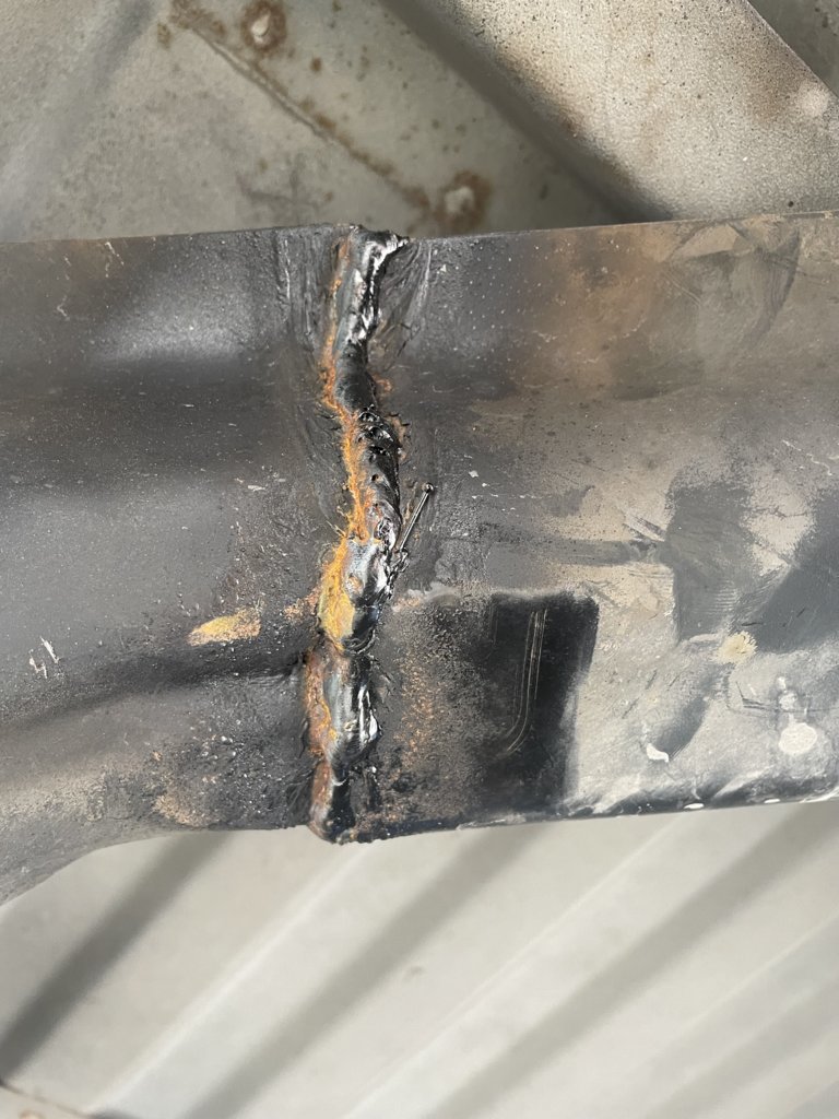

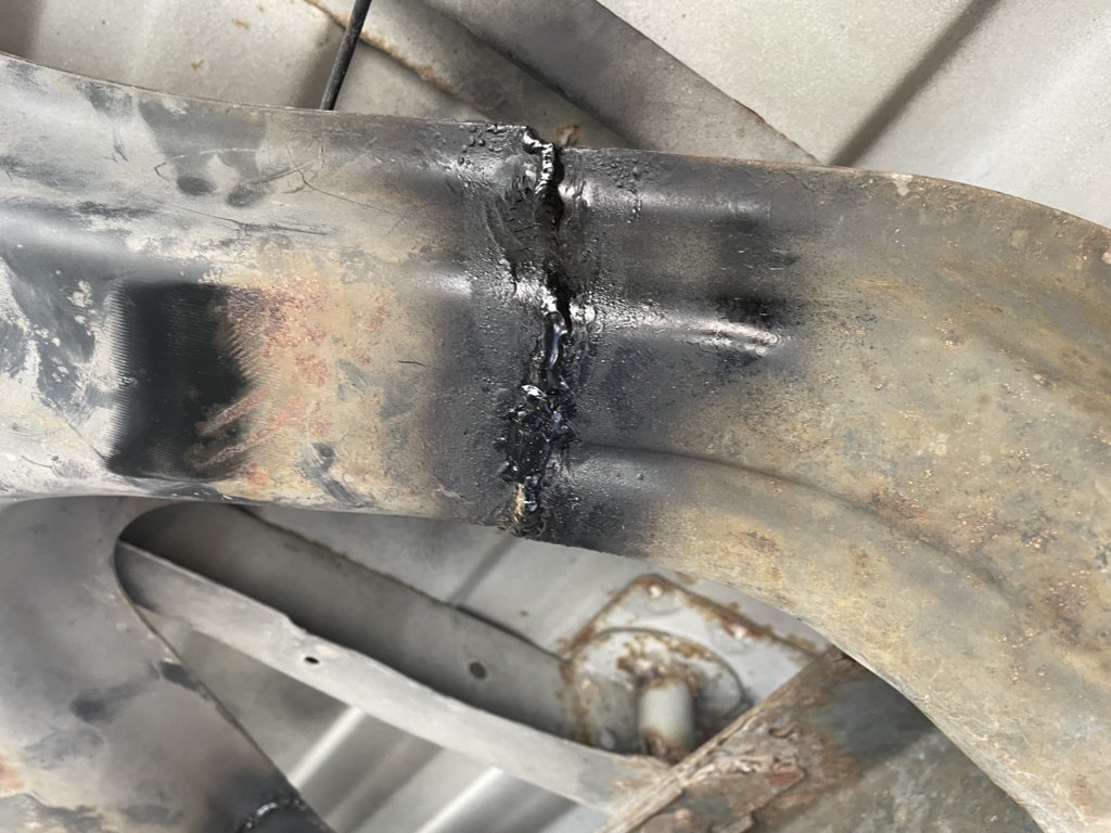

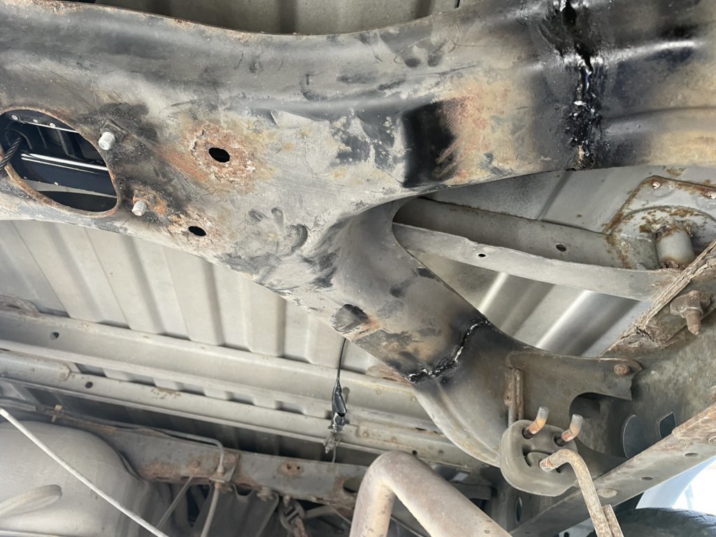

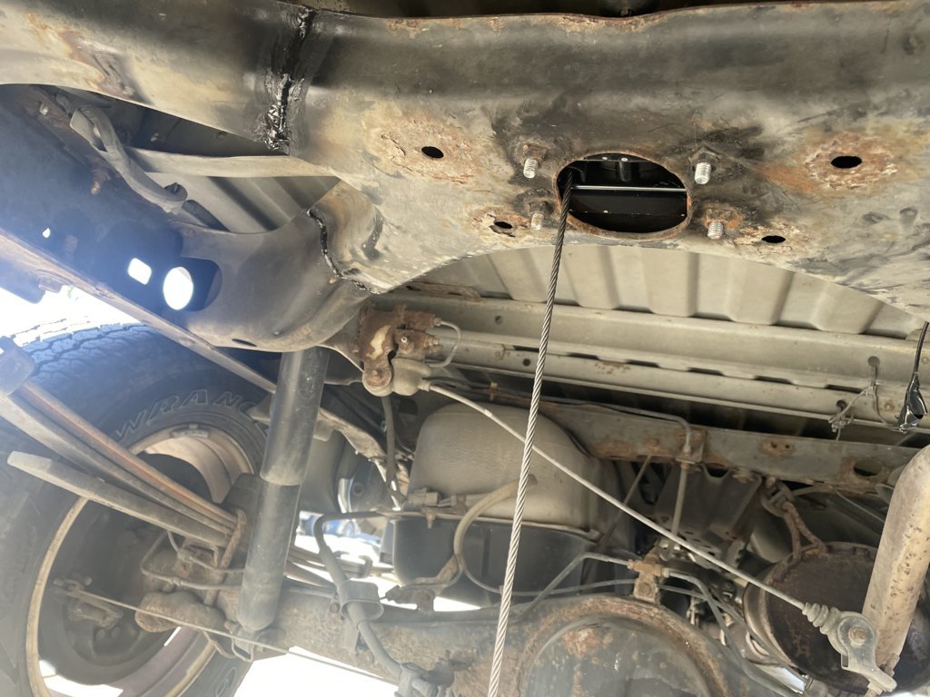

    I appreciate all your replies. So I finally went over every bit of the frame and dropped the spare completely. Luckily the majority of the frame seems fine apart from the shackle mount areas we talked about. Even the section below the AC drain is perfect. However the X crossmember above the spare does not look good, someone did a less than ideal repair. How dangerous is this? Do you think this entire cross member be replaced? Damn I wish I would’ve spotted this before buying it.

    It’s definitely regional how all of us would describe the frame differently. Over here in the PacNW, that frame would be considered a total rust bucket. We don’t salt our roads, so my 2000 tundra’s frame still looks almost new…as in actual zero point zero rust. That being said, i crawled under my friend’s 2005 Tacoma last week and his frame looks very similar to the rusty one that we’re discussing. Undoubtedly the truck must have come to the PacNW from out of state.

    Honestly i don’t have any problems with the weld job. It looks like it will outlast the other portions of the frame that are delaminating from rust. I would though wire wheel the black paint off of it and then start over with a rattle can primer then paint it.

    Oh yeah, nothing wrong there, right? A little welding and cover up in black paint and she’s as good as new. :rofl:

    Yeah I assumed when I first noticed it that it would be best to replace that entire crossmember. I don’t know much about welding or metalworking but I would think this comprises the strength of the member greatly?

    Well I’m no welder or structural engineer but I would guess under a lot of stress, the weld would crack where normally the metal would deform. I don’t know how much that member assists in carrying a bed payload. I would think it’s mostly for the spare and to keep the frame rails from twisting. Again, just a guess.

    Yeah my thought was it’s really mainly for the spare but of course it obviously provides support to frame as well. I’ll see what the guys at my shop think when they inspect it in person. Thanks for the insight. I’m really hoping if I address this, the spring mount areas that are delaminating, then wire brush/rust converter/epoxy my truck will be solid. Fingers crossed

    Whoever initially did the work is foolish. They should’ve scabbed plates over the repair line, so that single weld wasn’t the only thing holding it. IMO, at least, but IANAW, BTAL (i am not a welder, by trade at least)
