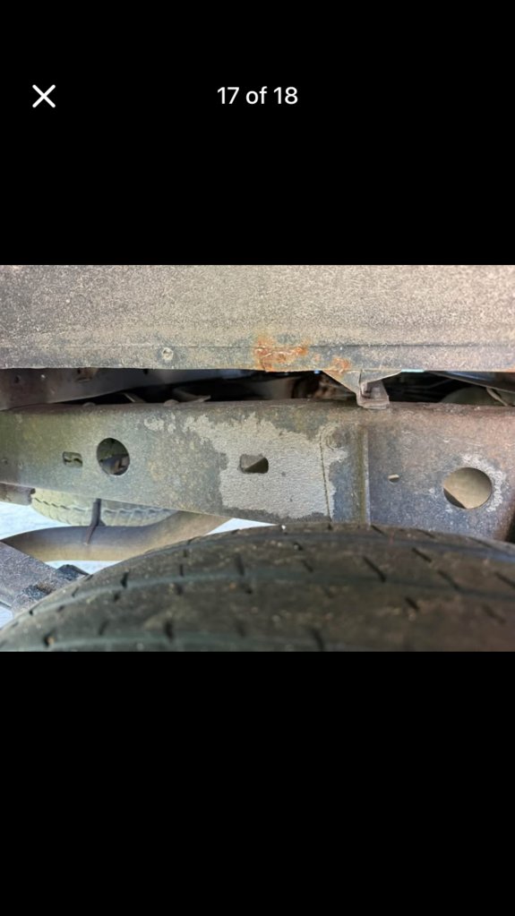

    I am going to look at a 2002 Tundra it’s a 1 owner truck. Should I be concerned with this rust on the frame and also what other things should I look for? It has the 4.7 with 170k.

    This specific pic is not promising.

    Agree with shifty. Run!

    Yeah, as I was scrolling through, that pic was the tipping point for me too.

    Ditto. It's a body mount, and right in front of the spring mount. I bet if you look on the inside of the frame at that location - which has the frame stiffener - it's in even worse shape. Bad spot to have that kind of rust.
