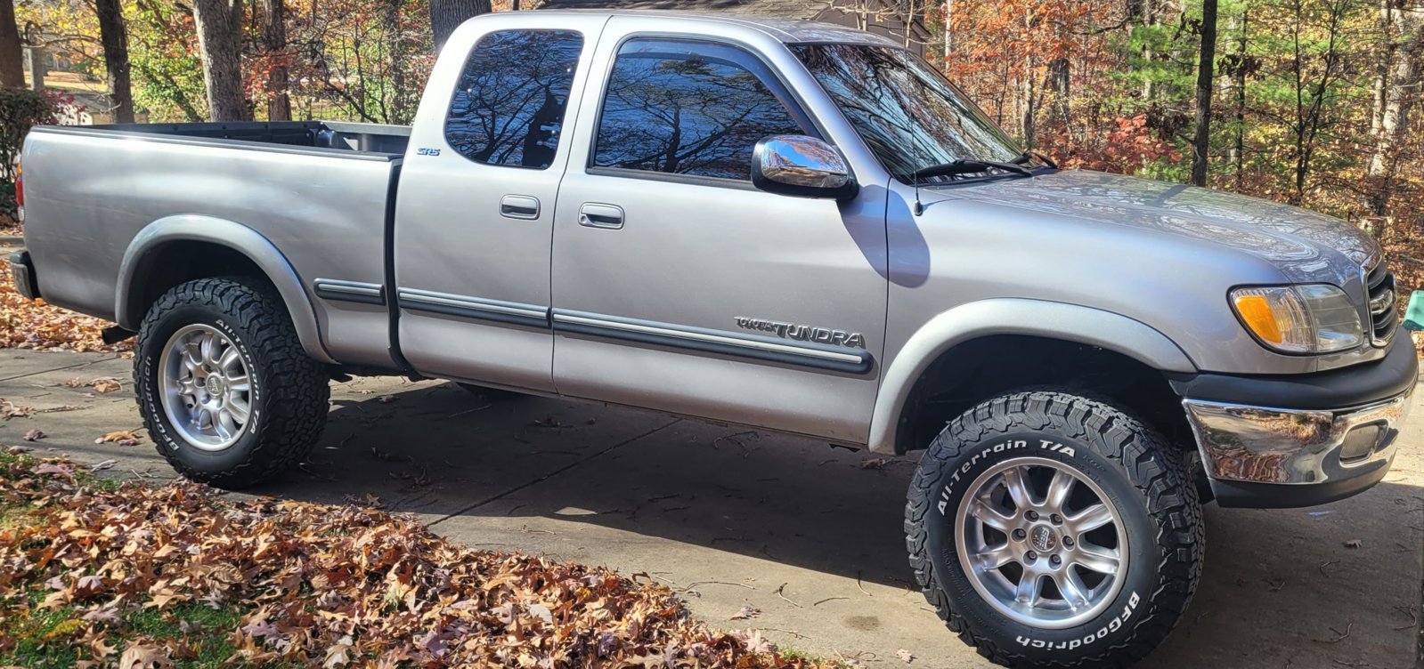

    Not too bad for its age! Thanks to everyone on the message board, the smart people and knowledge is awesome.

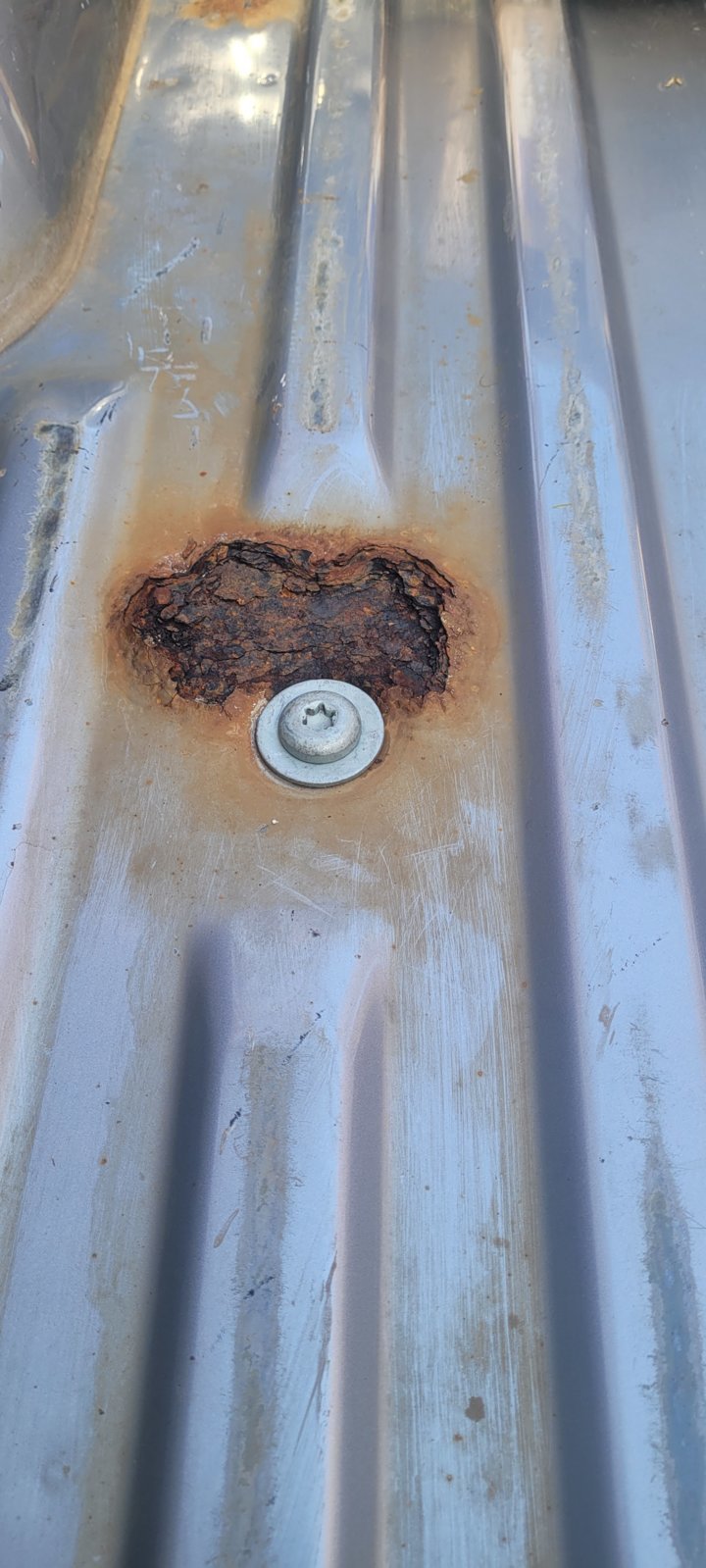

    Next project is dealing with the bed rust seen below. I was thinking of taking somewhere and sandblasting then applying ospho if needed but I am afraid the metal wont hold up to sandblasting. Also betting the bottom looks the same but really not wanting to pull the bed off to treat it with ospho. Input welcome, never dealt with something like this before but after a new frame and everything else I need to get ahead of whats left and there are spots by each bolt. Two like this and two less. Was hoping to treat then go have it sprayed.

    Jack McCarthy It’s always the fuel filter
    Nov 2, 2020
    #54409
    11,040
    Bill
    North of Boston
    02 Tundra AC SR5 V8 4x4
    Yeah, it’s pretty much shot. Rust originates from below and comes through the bed. Best to just cut out the cancer and weld in a blank panel or donor bed piece. I’ve got a handful of rust hole rot all over my bed.

    shifty`
    Jun 20, 2020
    #48239
    31,487
    ATL
    '06 AC Limited V8/4WD
    That steel is delaminating. You'll probably find it's delaminated at least a half inch up under the paint. Best bet is to find a truck with a wrecked ass-end, and cut some patch pieces out to be welded back in and sealed top and bottom after. Or swap the bed with a southern bed, but the outside looks so good it'd be a shame. If you have rust there, I bet you've got a gaggle under the fender flares too. EDIT: Little jinx action w/Bill there. Simultaneous posts with same thought. Great minds think alike :D

    The fenders were rough with part ate away on the bed.....those are aftermarket fender flairs a friend and I painted and installed. We sanded the rust to the metal, treated with ospho, then sprayed over that with some rust product that reminded me of undercoating (name escapes me) then installed the flairs. Maybe I just need to pull the bed, cut out the spots and replace/seal is about the best option since the paint and bed in general is in great shape.

    JasonC.
    JasonC. ¯\_(ツ)_/¯
    Jan 23, 2023
    #90779
    1,235
    TX
    2001 4x4 4.7L AC Limited 55k mi
    Get on car-part.com and find a front-end collision truck and buy its bed.
    tlkelley70[OP] likes this.
