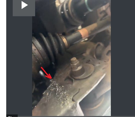

    https://vidmails.com/v/IJHpy3Iekr
    New video from the dealer. I'm concerned about the part at about 0:14 it looks pretty bubbly. Or maybe that's just the cv slinging grease? Spare tire cross member looks in good shape, spare tire itself looks like shit though. Do y'all see anything too concerning?

    Dude, the frame is pretty spotless.
    This is classic CV grease sling, from the boot. Notice it's perfectly in line with the edge of the seal edge, and in a straight line on the crossmember that also lines up with the edge of the boot. It's not too much sling either, and may've been a one-time event. Mine slung more after my 2" lift than I see here, like 3x more than what I see here:
    This is a fairly immaculate frame, it's totally shifty` approved.
