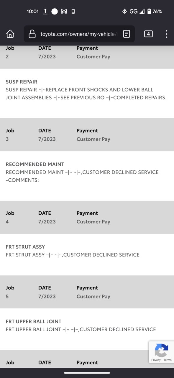

    I don't see frame work anywhere in the service records, and it says no open recalls in the recalls section. Is there somewhere else to look? They declined service on the front strut assembly but replaced the shock? Aren't struts and shocks the same thing?
    I did see the following in the service history. Can someone decode this for me?
    They declined service on the front strut assembly but replaced the shocks? Aren't those the same thing?
  23. Sep 26, 2023 at 7:26 AM
    #53
    shifty`
    Jun 20, 2020
    #48239
    31,487
    ATL
    '06 AC Limited V8/4WD
    "Strut" is colloquially reference to the entire assembly: Shock, coil, and buckets.
    I see upper balljoint referenced too. My guess is the stealership did the typical stealership thing and tried to upcharge in order to get work extra work out of the job. "Well, we're replacing the lower ball joint, may as well refresh the upper ball joint and strut assembly also, for a small upcharge of $2,500 just to be safe. Wouldn't feel great about you driving outta here knowing we replaced the lower balljoint but didn't replace anything else between the upper and lower control arms, because, well you know, you can't be too careful with your front suspension and steering and safety is our #1 priority!"
  24. Sep 26, 2023 at 7:27 AM

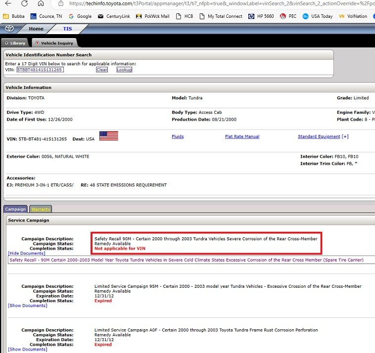

    The link BubbaW posted earlier goes to the listing.

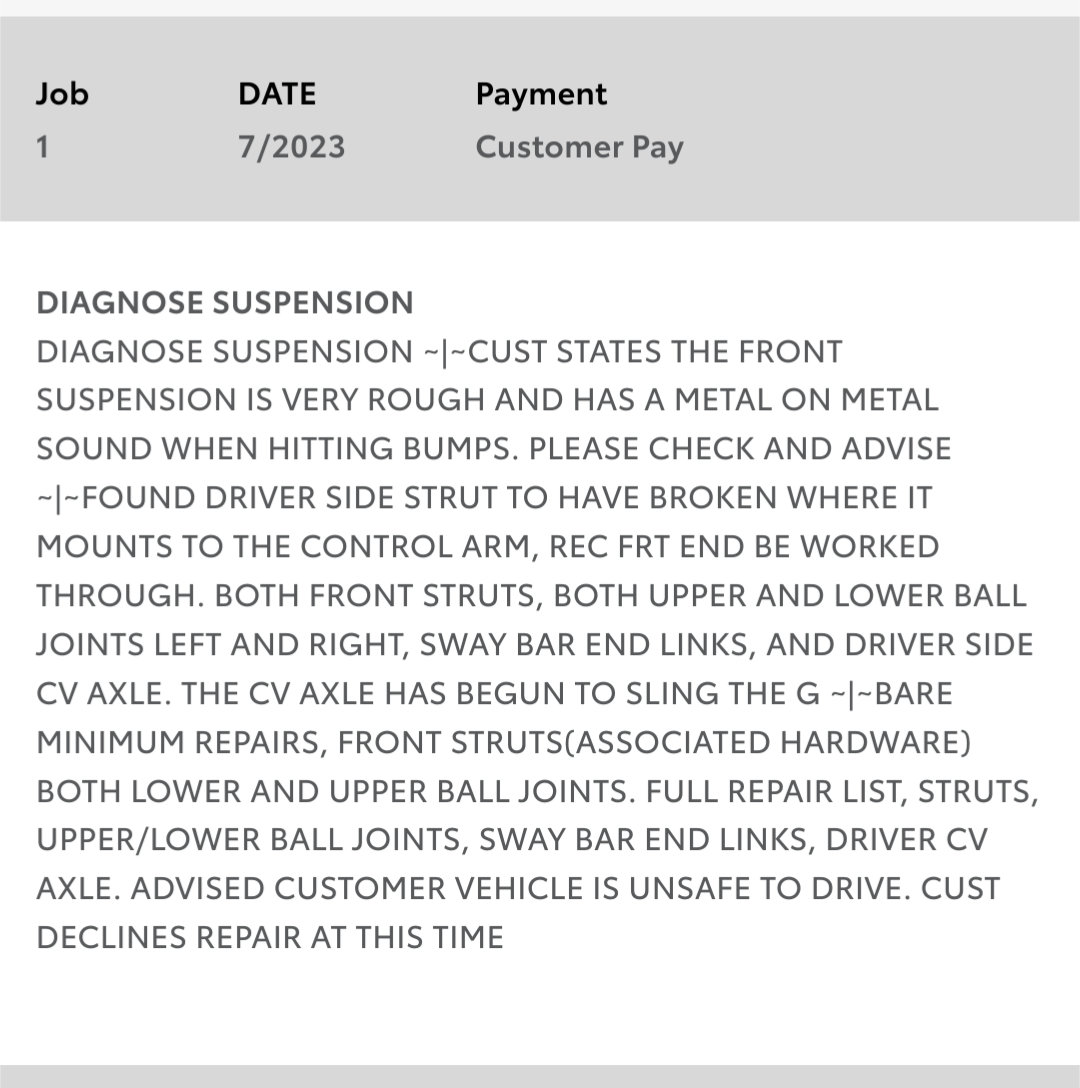

    I'll attach the initial list of problems below. Upper ball joints, sway bar end links, and driver cv axle. Are these expensive repairs? Toyota also doesn't list the timing belt in the service history. So I can use that to haggle them down hopefully.

    While the TIS record is not 100% conclusive IMHO, it shows Recall 90M was "Not applicable for VIN". Agree the frame looks very decent and not surprised it does not qualify if true.

    So it needed (needs) all that front end work, has a questionable timing belt and frame, and has a check engine light on. Awesome truck. Also want $10k for it with 240k miles on the clock. o_O

    Ah holy crap, I read that as "7/2007", I didn't realize it was 6 weeks ago.
    Yeah, that's a lot of stuff to do. Unless the price was right, I'd be passing on it too. I'd need to see whether 4WD works or not, and inspect the front-end myself to see what's wrong. Grease sling is often overstated. Metal on metal is probably a strut failure (probably on original struts) and a cheap fix most people can DIY. It could also be swaybar bushings or other things causing the clunk/metal on metal.
