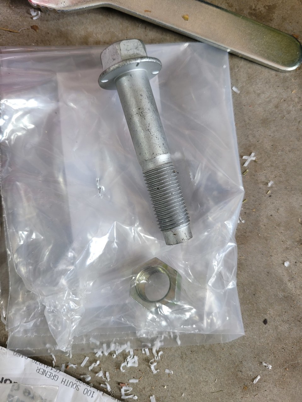

    I bought Home Depot 12mm washers, but, it turns out the bolts I took out were 12mm thread, the Toyota bolts are 14mm thread, so I had to go back an get 14mm washers. (And that means my truck was riding on too small bolts for how many years? :eek2:)
    I should have measured the length and thread length before I put them in, but here they are.
