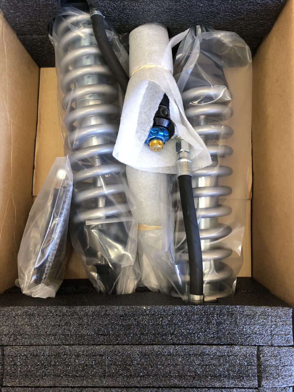

    Fronts showed up today and rears show up tomorrow! Super pumped B355BD50-8A64-40BB-8F1B-7D25F2B47BE7.jpg

    Start a build log!
