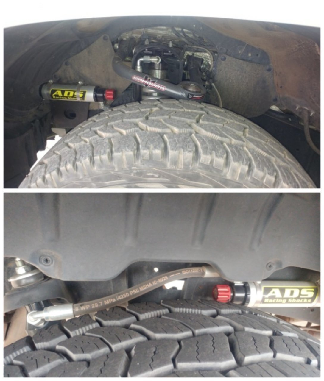

    @ADSracingshocks - F 3 point ohh / R 2.5 - w/clickers @camburgracing - uniball UCA @rigidindustries - 40" amber/white split, Dually XL, D2 @coopertires - 35/12.5/17 STT MAXX @bayareametalfab - low pro bed rack @toyotausa - 17" rock warrior @sdhqoffroad - rock sliders, a-pillar @hondogarage / @apple / @gaiagps / @dualgps- navigation @wheelersoffroadinc - superbumps
    Pic didnt load the first time.

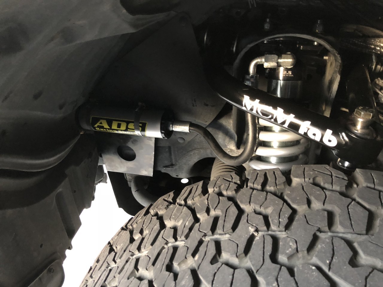

    Any reason for camburg over the mcm?

    I'm running an ADS/Deaver setup from MCM, and I'm about at a 3/1. Might be more like a 3/1.5-2 for a slight rake. It's top notch stuff.

    My fronts are 2.5's without adjusters, and I'm running a JBA UCA because I wanted an enclosed ball joint. If I was going with a uniball, I would go with MCM. I've never heard of anyone having any type of alignment trouble with his UCA's.

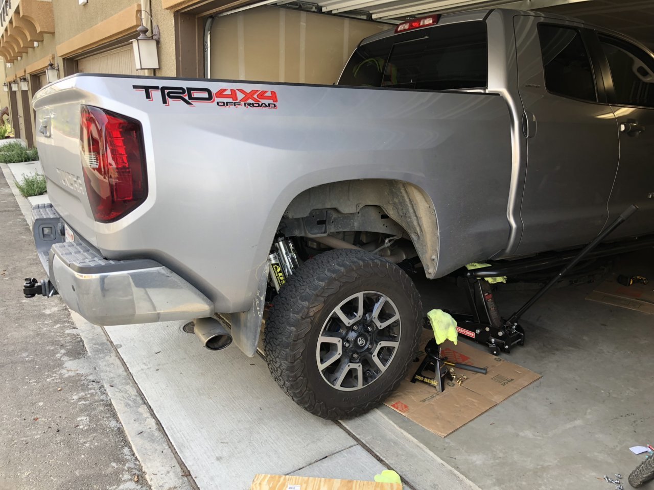

    I’m running Matt’s ADS/Deaver mid-travel setup. 2.5” coilover up front and 2.5” extended length triple bypasses with Deaver U748 springs in the rear. I do have TC heim joint UCA’s though. I wanted more alignment adjustability.
    It’s a great setup, I highly recommend it.

    Wow those rear shocks look so crazy. I've read about the jba arms. I like the fact that they have a ball joint that could be picked up at any parts house. That being said I've read they have limited travel compared to the uniball?

    I also have uniball UCA with 70k on them and they never make noise. I rarely add lubricant to them either. So the noisy uniball story II have yet to figure out. I do live in the desert but never wash my truck.
