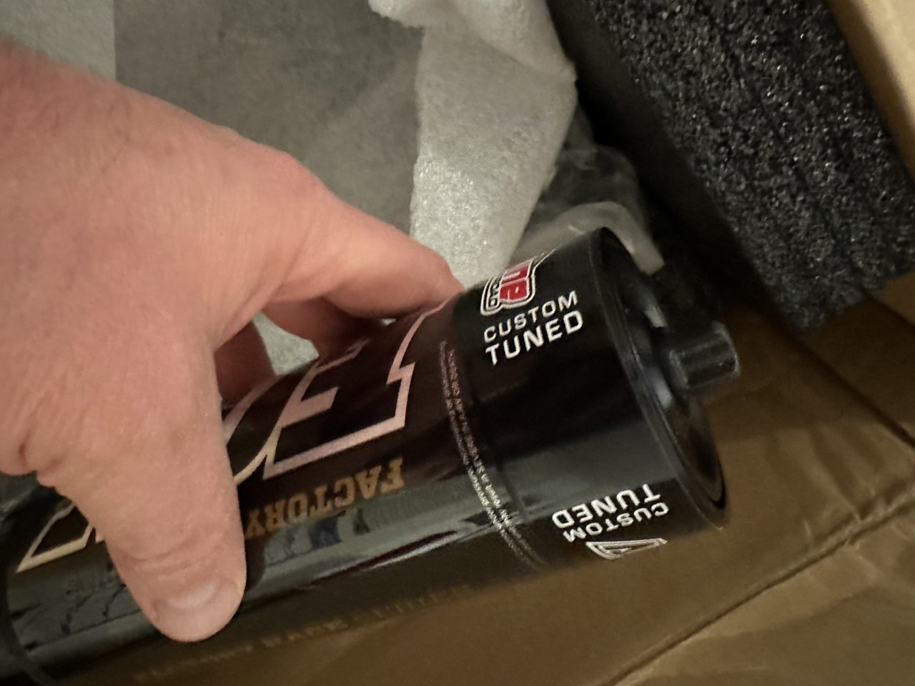

    Anyone know what the knob on the opposite side of the res from the DSC adjusters are for?

    Is that a cap protection on the fill valve

    Its a cap to protect the nitrogen fill stem. Basically a tire stem valve. You can take it off to look but DO NOT deflate!
    I actually need to check my level and do a rebuild. I have the same FOX DSC.

    Yeah, you don't want to play with that. It's basically a cover to protect the Schrader valve underneath. The high pressure nitrogen will evacuate almost instantly if anyone presses the center of the valve or tries to put a regular pressure gauge on it.

    Looks to be a defect. Ill take em off your hands...lol.

    Thanks!! I will not touch but only to ensure the cap is tight once in awhile.
    Yeah, this is the “defect” I will be holding onto
