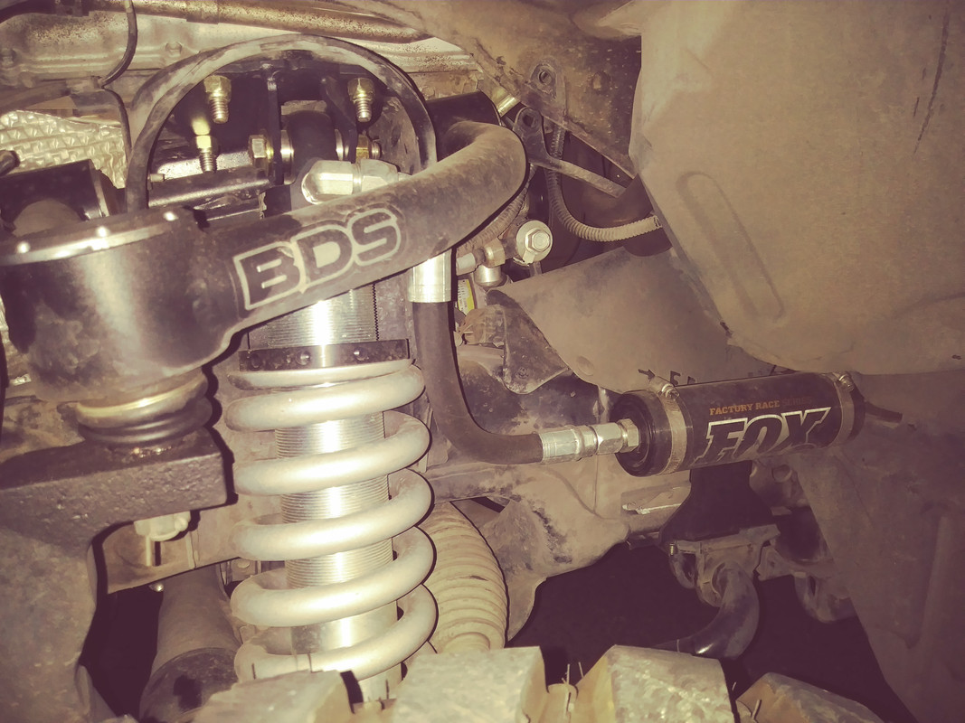

    Mine is the same way on my 07. A lot of thread left, but it s level the way it sits now. I could raise up the front higher than the rear. Thats the trend for the youngsters although it s kind of hokey.
