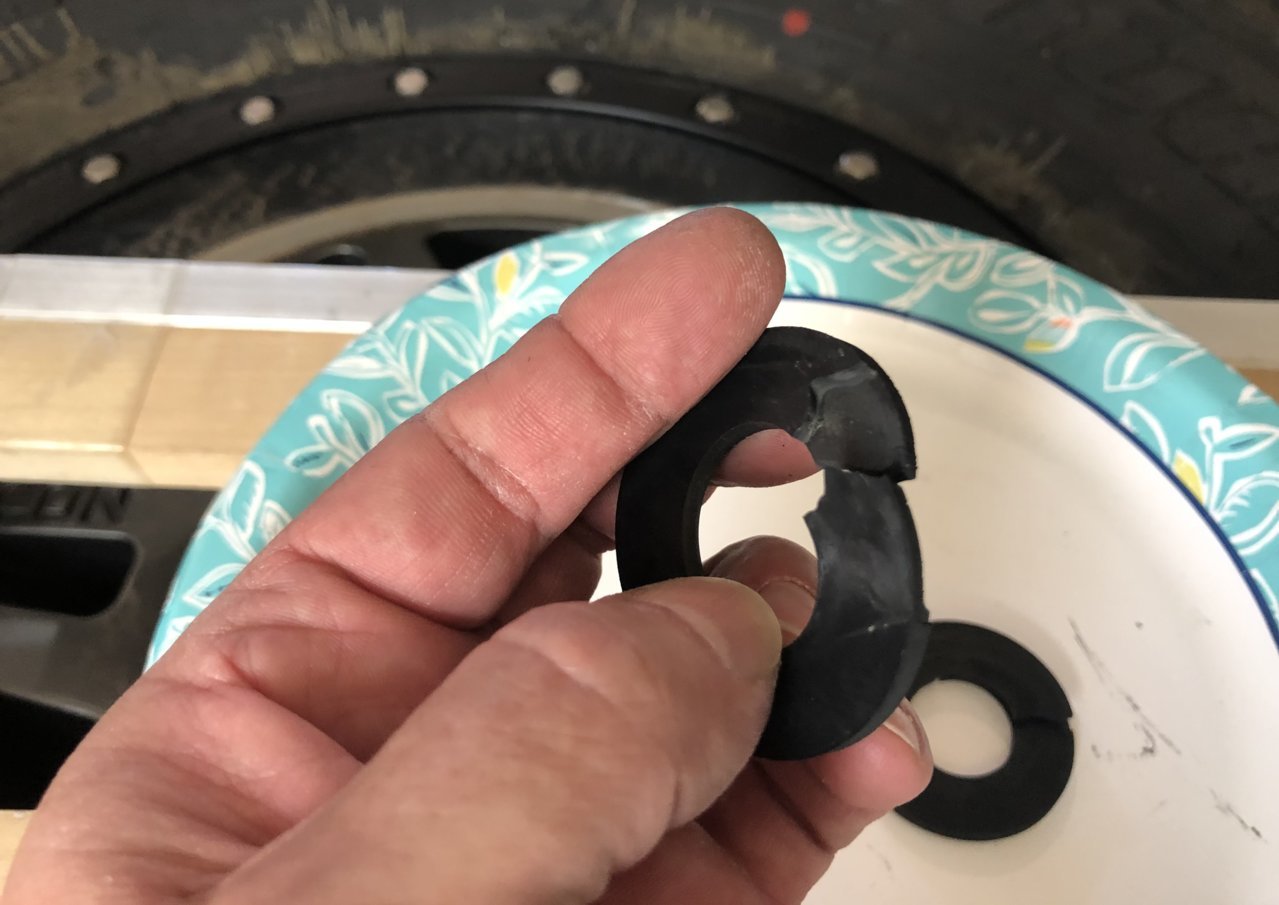

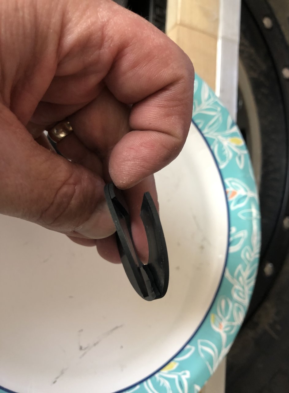

    Had a noise that sounded similar to what you are hearing with a new Fox coilover, super annoying. Found what it was when upgraded suspension, there are 2 rubberish washers in the top mount where the shock attaches to the top hat and they came apart. Still in place, just broken allowing the shock and hat to contact metal to metal and make noise. Maybe give them a look if nothing else works out.

    Thanks for that. I'm going to go over everything one more time when I get it back from alignment. If all else fails ill pull them and see
