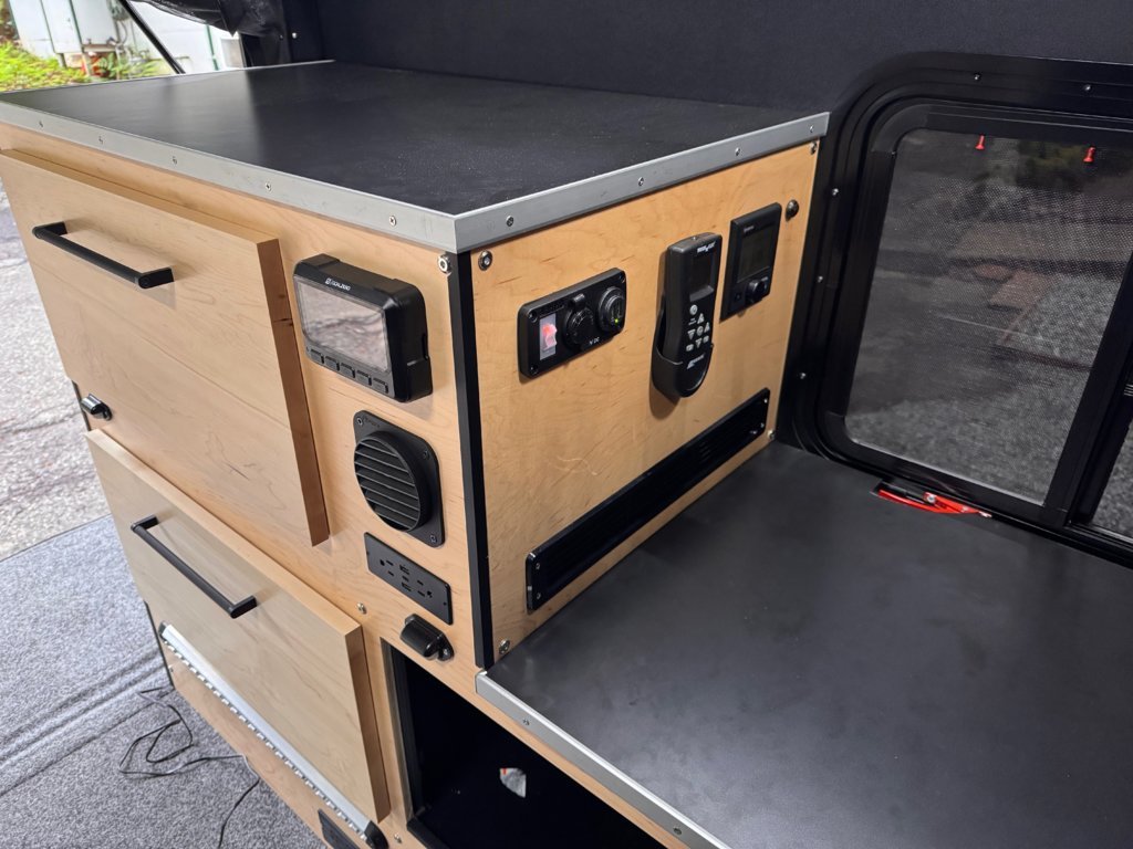

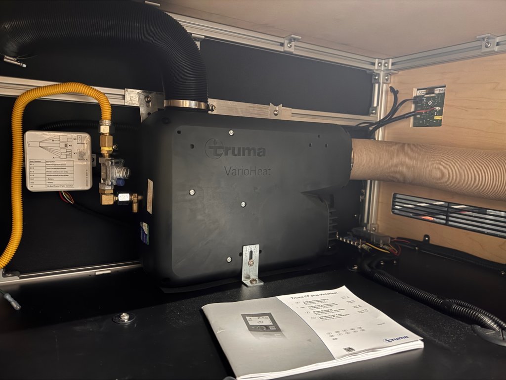

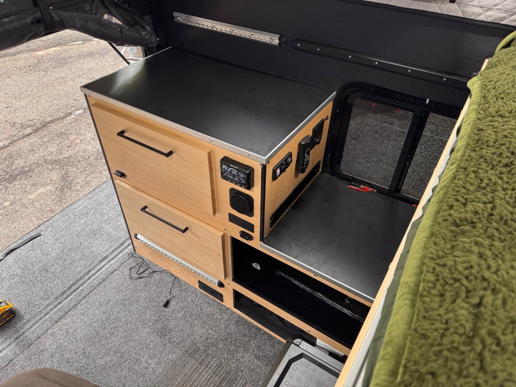

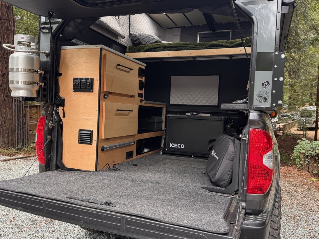

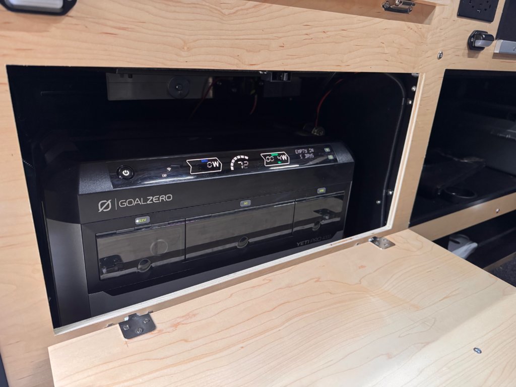

    I have finally finished my Project M cabinet—well, half of it, at least! I'm so happy with how it turned out, although it was a lot more work than I expected though. It's made of a 1" aluminum extrusion frame, 1/2" maple plywood, Formica countertops on 3/4" MDF. I used Prospect Overland's video as an initial guide for the frame. Then did my own thing and made it up the design from there.
    This side houses a Truma Varioheat Eco heater that runs off a 10lb propane tank on the back, as well as the Goal Zero, which powers the whole setup with a few fuse buses throughout. Using the Goal Zero external display for the power allowed me to completely close in the main unit and still control it.
    I plan to build the other side this spring, but it should be simpler. Just more of a low, bench height cubby with a few drawers and no electronics or heater.
