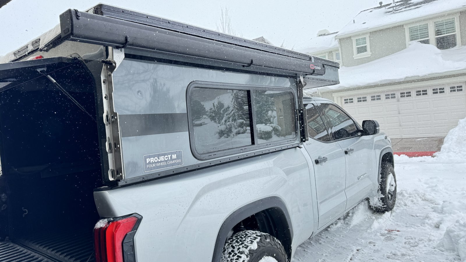

    just got back from picking her up in montana. I made it back before this EPIC storm his us in reno and all of the west coast.

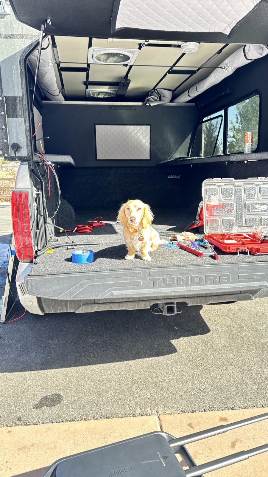

    so this will only pertain to those who want to get dual fans in the 6.5 ( long bed) config. I opted for dual fans, and I thought I had enough clearance to fit a 400-500 ish watt solar panel in the middle. you can only fit a width of 36.5 inches (safety) wide and that is if you have the OEM/factory tracks on the roof. I ordered a 300 watt single cell that will fit. since this is a 2024 model, from what i was told they have changed a few things., there is a SAE plug on the external aft of the topper, this allows you to plug in a solar panel MC4 to SAE into the camper in which you can use foldable solar or any other solar panels to get that extra juice which is COOL!. I have the rest of the supplies, fridge, sink, awning to install, gonna be a while since we got HAMMERED . I will prob do a video showing it all off since the community is super small and there isn't a TON of solar videos with these toppers.

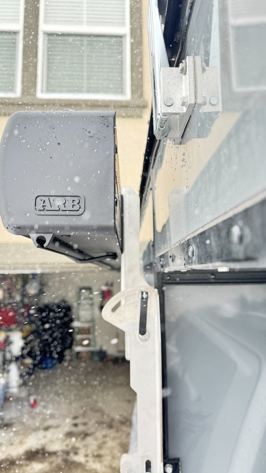

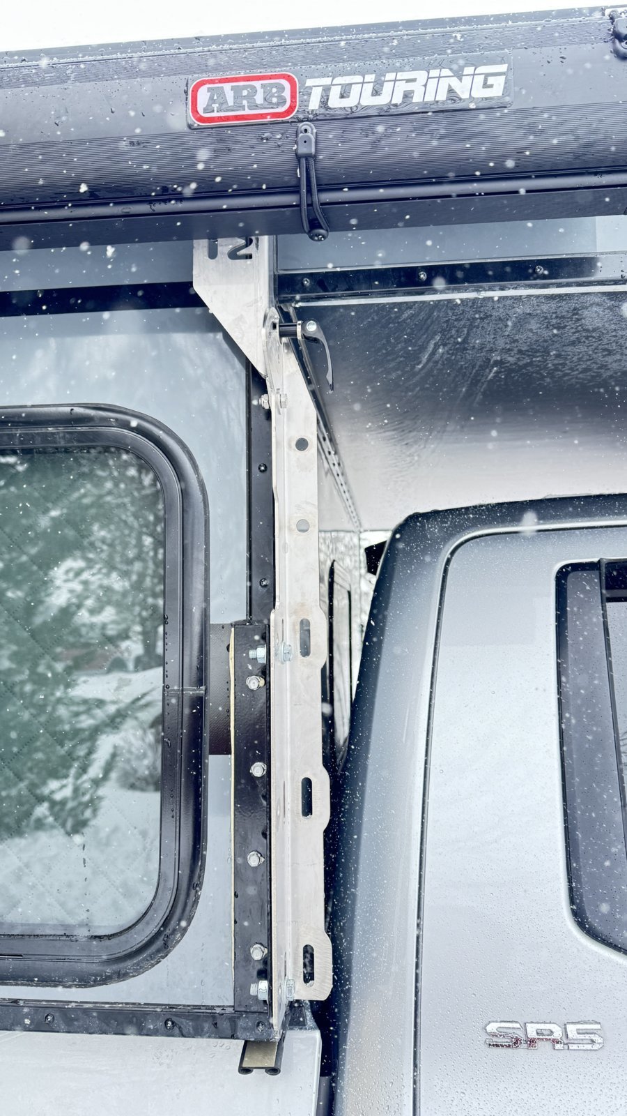

    Also, can confirm that these brackets work on the project m . When I was in Mt the dealer told me they just came out with their own brackets for the FWC project m and all models. Didn’t know about that option. But these dasmule ones looks SOLID, well build, all stainless . And thanks to @memario1214 for THE SWEET arb awning.
    https://dasmule.com/collections/all/products/mule-four-wheel-camper-arb-awning-brackets-pre_order

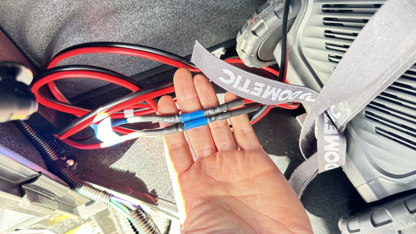

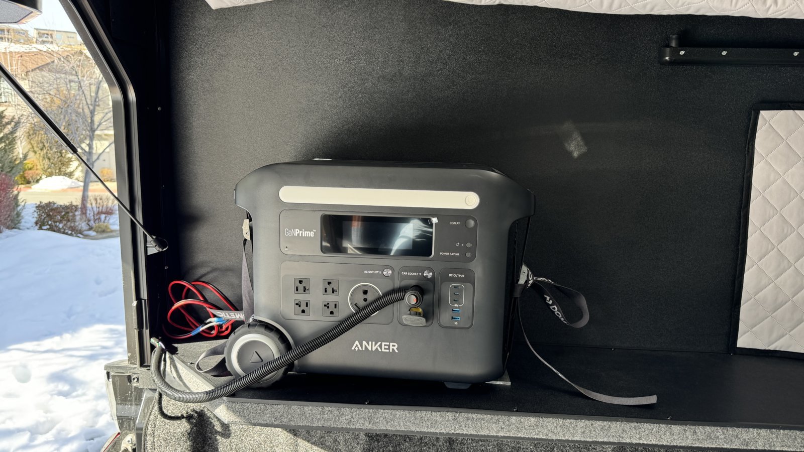

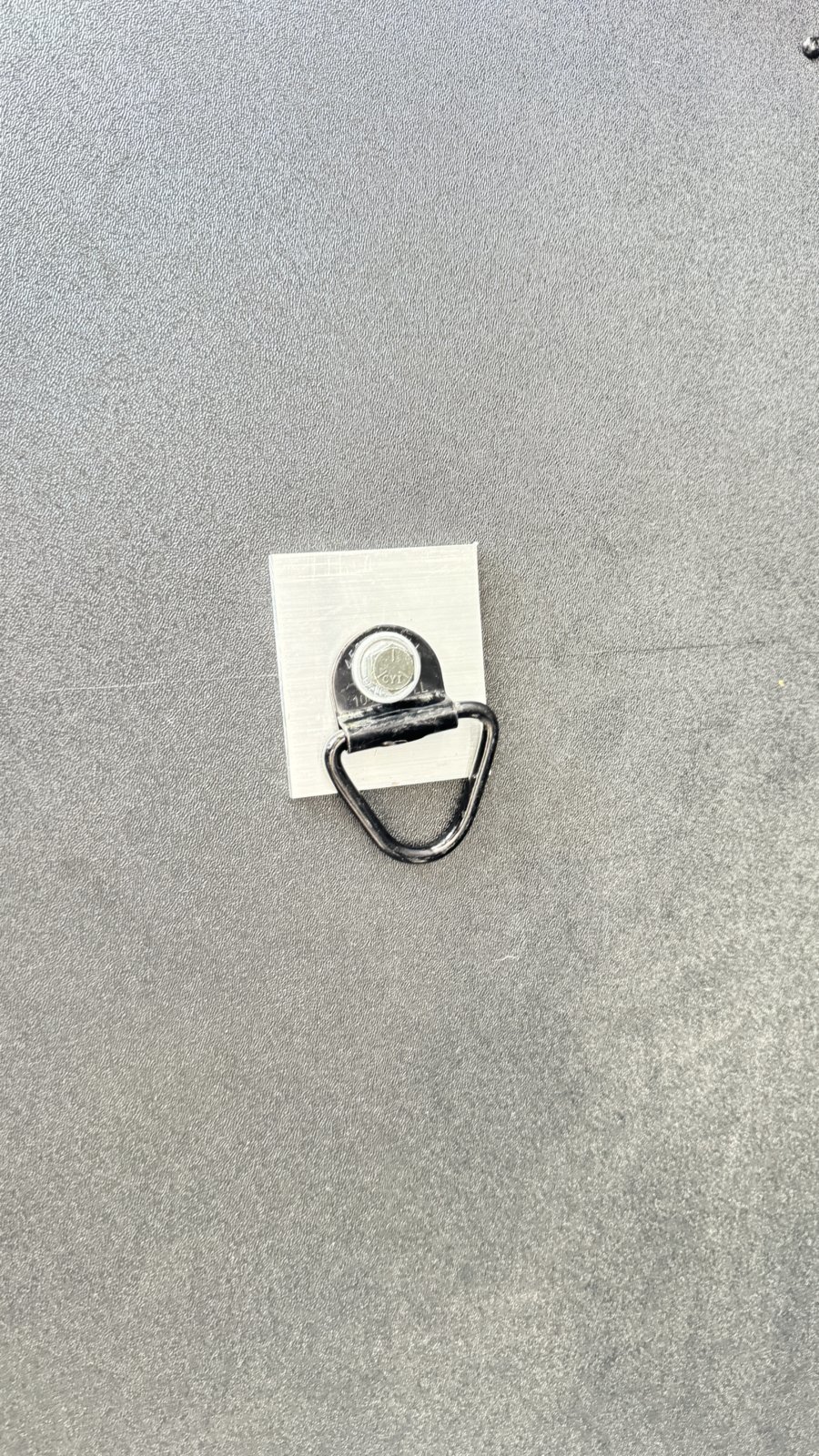

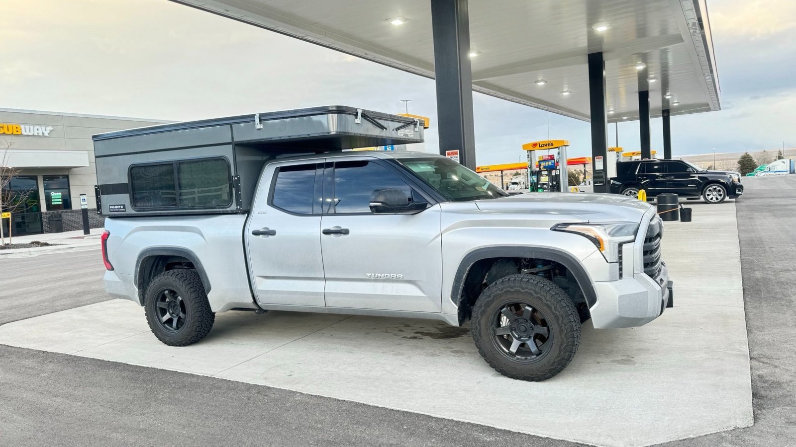

    Picked up some tie down rings locally. Use the existing bolts where it mounts to the bed rails. Wired up my solar. Will have to come back later with 6-8g butt connectors to splice in the external saw plug into the solar line. Wired up the anker f2600 (big beast! ) and tested it all with a Renogy 100watt panel. Waiting on my 350 panel to hard mount to the roof between the dual fans.had my little helper out there too.

    300 watt panel came today. Measured it, drilled some holes and installed baby l brackets . Mounted it to the roof tracks. Cloudy and overcast so not getting great watts atm. I also wired the external saw plug . Cant wait to try this out soon.

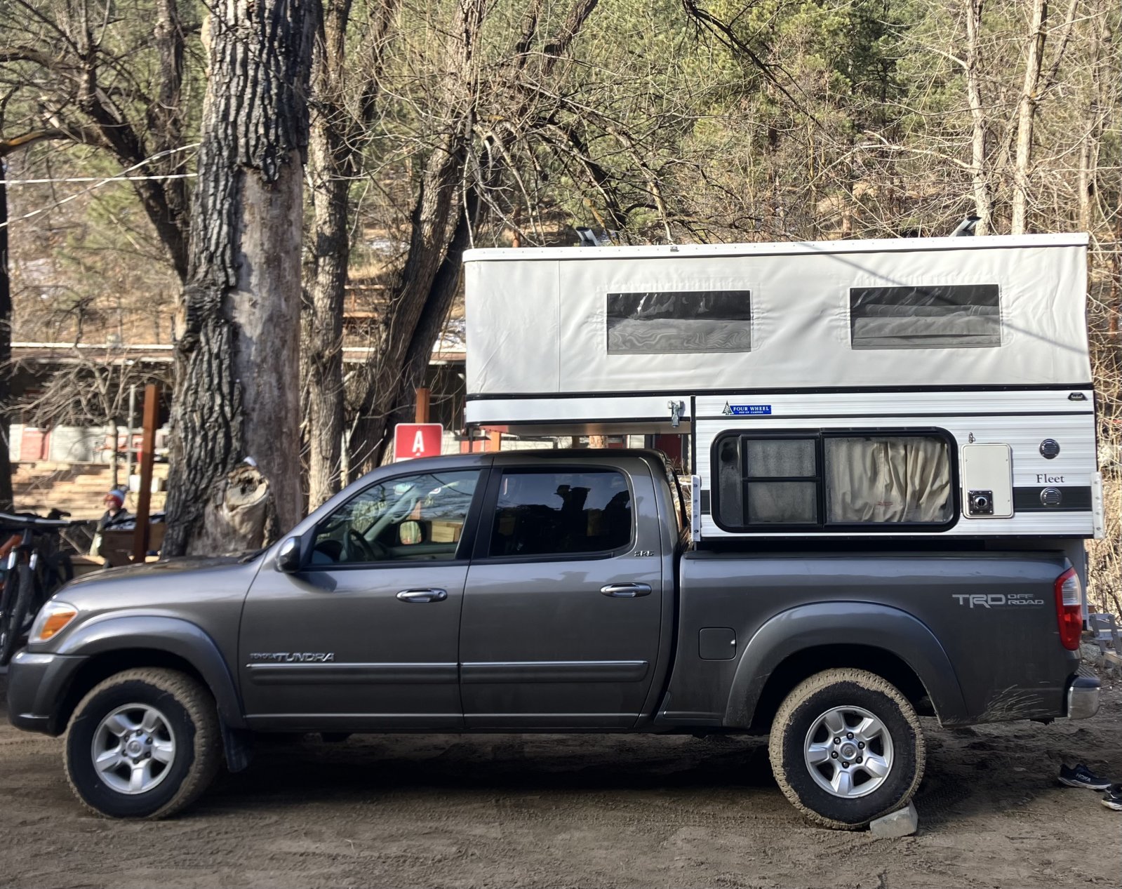

    Hi I just got a 2005 Tundra then found a FWC fleet shortly afterward. All I’ve done suspension wise is airbags so far. Im on D-rated tires near the max 50psi and 50 psi in the airbags. The factory shocks/struts have about 100k on them and I’m assuming the leaf pack is original so nearly 200k. There’s a little more shimmy and body lean than I’d like with the camper on. It’s not as bad as I’d expected considering 1k pound ish camper, but what are the steps to improve it? upgrade shocks/struts? E-rated tires? new springs and add a leaf? new everything?
    Im coming from a 2nd gen tacoma TRD off road where the factory leafs are garbage ( upgraded to Icon rxt) and the lifespan of the stock Bilsteins is maybe 40k and not sure what to expect with the Tundra.
