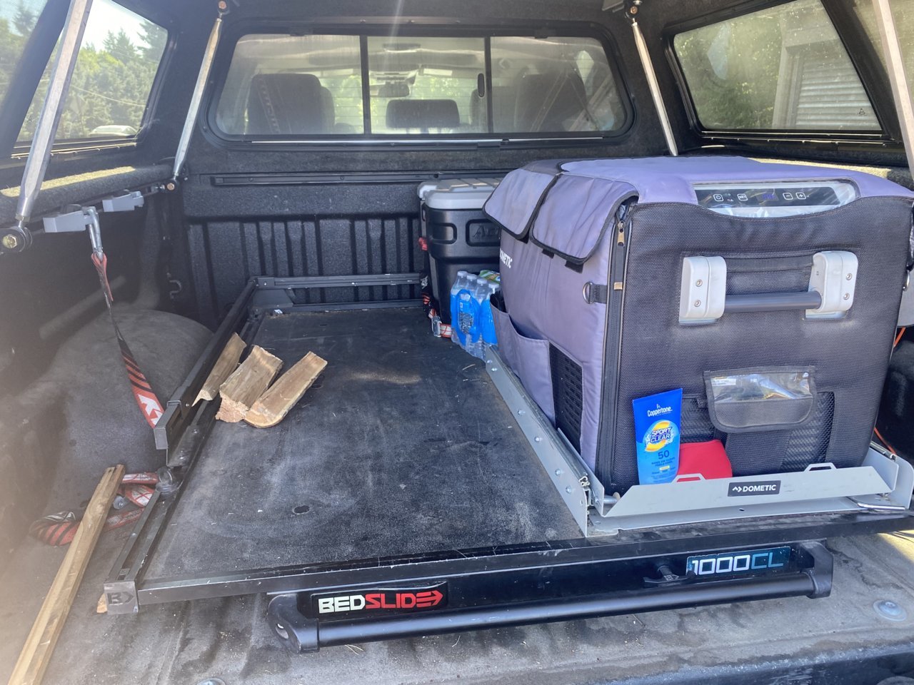

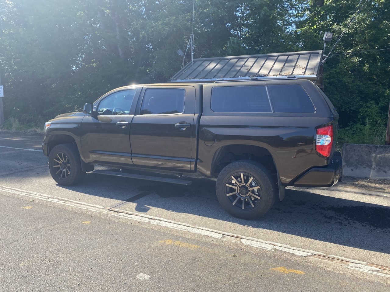

    This is my truck today, without the trailer and as loaded every single day. Pretty basic.
    In the bed is a Bedslide, a 50L Dometic with a case of beer and a case of water. The tote in front of it has some basic safety gear, no more than 50# loaded.
    This truck, WITHOUT any passengers is 3600# front axle and 3350# rear axle. 6,950# total. I weigh 235#…. So. With me in the truck, I’m pretty much “maxed out”.
    Added gear that bumped me up:
    Heavier tires and wheels.
    Heavier brakes.
    Heavier suspension.
    Dual batteries.
    Bedslide.
    Fridge.
    Tote.
    Canopy.
    Line-X.
    Amp Research steps.
    ARB dual compressor.
    A light bar.
    RCI aluminum skid plates for engine, trans, and cats.
    A sub box with a pair of 8’s.
    Floor mats???
    Dust on motor.
    WTF???

    Is that reinforcement system on your topper something you built yourself?

    It is. Prior to the travel trailer, I used a roof top tent. Since the canopy isn’t technically rated for added load, I added the struts to spread the load from the roof to the bedsides.
    1” aluminum hex bar stock in the lathe made it quick. We had a pile of 1/2” heim joints from other projects, so we burned those up. I attached the Zuni-Strut to the ceiling using the bolts that’s go through the roof rails.
    I don’t need it anymore, so I could shave 10# off this piggy! Lol.
