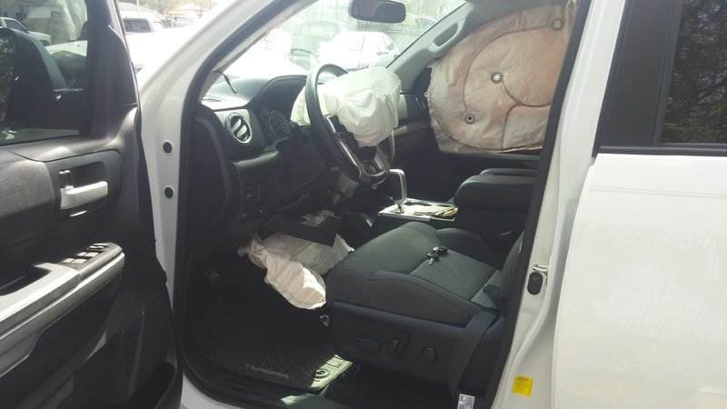

    Yep it has the SRS Curtain Air Bag logo just above the grab handle.
    Passenger side air bag deployment shows its not affected by grab handle.
