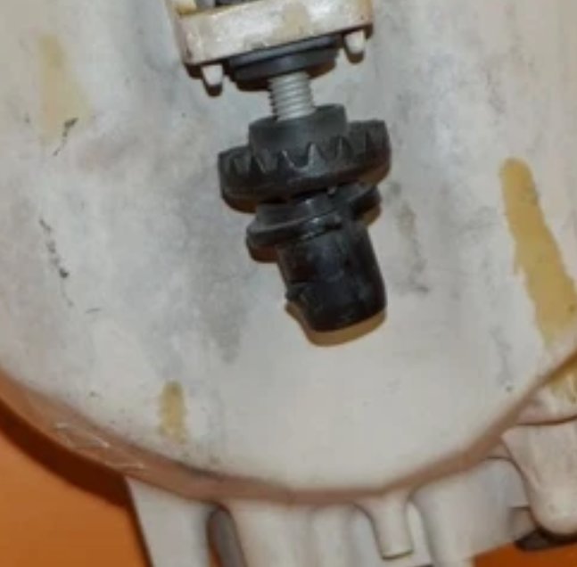

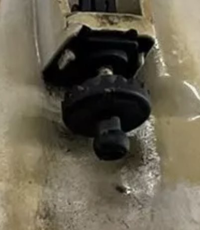

    The relay for mine was on the rear of the fuse box by the drivers knee. Mine was also already there, which was unexpected. That's on a 2006 DC SR5, with the tow package. I did not have to mess with any fuses or relays in the engine bay. It was basically a matter of getting the correct muti-function switch, then getting the right fog lights. 15 minutes installation and done.
    One thing I discovered is that the DC needs Sequoia fog lights. Both AC/RC Tundra and Sequoia lights will 'fit', but on the DC, the hole that the adjustment knob goes through is of a larger diameter than the AC/RC, so the lights will flop around a little.
    Added pics to show the difference.
