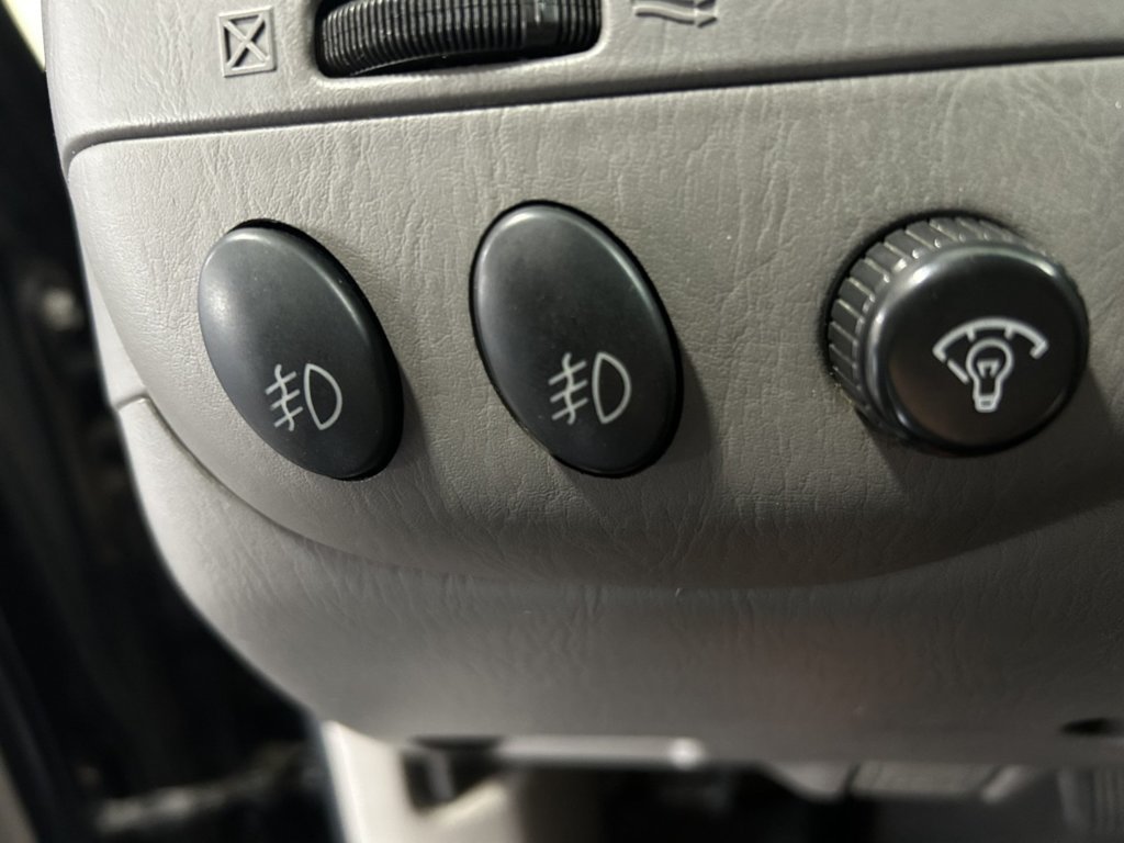

    I purchased the for the lights but now I am wondering, do you guys know if I can use an additional original fog light switch from another truck, and wire it to the empty slot on my knee panel.
    I read on this forum that the switch part number is 84160-0C010.

    Thank you. I think I just needed a point in the right direction. I think @The Black Mamba has the same setup I want to get done with the two oe switches. I’ll look into that.

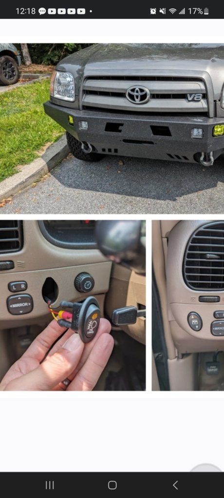

    I used regular 3 pos switch as the fog light switch would need to be modified to be able to use your adfitional light w hi beams.

    In addition to that, see this helpful post showing the pictures of what/where everything you need is on the '00-02 trucks @247Guerrero : https://www.tundras.com/threads/fog...unction-switch-installed.150125/#post-3748701
    Basically you need the foglight housings, a switch in the dash (your harness is plugged into the back of your blank plate), and a relay to plug into the location @BluegrapeVr6 shows in that reply.
    For any future readers catching this, if you have a 2003+ the switch moved to the blinker stalk on your year. You'll need to upgrade the stalk. I've posted the part number a few times on here, but I can pull it again if you can't find it. Other than that, you should also be pre-wired and it should be the same process (generally speaking, though there are small differences for fuse & relay locations through the years and diff't cab types)
