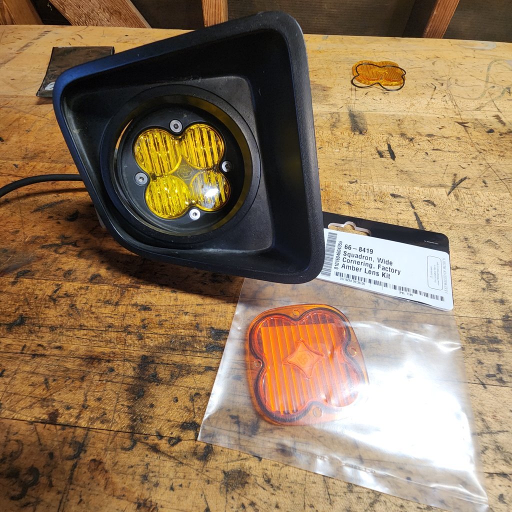

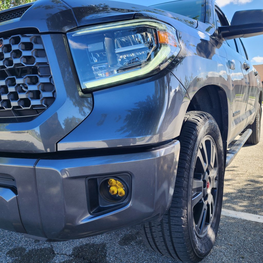

    Baja Design Squadron Sports with factory housing and zip ties. No issues.
    I like that the lens are interchangable. Changed mine from Baja Amber to Factory Amber to match my grille lights

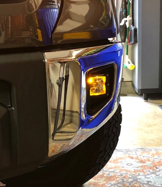

    I'll preface this with I really don't use my fog lights much.
    I can't stand drivers that leave theirs on all the time.

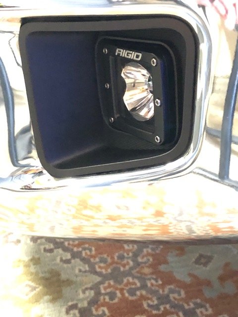

    After trying Rigid's crappy brackets on my 2014, I did this mod.
    You can run about any Rigid D-series..
    They won't shake or move at all.
    Looks great using OEM TRD Pro bezels.
    DIY RIGID TRD PRO Fog Lights Brackets | Toyota Tundra Forum

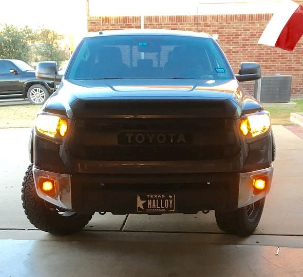

    I've tried a few D-series fog lights; amber, SAE, and now LED pods.
    I didn't care for the amber after a few months.
    With the SAE I kept getting high beam flashes from oncoming drivers.
    Granted my LED pod fogs are more for show than function, but it's not an issue since I rarely use the actual 'fog light' anyway..

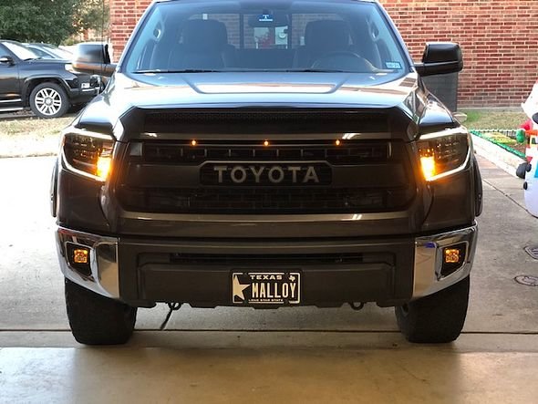

    The amber, I don't have a pic of the SAE.
    The LED pods have LEDs in the corners that come on with my parking lights.
    The actual fog lights are bright with a wider beam than the headlights, but nothing special.
    29f6317e-8d30-47df-ad54-c03c88e8edc4_9a32528175e58e482d38c7c0eccabceabc1fc207.png9a252798-81ea-4c1a-84c9-b556ba9436bb_be6060371329f5e0e45359e69417952f1b3d3b0e.png

    The new "Factory Amber" Lens looks so good. Clean Install!

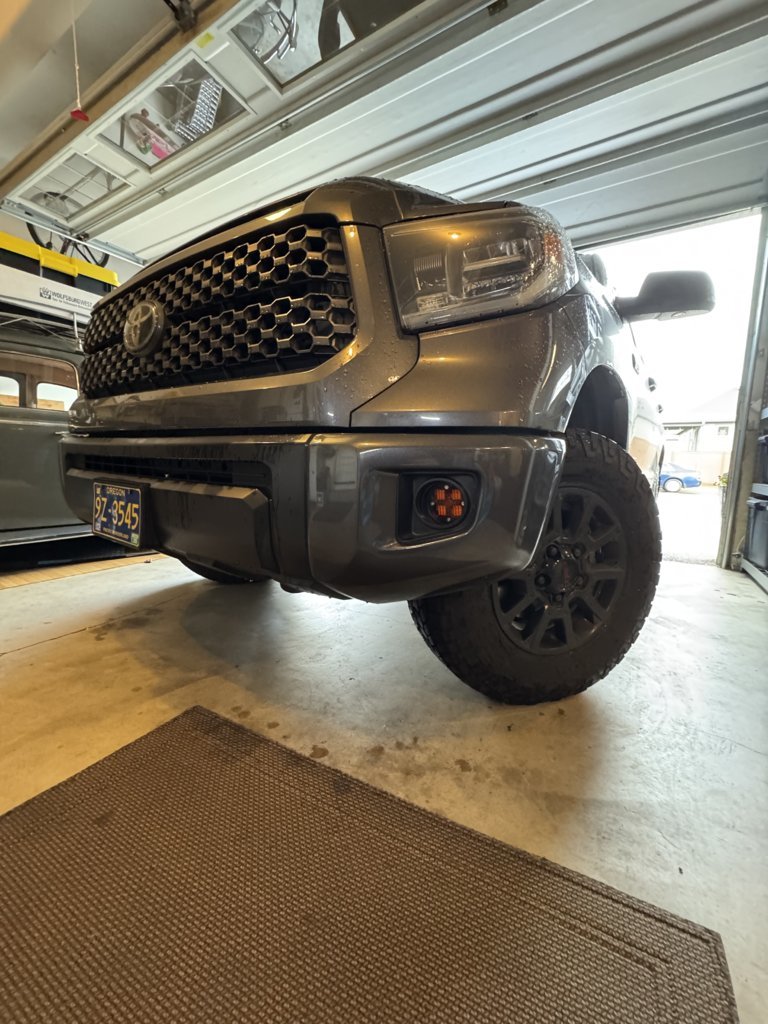

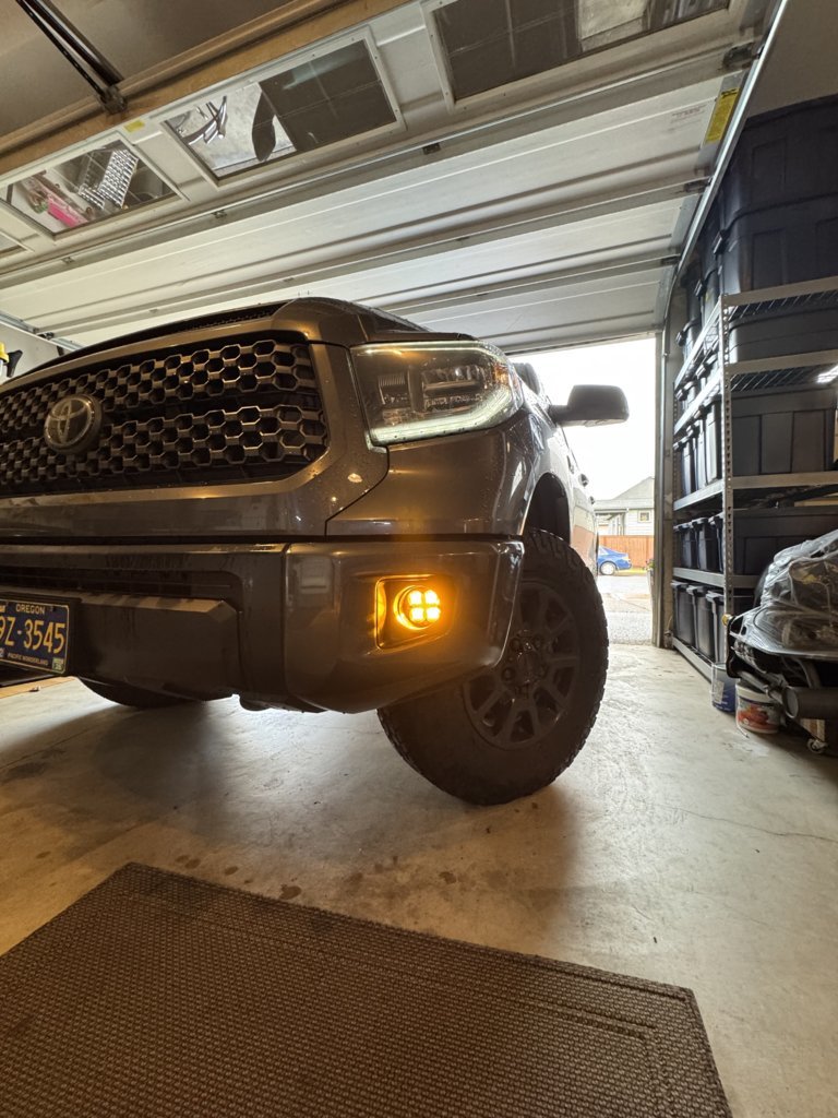

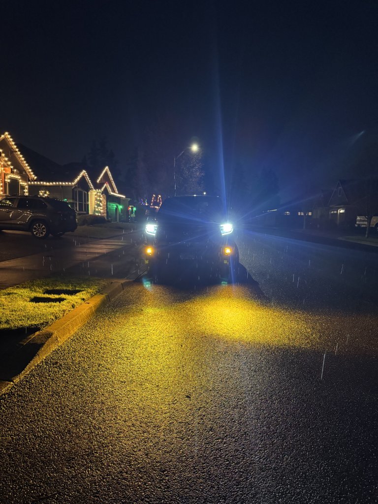

    Aaaaaand I'm back!
    The Squadrons are installed and they look great.
    However, I'm worried I chose the wrong lens. I got the factory amber cornering lenses, and the pattern is bizarre:
    I cannot see the amber flood on the ground sitting in the cab. @Baja Designs Is there a way to adjust these, or do I need to pull them and put the clear amber lenses in?

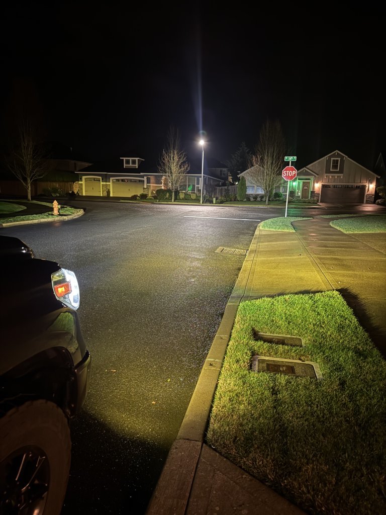

    I don’t have SAE Squadrons for clarification on your question, but I’d sure hope they do more than that! My Squadron Sports with wide cornering lenses are a million times more useful than that pattern if yours are doing what they’re supposed to.
    I bet @Baja Designs can help with an answer!

    On our SAE Model, the Reflector is what gives the pattern, and that is why all the SAE models come with a spot lens. The pattern you change them to is Wide Cornering so that's why it looks off. It's pretty much defusing the light x2. Also, want to highlight that the Factory Amber lens is not street-legal, and that is why we only offer them in Clear and Baja Amber on the website. If you have any questions please reach out to brahianh@bajadesigns.com

    Well that explains it!!
    the factory amber looks awesome, but I'll pull them and put the amber in. Thank you @Baja Designs !!

    Good point on the Wide cornering lenses being the culprit. I didn’t even think about that! Maybe. Because I’m more familiar with the original SAE offering that was just an insert behind the lens.
    Assuming when he puts the original lenses back in, that problem will be solved.

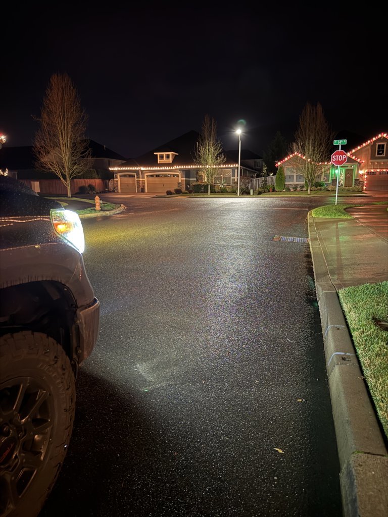

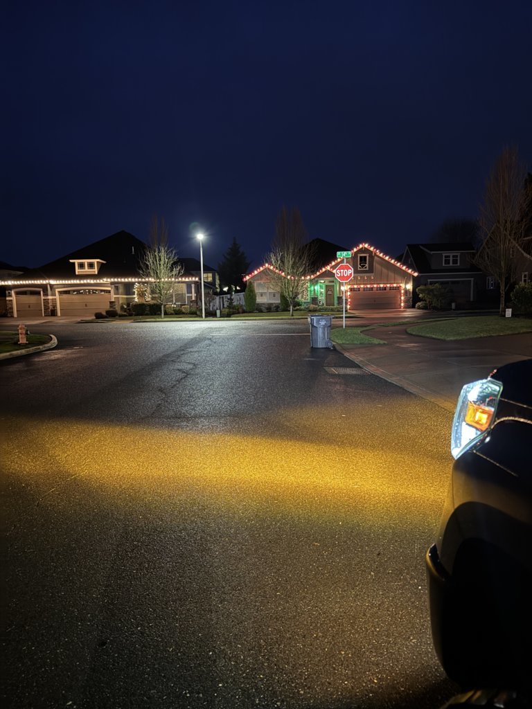

    Problemo solved. What a difference. Note that the earlier pics have Christmas lights on. The BD fogs really do dump a lot more light on the scene.
    Factory-
    New Baja-
