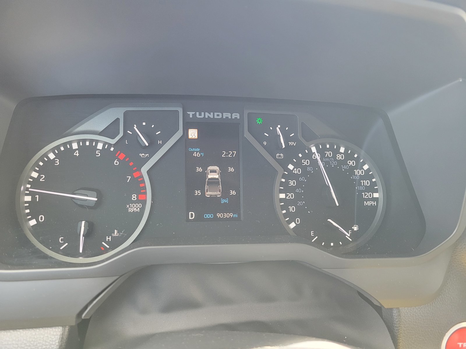

    Enjoying it a lot!
    I'm over 90k (purchased jan11 2022)
    Checked the service manual for fluid swap timing....
    According to the book, the only fluid to swap out is radiator & intercooler
    at 100k
    I'm looking at the following fluids:
    Front diff
    Transfer case
    Rear diff
    Tranny
    Brakes
    Any reason to mess with these fluids?
    Truck runs great atm
    As far as tranny, has anyone done a pan drop, strainer swap & refill?
    Any advice (if so)?
    Also, anyone know how much rad fluid to have on hand for swap?
    Thanks yall!
