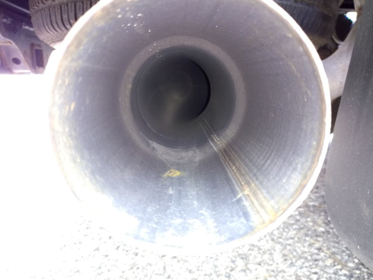

    Great video about e85
    https://www.youtube.com/watch?v=LnPJEI6AnZ0
    yup
    Gasoline is an awful lubricant as well. The potential lubrication problem is if too much water gets into the ethanol during storage, creates acids during combustion, and degrades the engine oil. This is why they recommend lower oil change intervals, not for the fuel, but just in case of bad fuel. If the fuel is good it shouldn't hurt anything. I sent a sample from my last oil change to Blackstone and the numbers were so good their response was basically "you don't need to change oil if it's just been sitting in the truck." That oil was driven shorter trips 6 days a week, about half the miles on e85, and I went over on the recommended time, all of which is potentially problematic which is why I had it checked.
    As for carbon buildup. Ethanol doesn't have the multitudes of hydrocarbon chains in gasoline that need to get broken apart and oxidized. It does have more hydrogen and oxygen in it though that makes much more water vapor in the burn and steam cleans everything. Pic up my tailpipe to show how much it cleaned it out. A year ago there was a lot of carbon even turning the rear bumper black so it was no surprise the motor was trying to ping a little in 6th gear.
    It's not a miracle fuel; it doesn't go as far on a tank, needs more oil changes, can't sit in the vehicle for three months without worry, and probably should have normal gasoline ran though now and again (a proven way to prevent issues on GM and Ford flex fuel vehicles), but it does have its uses.
