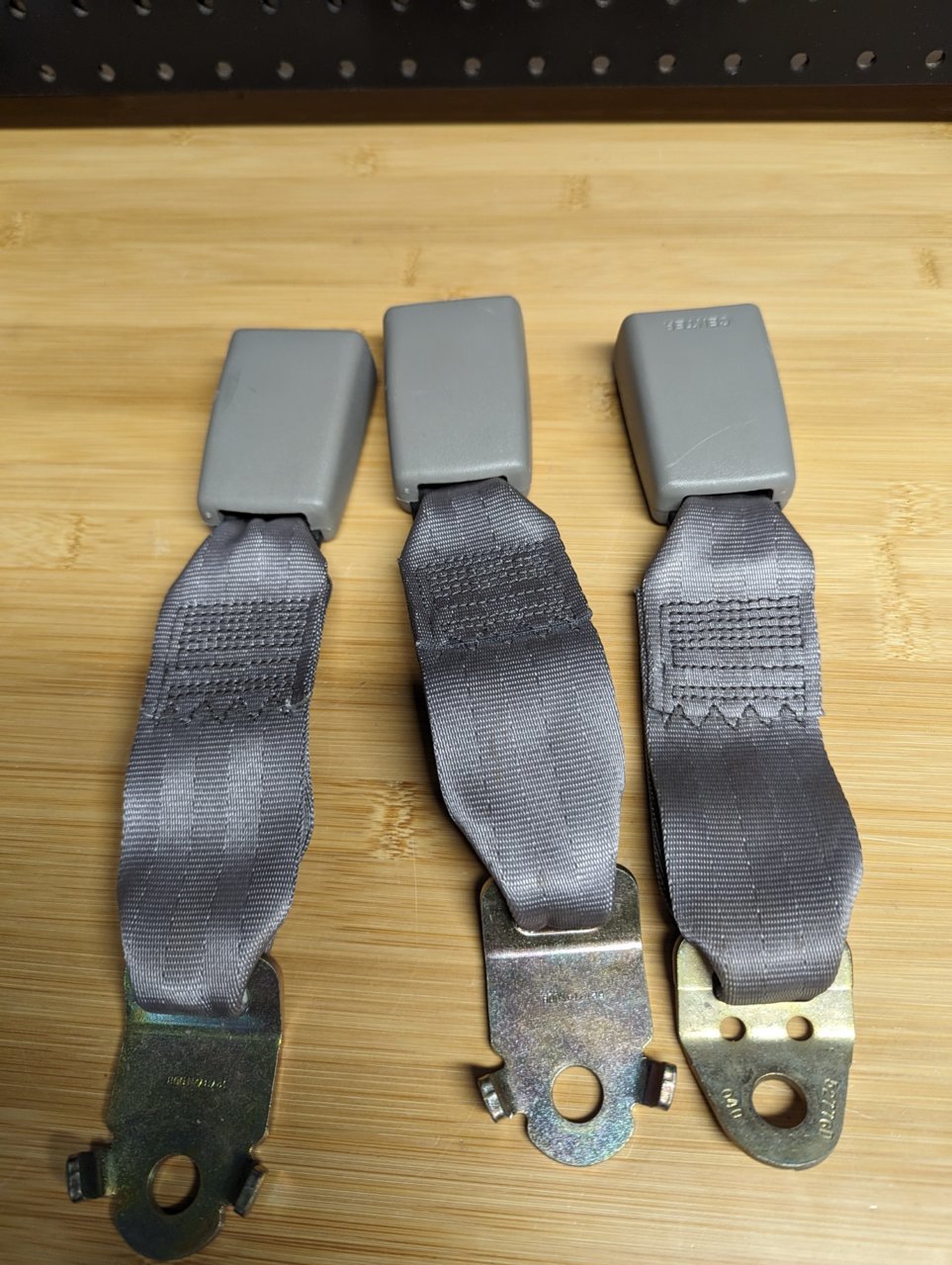

    MAF cleaner didn't help with the button being stuck. I wonder if any of my back seat receptacles could be swapped to work up front. I'm guessing not.

    Intersting. I find normally triflow or CRC contact cleaner will usually clear up any issues. I'm sure there's probably a way to pop the two halves open also, but there will be springs and other BS in there, so who knows what you'll get.
    As far as swapping with the rear ... nope. You'll notice the front receptacles have a long plastic-wrapped tube that almost looks like a cord concealer, going from the bolt on the floor up into the receptacle. Guess what? That's exactly what it is. There should be either 1 or 2 wires going up thru that tube, into the buckle itself. That's what feeds info back indicating the buckle is latched. When you push the buckle in, it either opens/closes a circuit, which is how it knows "OK, all good!" or not. This is how every car I've ever owned worked from the 80s forward, the only difference is whether there were 1 or 2 wires running up into the buckle. Majority of the time it's only 1, and they're using the bolt into the floor as a ground source for the circuit. Sometimes just having that bolt at the bottom of the front buckle get corroded will cause a lot of the issues of flashing lights and other bullshit.

    You would be correct since they do not have contacts inside nor a plugin.
    $40 and new one can be here by Wed at latest :)
    Another thing you can do to verify it’s not a lack of grounding problem at connector, is to unplug the 2 conductor plug under seat and short the 2 conductors together(truck side of harness), does light go out ?
