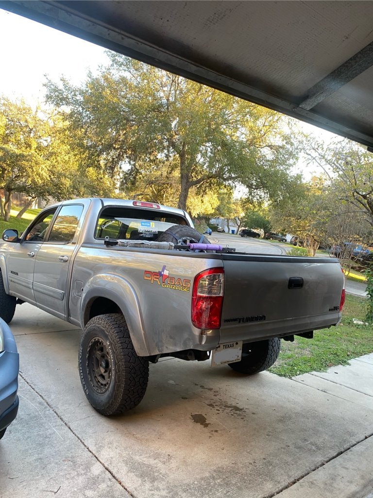

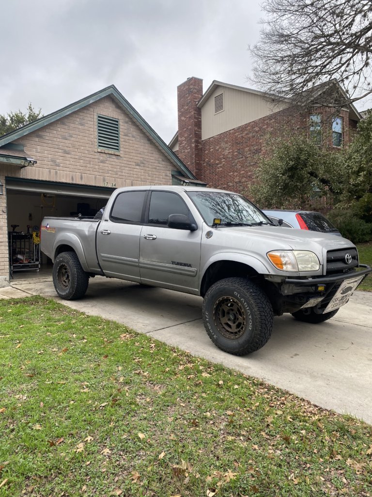

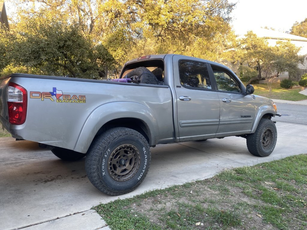

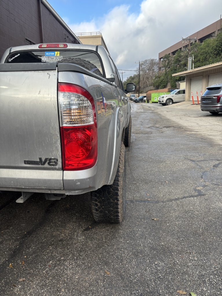

    IMO. Looks sooooo much cleaner w/o the tire hanging off the ass end. IMG_5199.jpg IMG_5201.jpg

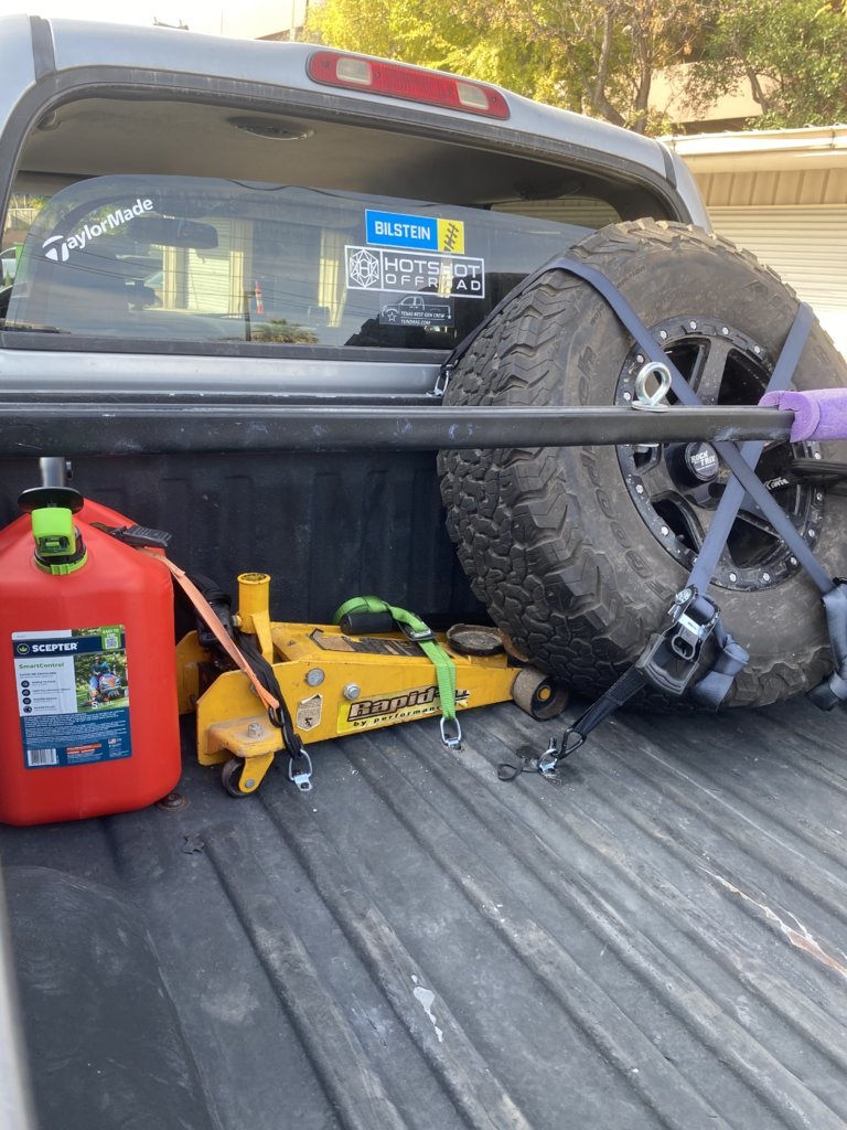

    fucking do it. It only cost me $50 for the spare set up. (Tie downs, rachet straps, And hardware)
    And maybe $20(?) for the Jack tie downs/hardware. Which I did last night. Driving up to Colorado today and bottle jacks blow. IMG_5213.jpg

    I have a mount already in the bed on the left rear before I replaced the cable and put the spare back underneath. I was referring to the bumper delete mod.

    do it. All it required was a cut off wheel and a sawzall. Oh and a file is nice.

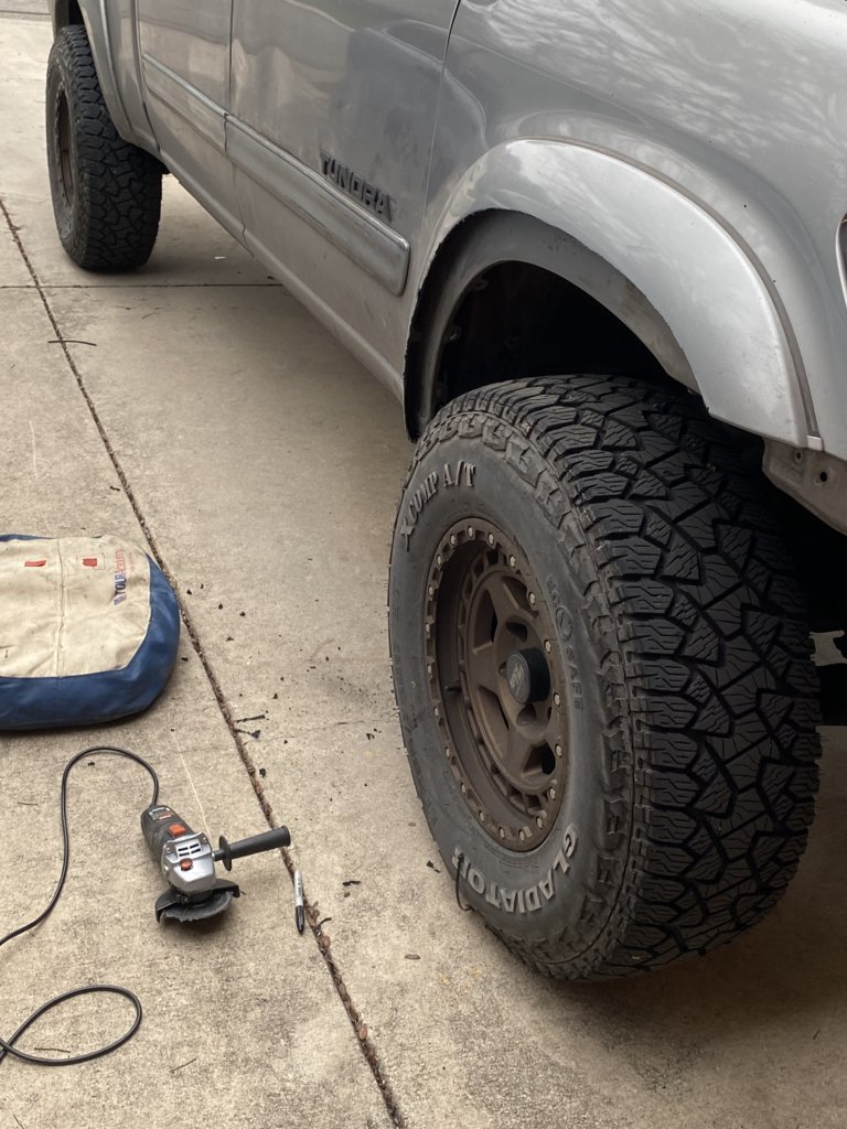

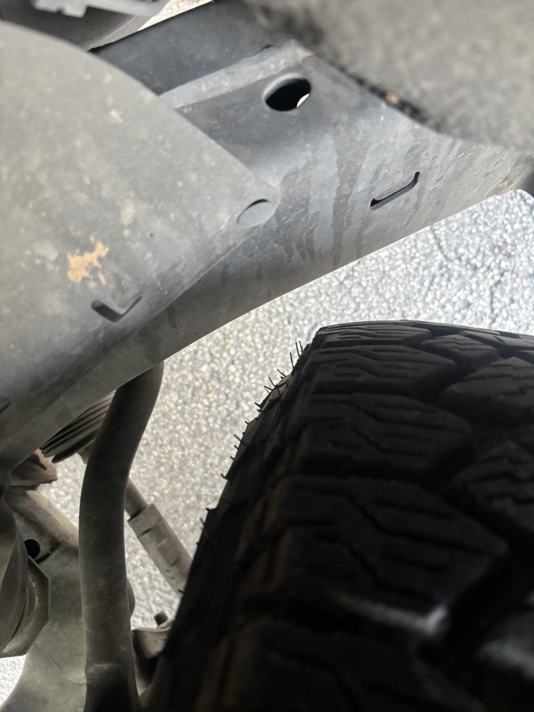

    Man that looks great. Do you just cut the flare and then the fender and that's it? Have to do anything extra to get the flare to reattach or anything with the air intake?
  9. Dec 24, 2024 at 1:27 PM
    #39
    FishNinja
    FishNinja [OP] HIDE YOUR DAUGHTERS
    Jan 3, 2024
    #109562
    2,181
    Lee
    TEXAN....big surprise
    06DC2wd
    yup. Cut off wheel for the flares. Saws all for the fender. Cleaned it up with a grinding wheel and flap disc.
    then hit it with some brake cleaner and painted the bare metal black.
    doing it on the truck was much easier than expected. Just had to turn the wheel keep the tires outta the way

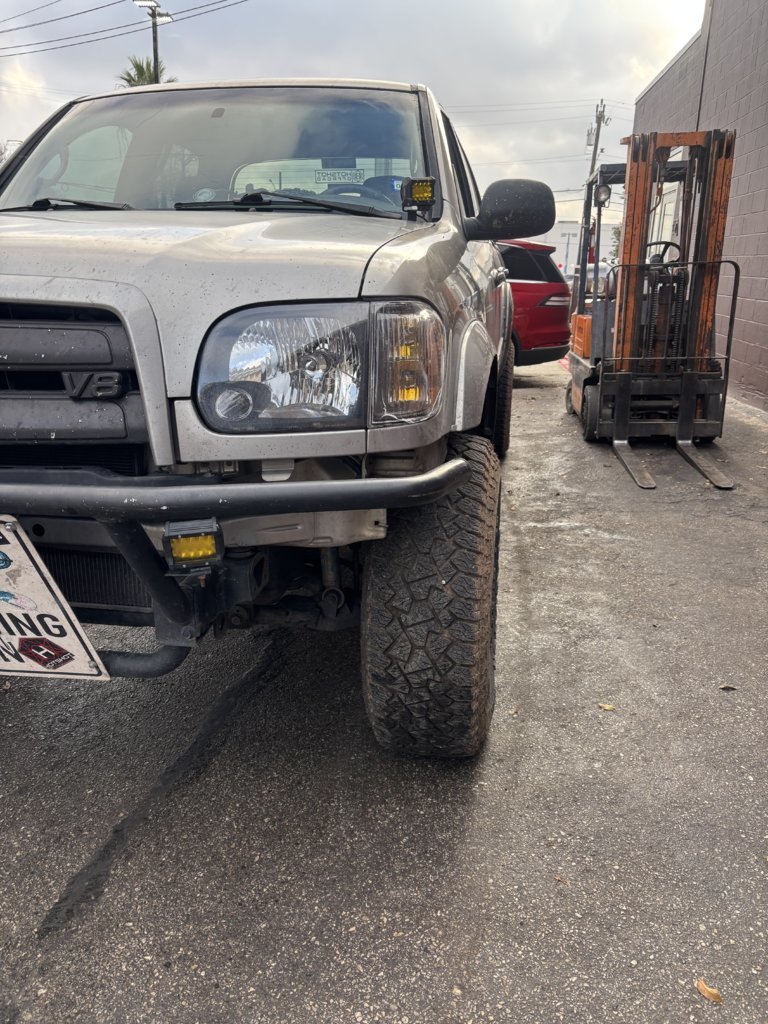

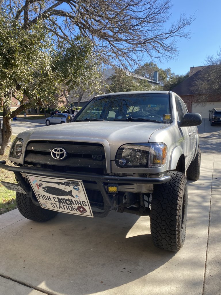

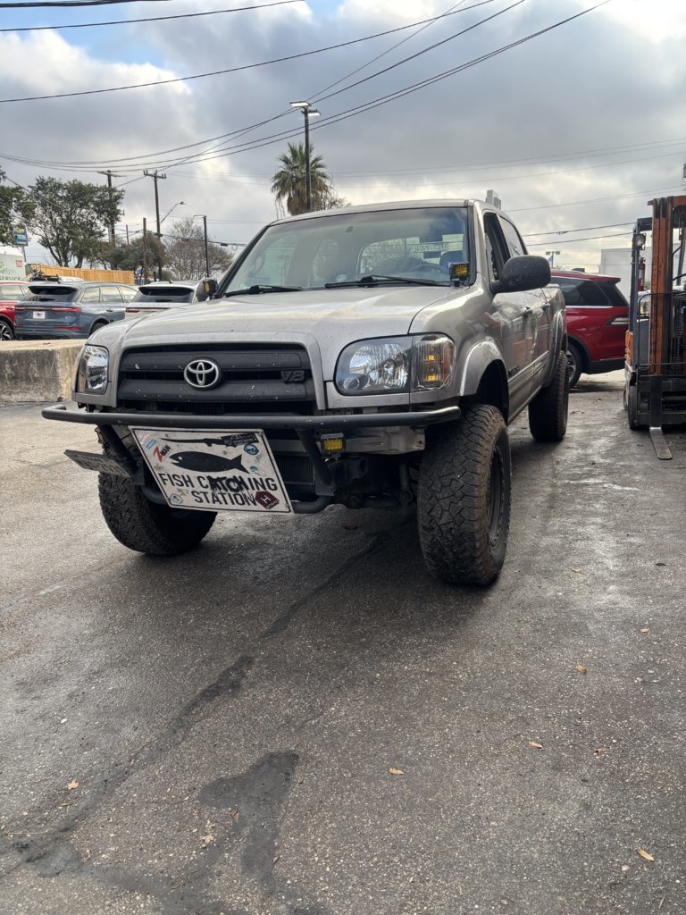

    So I had luck with this brand fogs. So I got their headlights. We'll see later tonight how they adjust. But fitment wise....meh....one bolt fit. Everything is zip tied in.

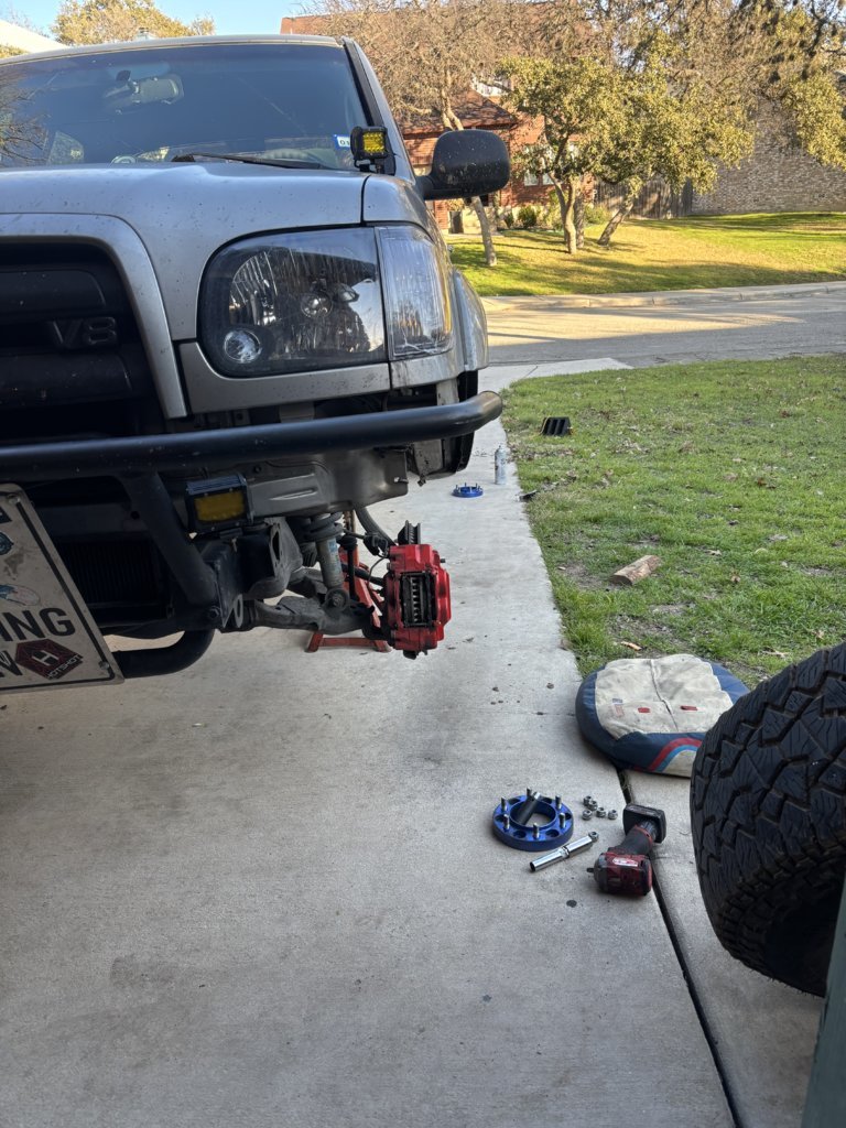

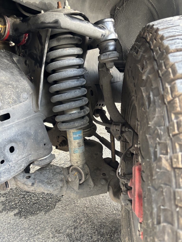

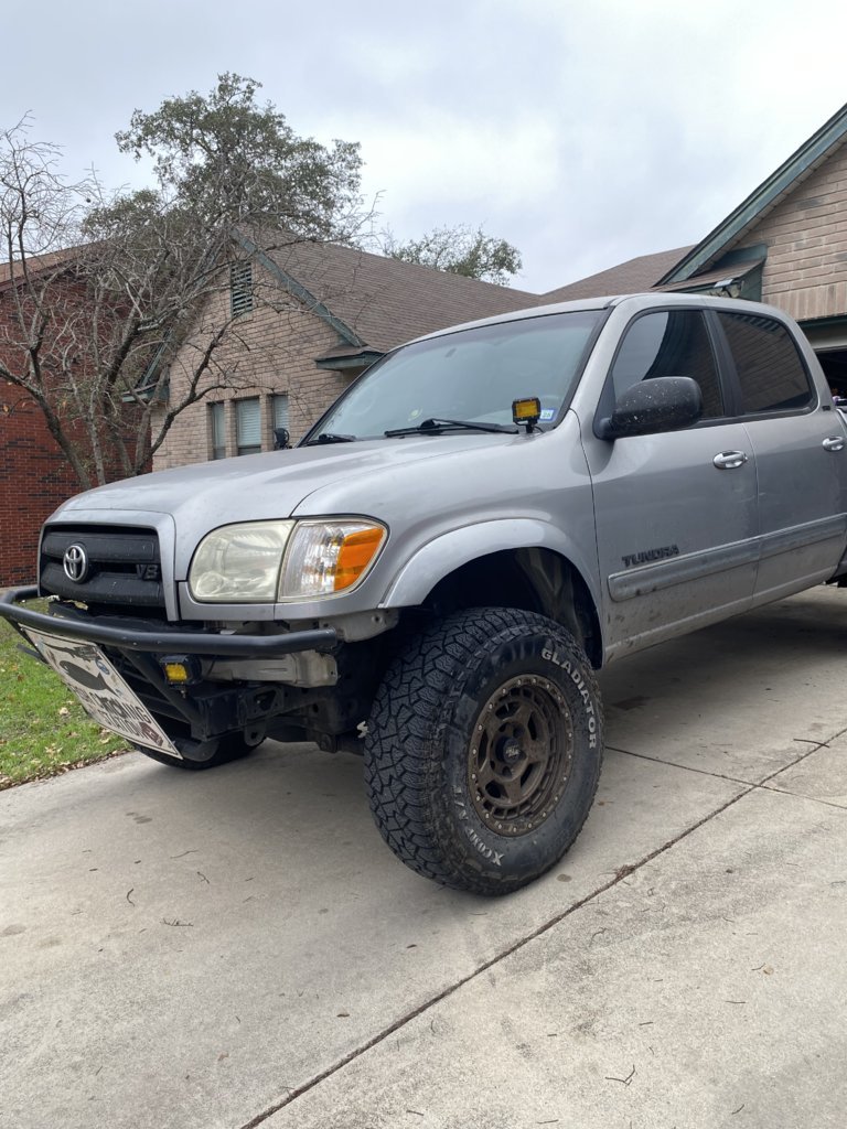

    This is Tinkers' Adventures fault
    Bye bye wheel spacers.
    She doesn't sit too bad at -12mm (spacers were 1") and quite frankly, handles much better over bumps and shit.
    Suspension geometry is a bitch

    Pull the spacers?

    si.
    I guess I should say that lol

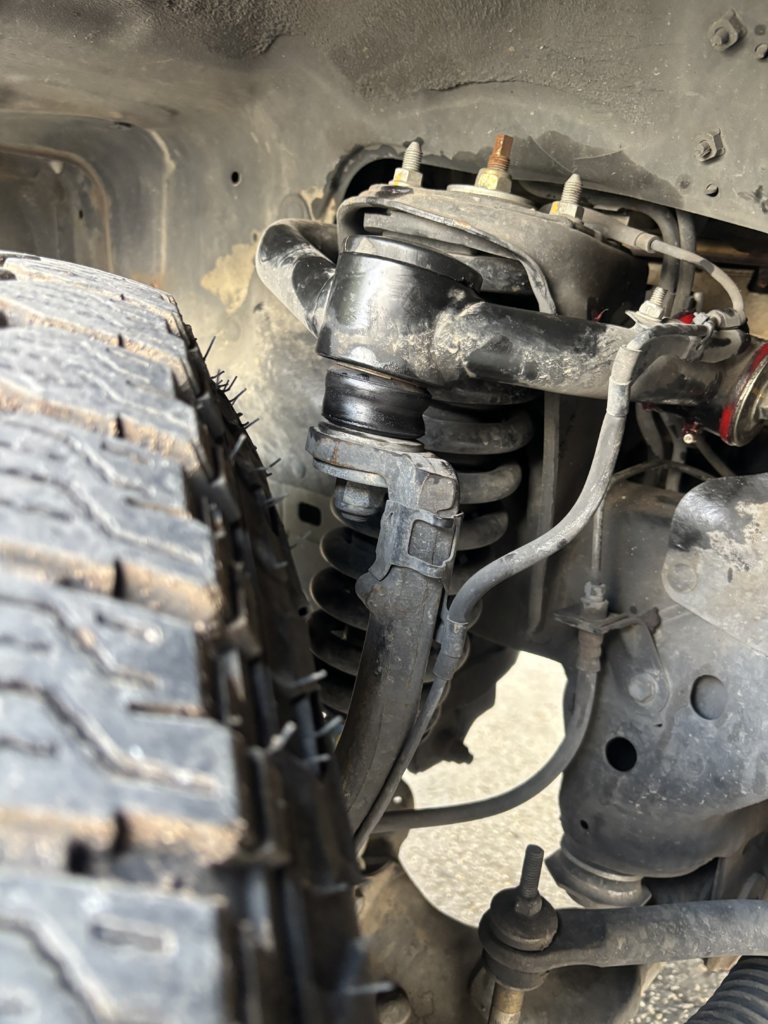

    Any clearance issues with the frame/UCA now?
  16. Feb 3, 2025 at 7:00 AM
    #46
    FishNinja
    Jan 3, 2024
    #109562
    2,181
    Lee
    06DC2wd
    nope
