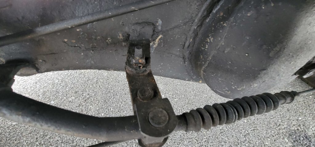

    Today I quickly rolled under the truck to briefly see what everything looks like before I dropped it off to get the frame treated with woolwax and took some pictures. I will lift the back and take a closer look after I get the truck back. My takeaways so far are that I may need to replace the U joints as they are bone dry and some look rusted up pretty good. Also, I saw zero sign of any zerks anywhere on the driveshaft and on the points shown in the diagram below. I am wondering if they could possibly be on the top side of the driveshaft facing up since I did not have it in neutral nor spun the shaft to check...I'll post pics but it does have me concerned that I didn't see any on this quick check up.
    While I was under there, I checked the bell cranks (though I did not remove the ebrake cable off them to see if they pull back) and they look pretty rusted up, even the springs weren't too springy but they weren't all the way frozen up either. Bell cranks didn't move at all when I pulled on them so I'm thinking they should probably be replaced? But again, that's without me disconnecting the PB line from them. I also checked all pivot points and turn buckles as outlined in other threads. Equalizer and bushings dont seem to be in great shape. The PB line itself didn't seem too stretched or really rusted. But I did notice the passenger side was very loose when the PB was not engaged while the driver side stayed taut. But it did become taut again once the PB was engaged.

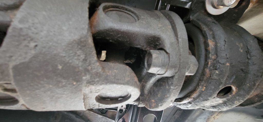

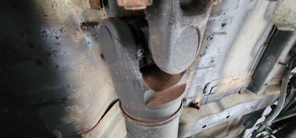

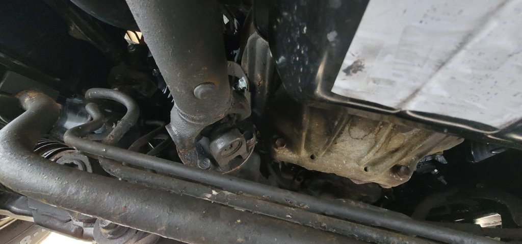

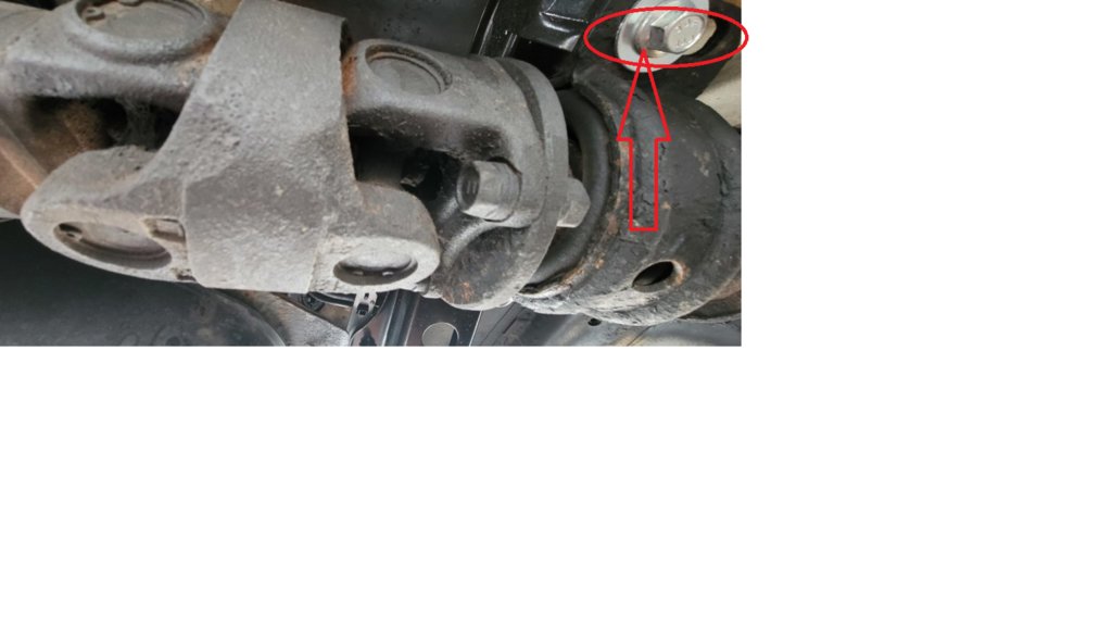

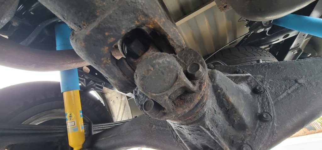

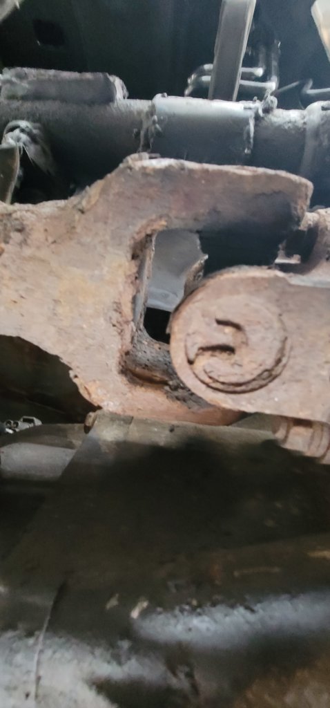

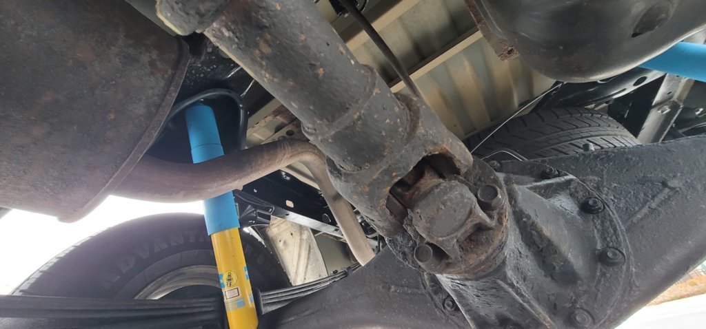

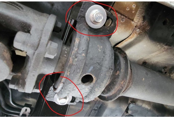

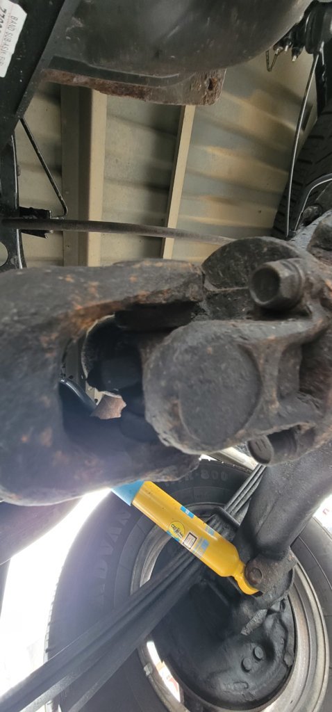

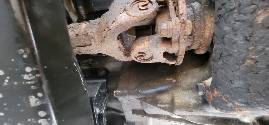

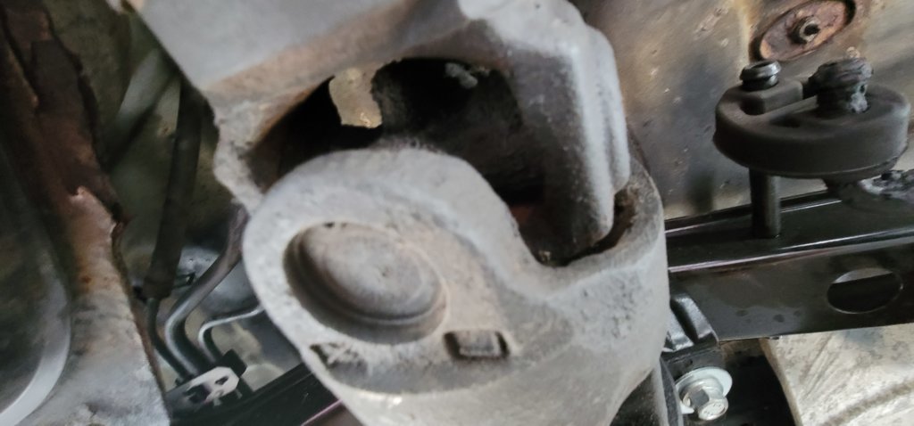

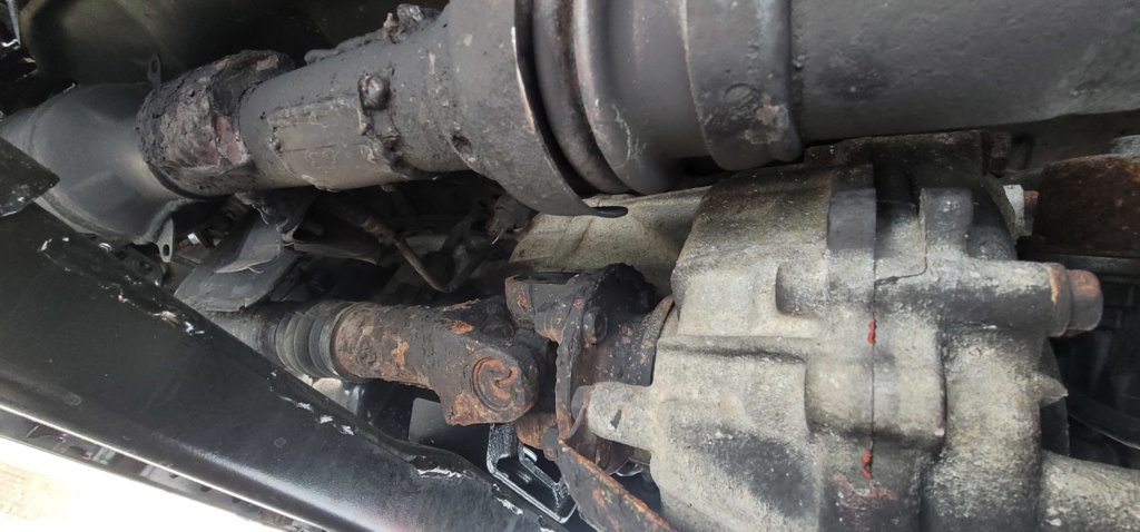

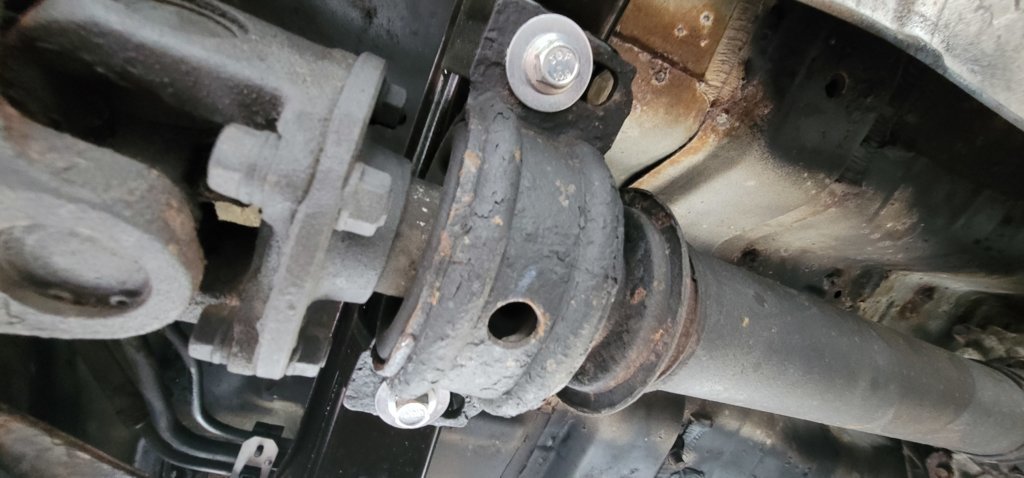

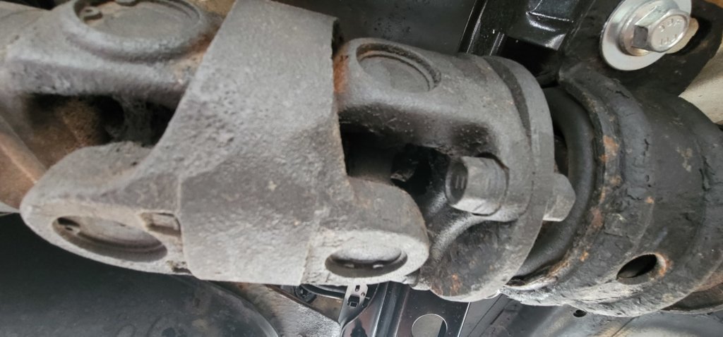

    Pictures of drive shaft
    G_unit3000 and MooreKen like this.

    Another good one:
    https://www.tundras.com/threads/grease-your-drive-shaft-you-lazy-sods.55067/

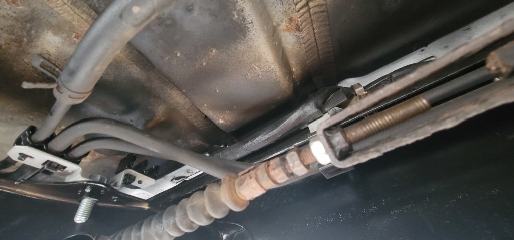

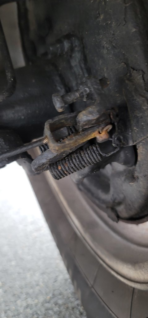

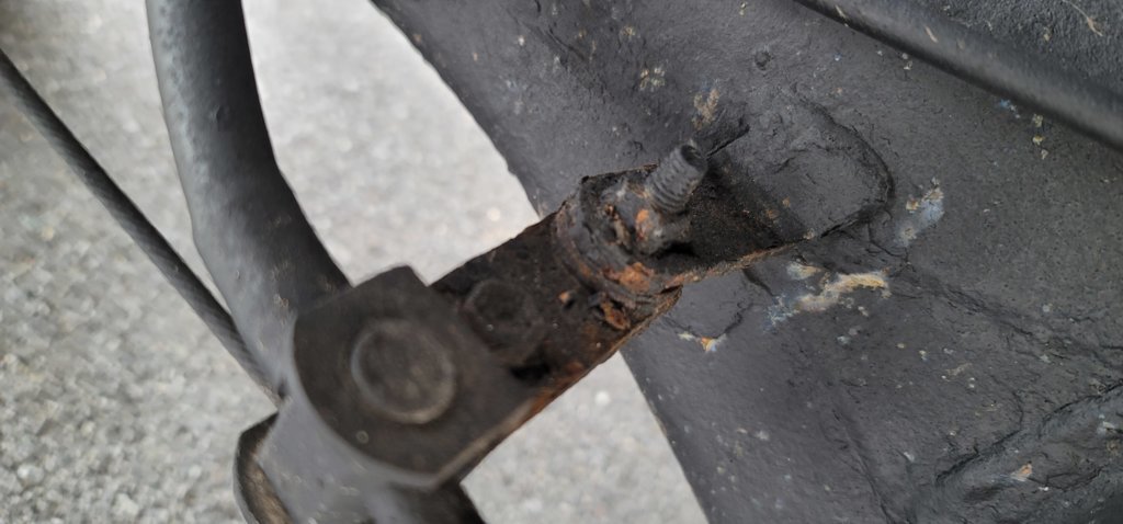

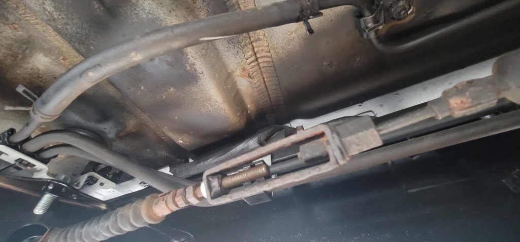

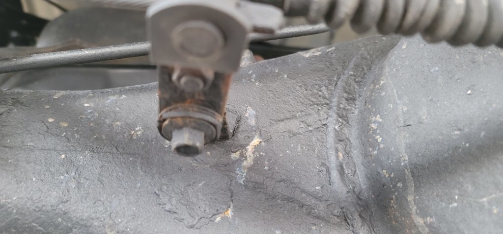

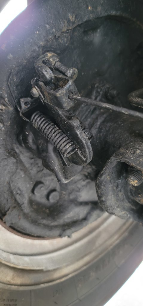

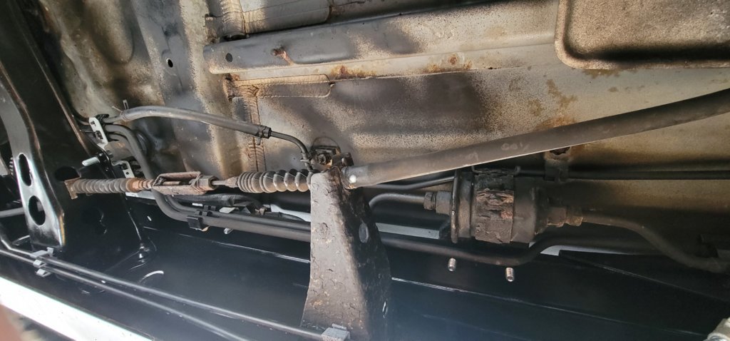

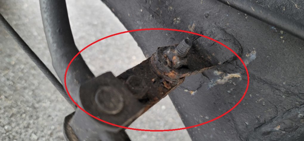

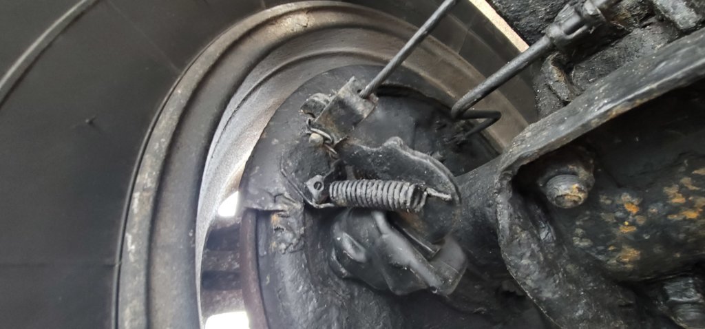

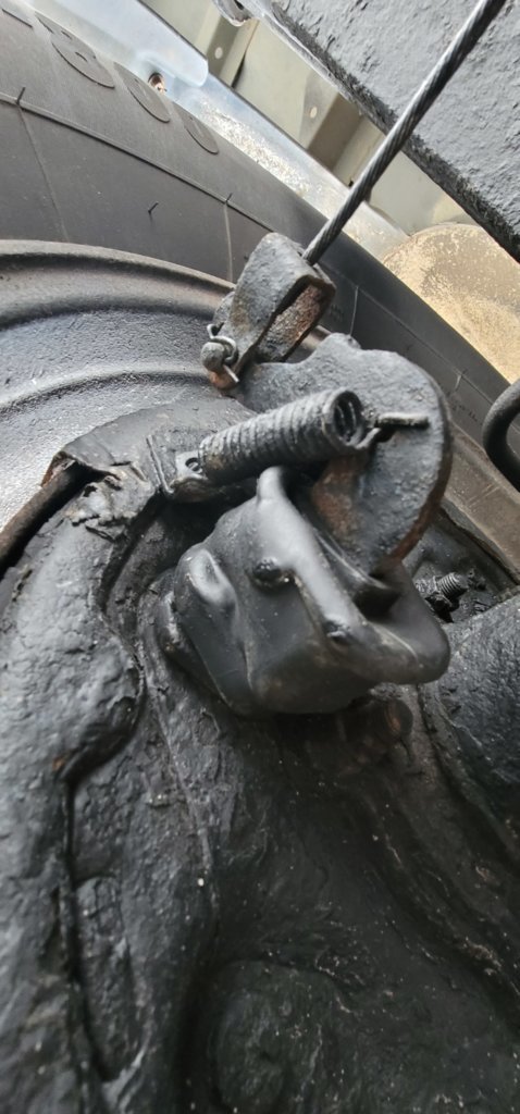

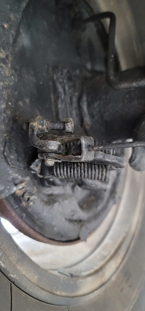

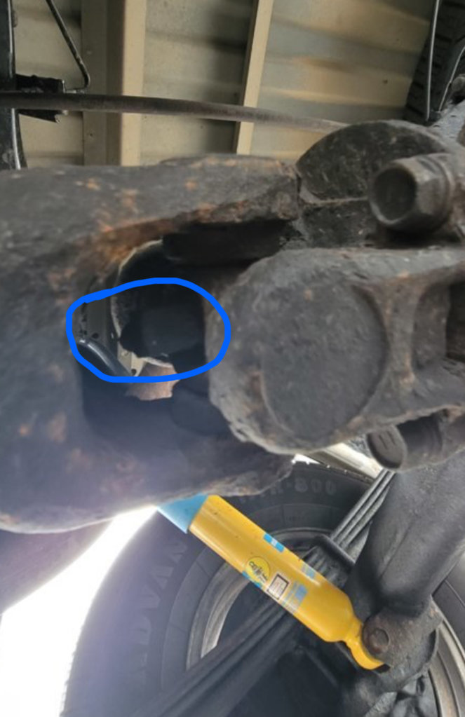

    Pictures of PB line, turn buckles, equalizer, and bell crank
    Mine does not look to be in as good condition as Aerindel's was taken from his post here:
    Back to mine:

    You appear to have a spacer on your carrier bearing? Also some fresh bolts there for some reason.
    G_unit3000 likes this.

    Thank you, sounds like it was a U joint that fixed his, however mine seems to be the opposite effect--when I lay off the gas it vibrates even more instead of going away. Regardless I think replacing mine at this point is a good idea and hopefully solves my issue as well.

    Likely from when the frame was replaced (recall replacement in October from when seller took to dealer to get done)--I'm guessing the previous bolts were too rusted to put back on and were just replaced with fresh ones.

    Could be an optical illusion, but make sure the carrier bearing is bolted to the frame with no spacers between it and the frame. You appear to have no rear lift, so no spacer is needed.

    Yeah just stock height for both front and rear and no lift kit added. So you mean both this washer and spacer where the bolt is right? Here is another angle of what you pointed out.

    Your rear brakes are definitely out of adjustment. I'm also guessing that your parking brake equalizer and bellcranks are seized. I was able to free up my equalizer pivot pretty easily, but I replaced my bellcrank assemblies instead of trying to get my old ones unstuck. Yours don't look too bad- try sticking a long screwdriver into the end where the cable attaches to get some leverage. Sometimes you can get the rear brakes properly adjusted with lots and lots of parking brake use, but that's only if the cable is properly adjusted. You mentioned that you get 8 clicks- this makes me think that your cable is pretty far out of adjustment. I believe you can adjust the cable via a turnbuckle below the drivers seat area.
    You'll be shocked how much better your truck stops once your rear brakes are set correctly.
    As for your driveshaft, try greasing the U-joints before you buy any parts. I use a grease gun tip like this: https://www.amazon.com/Dispenser-Fittings-Greaser-Adapter-Threads/dp/B0BBVKFGRS?th=1. You'll have to jack up the rear axle and put it in neutral to spin the driveshaft and get all the zerks, but it isn't too tricky.

    Thank you for taking a look. Yeah I think I'll just order replacement OEM bell cranks (heard mixed things about the dormans) they look to only be $25 a piece from local toyota dealers here--Even if I did loosen them up, I think they probably won't last much longer based on the current condition. Are you supposed to be able to move the equalizer pivot by hand with the PB disengaged or just be able to move it no matter what? I'm trying to figure out how I can test if it is seized or not and if I'll need to replace the whole bracket or just the bolt/bushings if it is. I'll try the turnbuckle under the seat as well--soo many factors on this PB brake system to track.
    I'll give the grease a try first and see how it feels after, I didn't see the zerks when i checked but I also didn't put it in neutral and spin the shaft yet. Hoping the zerks are in good shape--will order those needle attachments too though

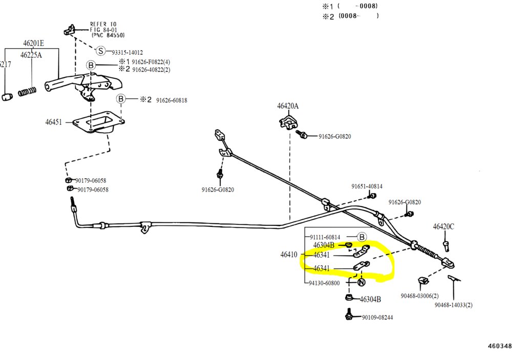

    I used the Dorman bellcrank kit when I did my brakes, and I was pleased with the quality. It came with all of the hardware needed, including the mounting bolts. However, if you can get a deal on the whole assembly from Toyota- that’s a better option.
    After I got my equalizer pivot freed up, I was able to move it by hand, but my cable wasn’t adjusted correctly, so one side had some slack. Mine looked a lot worse than yours does, but I heated up the nut with a torch until it was very hot, and the bolt came right out. This melted the rubber bushings, but I believe new ones were pretty cheap. Use lots of grease when putting it back together.
    The grease fittings are pretty well hidden:
    A headlamp helps.

    The drivers side front axle, the inner cup can "wobble" in the front diff when the bearing in the diff has slack in it. The tacoma and 4Rs are having lots of problems with the needle bearing in the drivers side of the front diff. They are all using the EastCoastGearSupply isostatic bushing(bearing) in place of the needle bearing. The 40-45mph "womp womp womp womp womp" noise that resonates and you can feel in the pedal is the drivers side inner cup wobbling around in a sort of harmonic vibration.
    Seems the quick check on the tacoma and 4R is putting it in 4H and driving and seeing if it stops.
