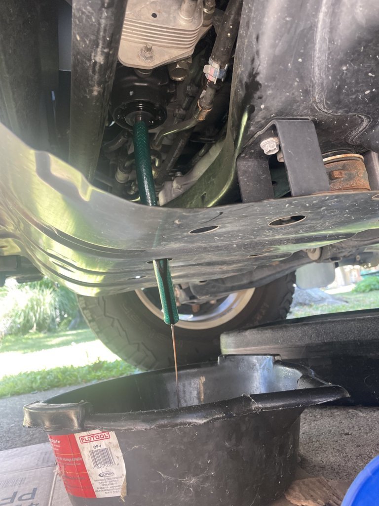

    No door ... stole this picture off the internet.
    I also put 1 sheet of pig mat on top of skid plate to catch the drips when removing filter.

    And it has enough hose to cut a piece and use on a Fumoto if you get the one with short nipple. I keep large pieces of cardboard in my garage for oil changes. I have 2x6s doubled up that I drive truck onto. The extra 3" works fine for me but also have 2" lift on front. The oil drain is on back of the pan so elevating the front probably helps when draining it.
