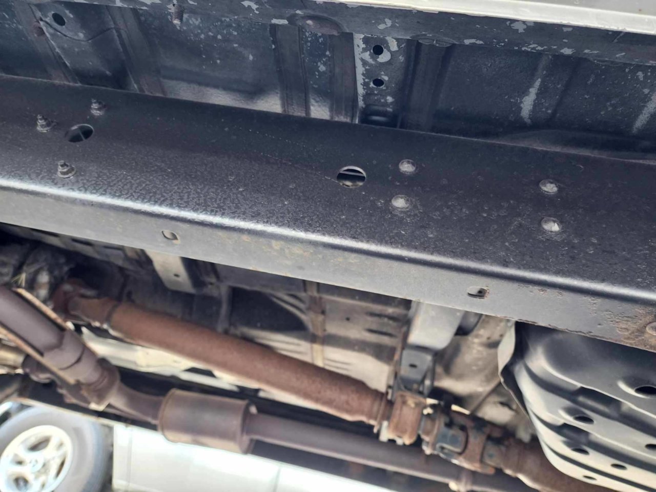

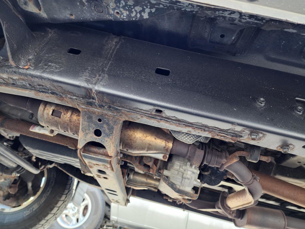

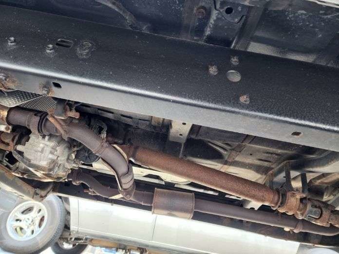

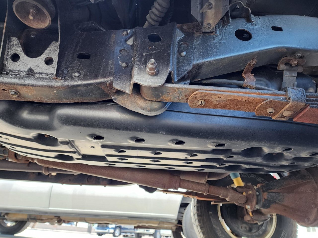

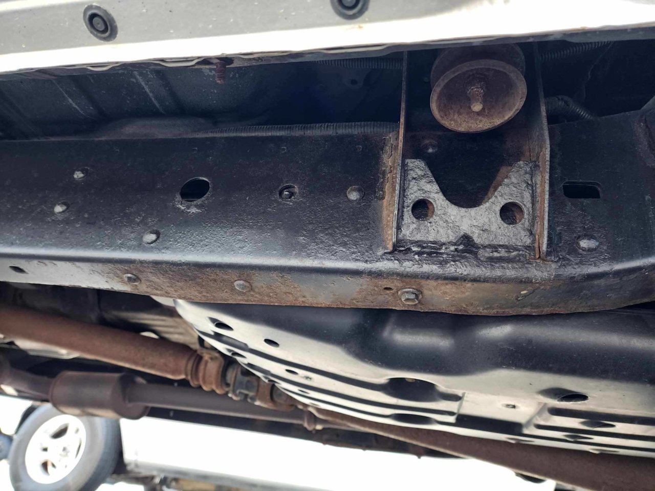

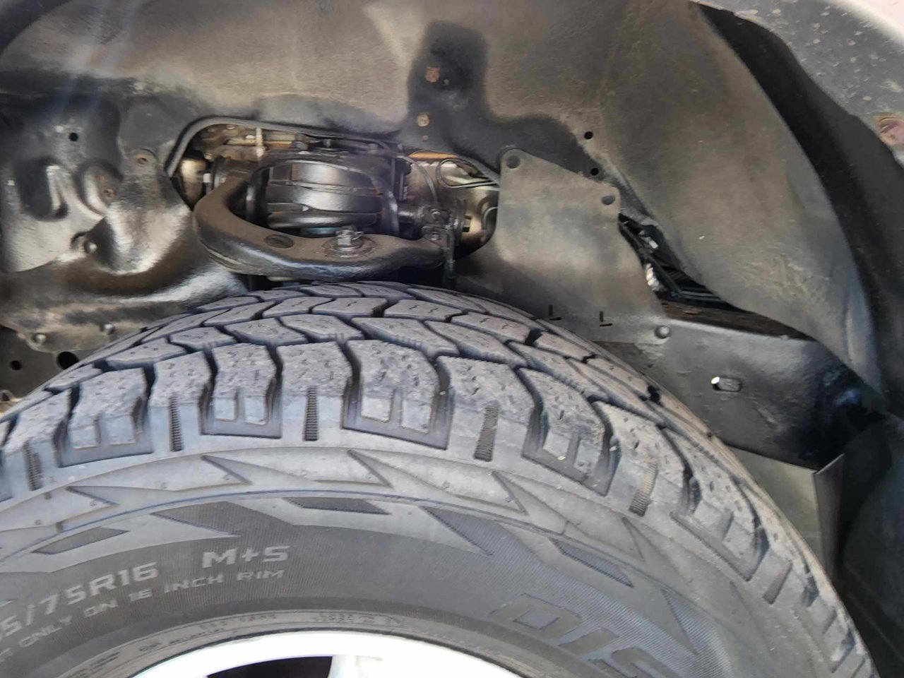

    Ok here they are Resized952022081595114616.jpg Resized952022081595114612.jpg Resized952022081595114712.jpg Resized952022081595114705.jpg Resized952022081595114622.jpg Resized952022081595114608.jpg Resized952022081595114603.jpg Resized952022081595114616.jpg Resized952022081595114616.jpg Resized952022081595114612.jpg Resized952022081595114712.jpg Resized952022081595114705.jpg Resized952022081595114622.jpg Resized952022081595114608.jpg Resized952022081595114603.jpg Resized952022081595114612.jpg Resized952022081595114616.jpg Resized952022081595114612.jpg Resized952022081595114712.jpg Resized952022081595114705.jpg Resized952022081595114622.jpg Resized952022081595114608.jpg Resized952022081595114603.jpg

    I'd walk away from it. I lived in Park City, UT for 3 years and they use salt there, especially on mountain passes. I had a 4R which was a southern truck prior to moving there. Spent 3 winters there, got the car washing pass where they did underbody spray and also washed it on my own as well. I would still get rust spots especially on the welds. It wasn't terrible but enough that it bothered me. During my time there, looking at various used cars you can tell the winters took a toll on cars. Now it wasn't Midwest, Rust belt, or NE levels bad but you can still tell.
    In those pictures you can tell the frame has been resprayed. Lots of orange peeling and rust areas covered up with paint. Given how susceptible the frames are to corrosion I would walk away and find a nice SoCal, AZ, NV, or NM truck.

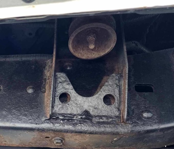

    Totally. Lipstick on a pig. Piss-poor cover-up job at that, you're dodging a bullet.
    This is everything I needed to see. Someone literally spent $10 on rattle-can paint to cover up the rust. You can see the overspray void behind the "owl" here, and - just for the record - I think that support may've been welded in after the owner checked the frame in 2015, I don't have the same support on my rear driver cab mount. It could just be a DC thing, but if people were welding shit onto this frame for support, that's another screaming red flag!:

    Walk away. You have better options in your area. If you were here in the northeast, that might be a best option in which case I’d tell you to get out your creeper and ball peen hammer and check it out underneath. If that’s a rubberized coating, stay away. Definitely rusty.

    Yep. Pass on that one. Utah is only slightly better for rust than the rust belt. (Unless it was from St George area in Southern Utah its whole life, and still, better still check cause snowy, salty roads are less than an hour away from there in the winter.)

    I thought we were gonna jump in to help you look for another truck-? Unless you’re going to go get under it with a screwdriver to poke into all the rusty and painted parts (to see if there’s already holes in the frame), I’d recommend you pass on this one you know about.
