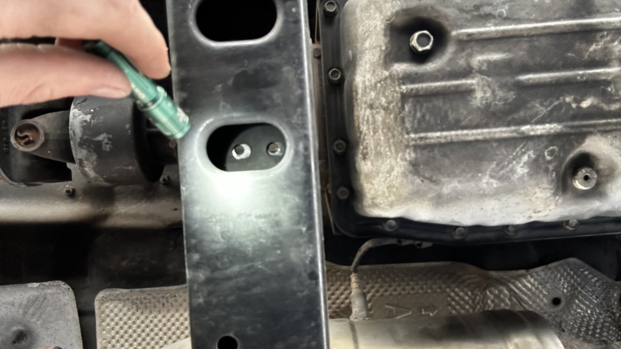

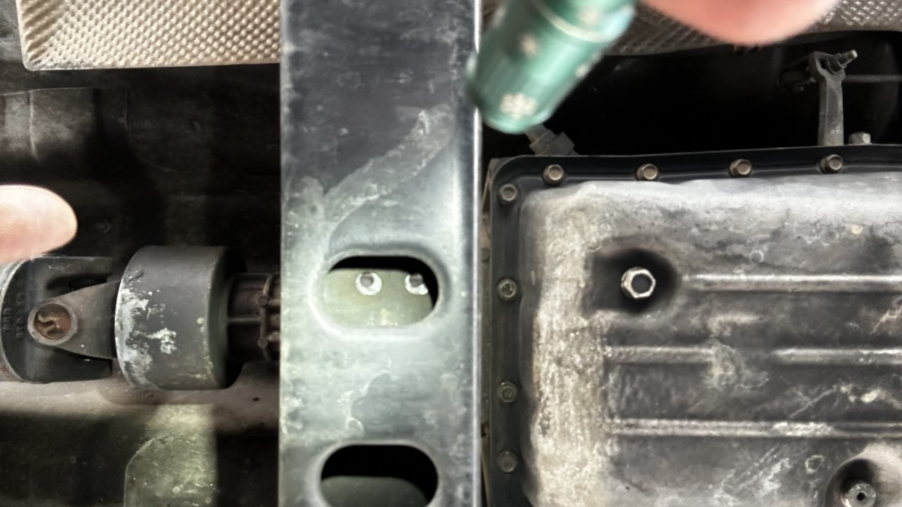

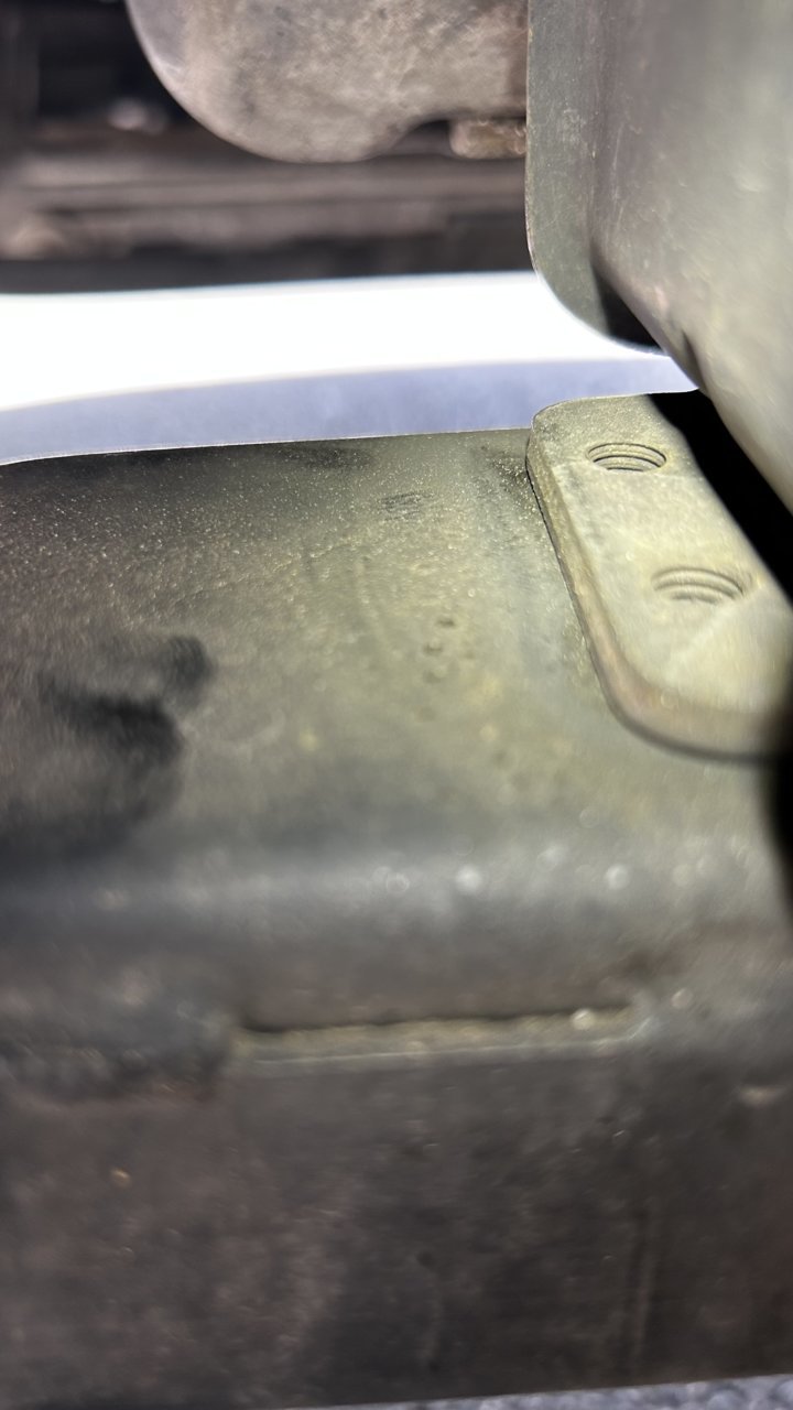

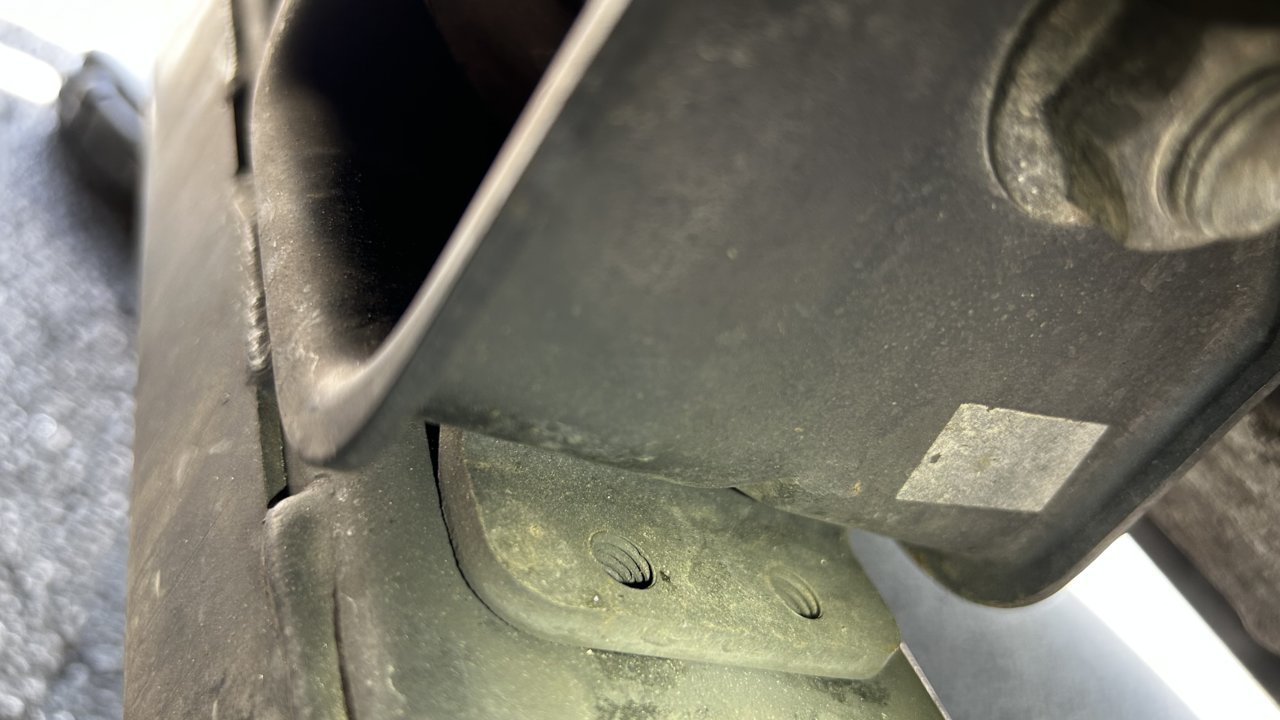

    Hey everyone,
    I just want to start off by saying I’m currently under my truck in my college dorm parking lot and need info ASAP. My truck had been neglected before I bought it and i am trying to get everything fixed.
    All four of The bolts holding my transmission to the crossmember are gone and I was wondering what size i need to get to replace them. I have read about them getting loose over time and I’ve done hours of research but I can’t remember if there had been a post about replacing them (yes i use the search bar often).
    Thanks for any help, I seriously appreciate it!
    - Luke W
    CFB3F4D0-4664-47B7-90E7-E1E969D4A148.jpg 8C68C8AB-BD30-4191-B668-2871EEE193FE.jpg 9FB24763-BD77-446E-98AA-CDA0A48B2A5D.jpg B1385121-361F-4F13-A94C-7E42EEB2F79E.jpg

    Hey Luke, this is part of a larger TSB which is one of many topics covered in this thread: https://www.tundras.com/threads/so-you-wanna-buy-just-bought-a-1st-gen-tundra-eh.115928/
    The TSB that's linked in that thread - search that page for the word "clunks" and you'll find a link to it. It has all the part numbers you'll need. Use blue loctite on reinstall and torque to spec as indicated in the TSB. You don't need to buy a new crossmember UNLESS your existing xmember has hairline cracks.

    Thanks a lot shifty! Its not cracked. I appreciate you
