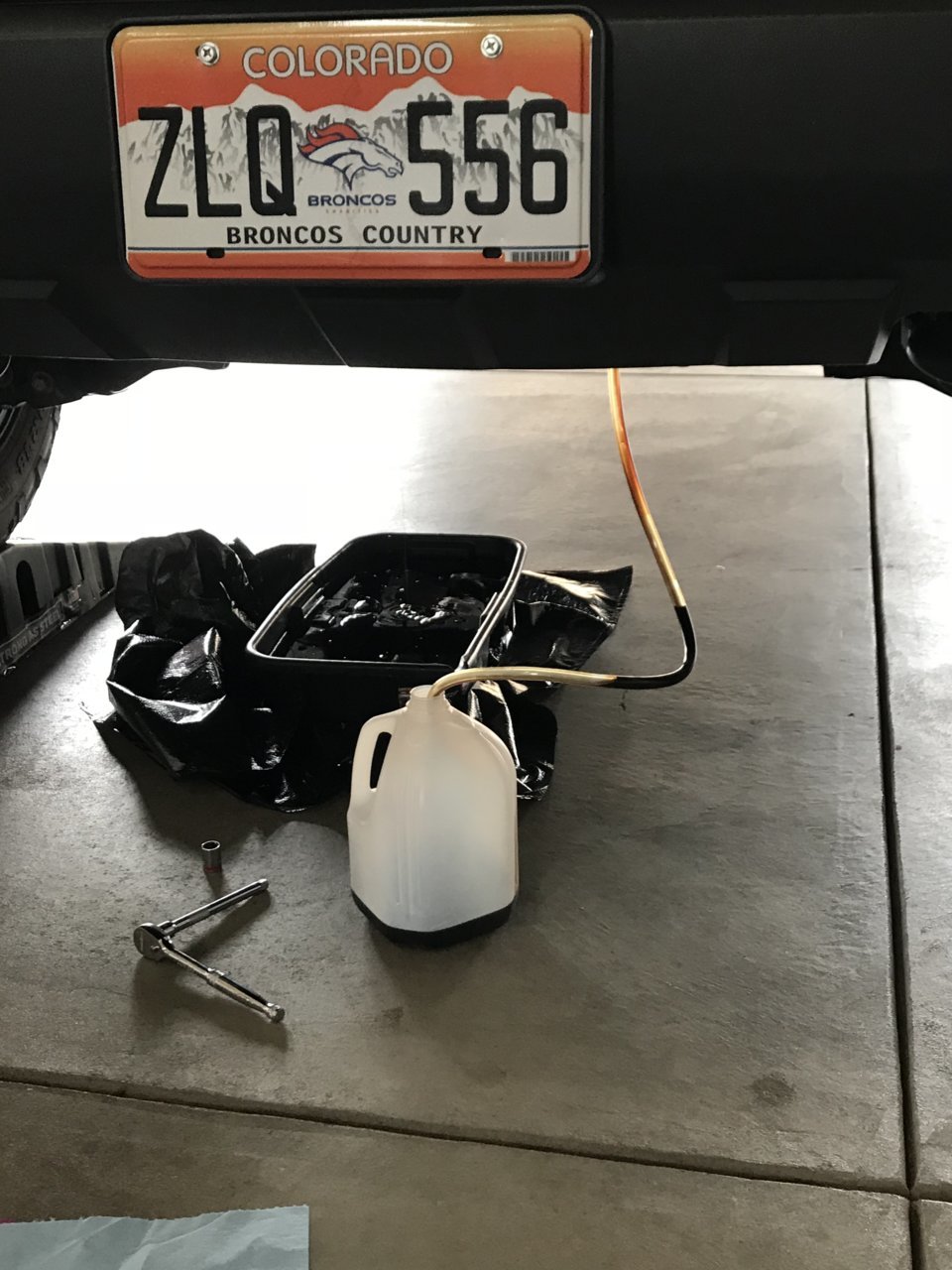

    My Tundra is a 2017 Limited. At 5000 I brought my Tundra to the dealer for its first oil change. This goes against my better judgement but the allure of FREE brought me in.
    This time at 10,000 I was stocked and fully prepared to do it myself.
    The MOTIVX filter tool and drain tool made this an absolute breeze! I literally did not spill any oil. You can do a search to find these tools.
    But, here is what I learned.
    The skid plate is not a big deal at all. It’s literally 5 minutes off and 5 minutes on. Although I think I will be purchasing the RCI skid because of the access port to the filter housing. Not having to drop the skid would make this job so damn easy.
    The dealership put about 8.5 quarts of oil in my truck. I will post a picture of the oil that came out. The full container is higher than what Mobil fills them so you can see it was to much. It calls for 7.9 with filter but 7.5 was perfect and right about half way between marks. I check my oil regularly and after leaving the dealer it was above the top dot but I let it ride since it wasn’t terrible.
    They also tightened EVERYTHING from skid bolts to filter housing WAY to tight. I torqued everything to spec.
    Specs I found were
    22 ft lbs on drain bolt
    18 ft lbs on filter housing
    9 ft lbs on filter cap.
    Anyone on the fence I will confirm this was an easy job that took 1.5 hours beginning to end and that is with my anal ass cleaning everything and double checking everything. It’s also confirmed to me that the quick lube bone heads could care less about how an oil change is done in my truck.
    Good luck!
