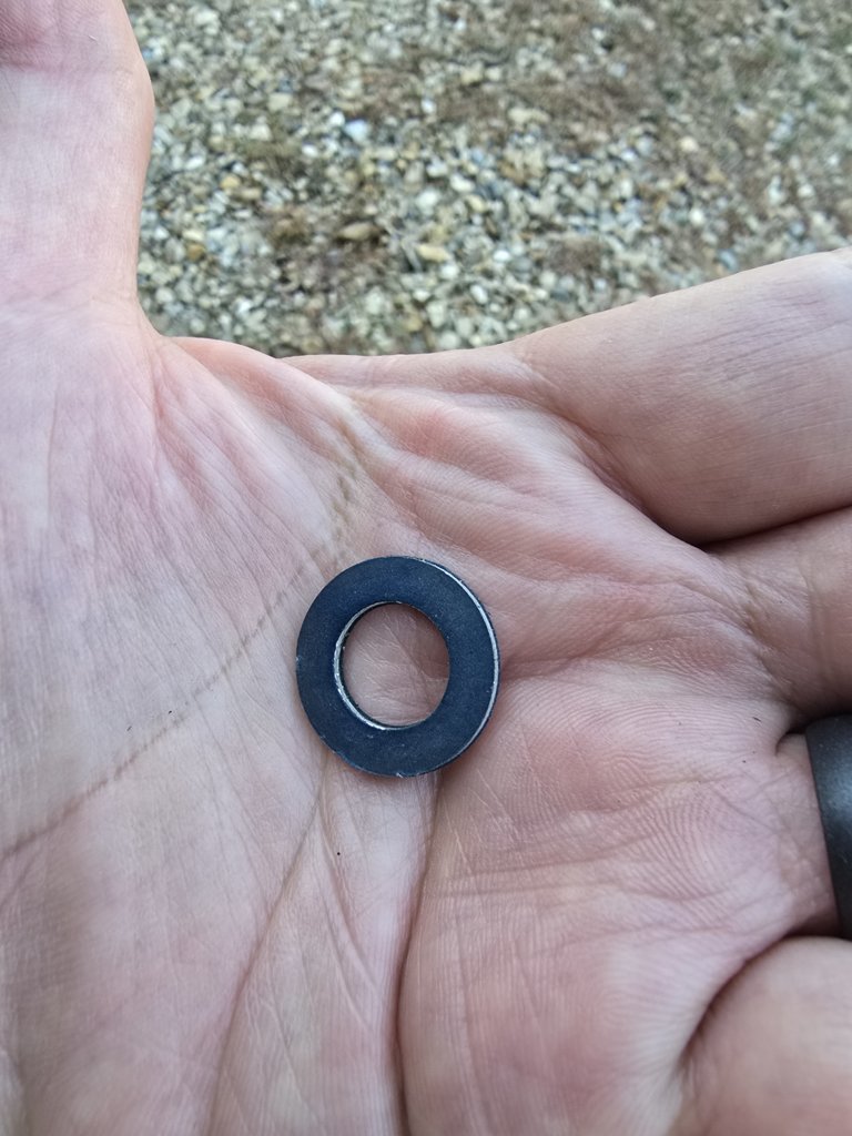

    Found it in the box with my old filter from my 15k oil change on my 2023 4Runner just this past weekend.

    It's probably stuck to your pan so you never notice it I bought my 19 brand new and the washer has been stuck to the pan since my first oil change.

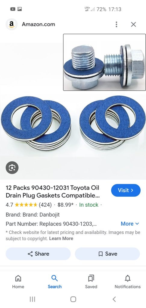

    I ordered some Amazon ones that claimed to be genuine and had great reviews.
    I found that the material was too soft and the drain plugs did not hold torque. They worked loose and my tundra drain plug was removable with my fingers at the next oil change.
    From now on, I'm only getting these from a dealer.

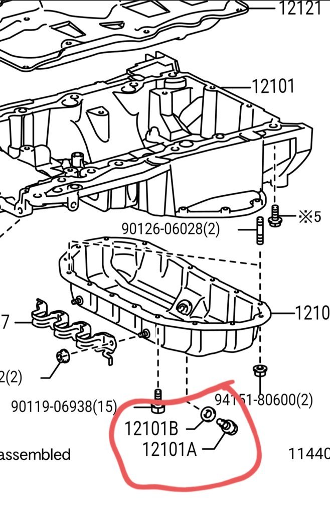

    Probably a good idea, I only put that picture for reference but I have some OEM ones ready to go if mine ever decides to come off my pan.
    Well, its supposed to be there. Here is the parts diagram from toyota of our oil pan, if you see where I circled 12101B is the washer, if you google 12101B you will see the blue washer come up. Here is where that picture is from.
    https://autoparts.toyota.com/products/product/plug-w-head-straight-screw-9034112012

    Just so I'm understanding. All the rest of us have or had them on all of our Toyotas, the schematics clearly show them as an OEM installed part, and Toyota makes replacement washers and makes them plentiful and easy to get even though no one should need them, but none of all those Toyota vehicles you have owned or worked on never had one AND Toyota hasn't used them in years. Got it.
    This product fits 3430 vehicle variants.
    TOYOTA : 49 models, 3328 variants between 1991 and 2024
    SCION : 5 models, 102 variants between 2004 and 2016
