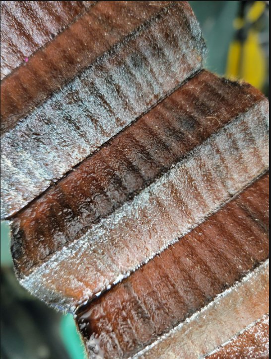

    It's straight forward. Looking in the pleats, should not see any glitter, perhaps a few random small glitter like particles. Then cut filter every change to watch for changes. Here is an example from my 700mile and 4500mile changes, nothing visible in the pleats. Once you do it, it's a 10 minute add to the oil change.

    Switch to higher viscosity.

    Why? Do you have actual data A/B comparison data? Testimonial, I think, I feel, I believe, I type in CAPs so it's true - none of that counts.
    Toyota has actual data to support 0w20 usage to get past the warrenty period. I'm confident the wear was evaluated well beyond 60k miles as that is part of reliability stressing. If you have ever worked in OEM environment, the rigor is well beyond most aftermarket suppliers.
    The filter was pristine showing running the recommended oil works. This included pulling 7k trailer several trips between the 700 and 4500 change.

    This is a suprising response from someone who says look at the sparkles in my pictures so I am right

    Do you see sparkles in my image? I didn't. And be real, wear occurs. I've been cutting filters for years had 3 GMS with 200kmiles. A random particle is normal. Increase in particles will get attention.
    Motor oil discussion are often opinion based. Forum folks have all the answers. Yet how many cars are running with the cheapest oil Walmart sells? When was the last time you heard of a failed engine where it was stated the wrong weight oil was the root cause?
    And yes, it's my opinion the oil is sufficient based on viewing the oil filter. At least I present a data point.

    Because you have glitter from main bearings in your pan/oil filter.

    As too the glitter, well thats pretty useless since Toyota won't do anything till it blows up. Looking at glitter does nothing for you and there's nothing you can do to stop a bearing from failing.

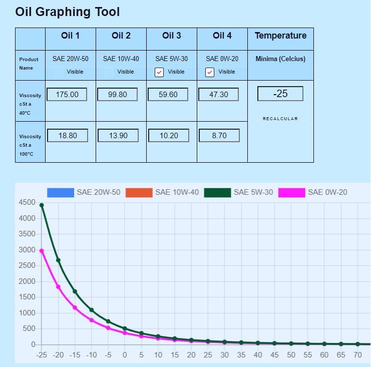

    No point in not using 5w30 instead of 0w20. You won't loose even 1 MPG. Viscosity difference at operational temps is marginal. Some thicker 0w20 are very close to some thinner 5w30. You can even go ahead and switch to Red Line 0w20, which is thicker than Toyota 0w20. But you can get better viscosity for less dollars. Thicker oil film is what keeps you from seeing glitter in your oil filter. Thicker oil and higher grade gasoline. And short oil change intervals. And don't be stupid and don't floor it at 100+ degrees ambient temps.

    Can you share the data on the marginal viscosity differences?

    Thanks for the link. While the data shows the cSt of 0w20 and 20W50 are similar at operating temp, it's the start up where different. I'm in VT up near the border, we spend maybe 4 months at 0C and during that time will experience -25c. I recall tribal knowledge suggesting most engine wear occurs during warm up. I have clipped a image of the data from the page you provided selecting 5w30 and 0w20 to keep the cSt scale relevant. In my climate, I can see the advantage of 0w20 as the cSt is significantly lower at -13F. They are similar at 68F.
    Looking only at cSt, I do not see an advantage to using 5W30 in place of 0W20. There may be additive package differences between grades, I suspect that is IP not in public domain.

    You're right that most of the wear happens during start. That's the situation when you want as thick oil film as possible.
    I camp in winter in northern Maine, 5w30 in negative temps is no problem in the morning.

    Interesting comment. My understanding is the thinner oil will get distrubuted across the engine sooner that thicker oil. Pressure is a measure of restriction, not flow.
