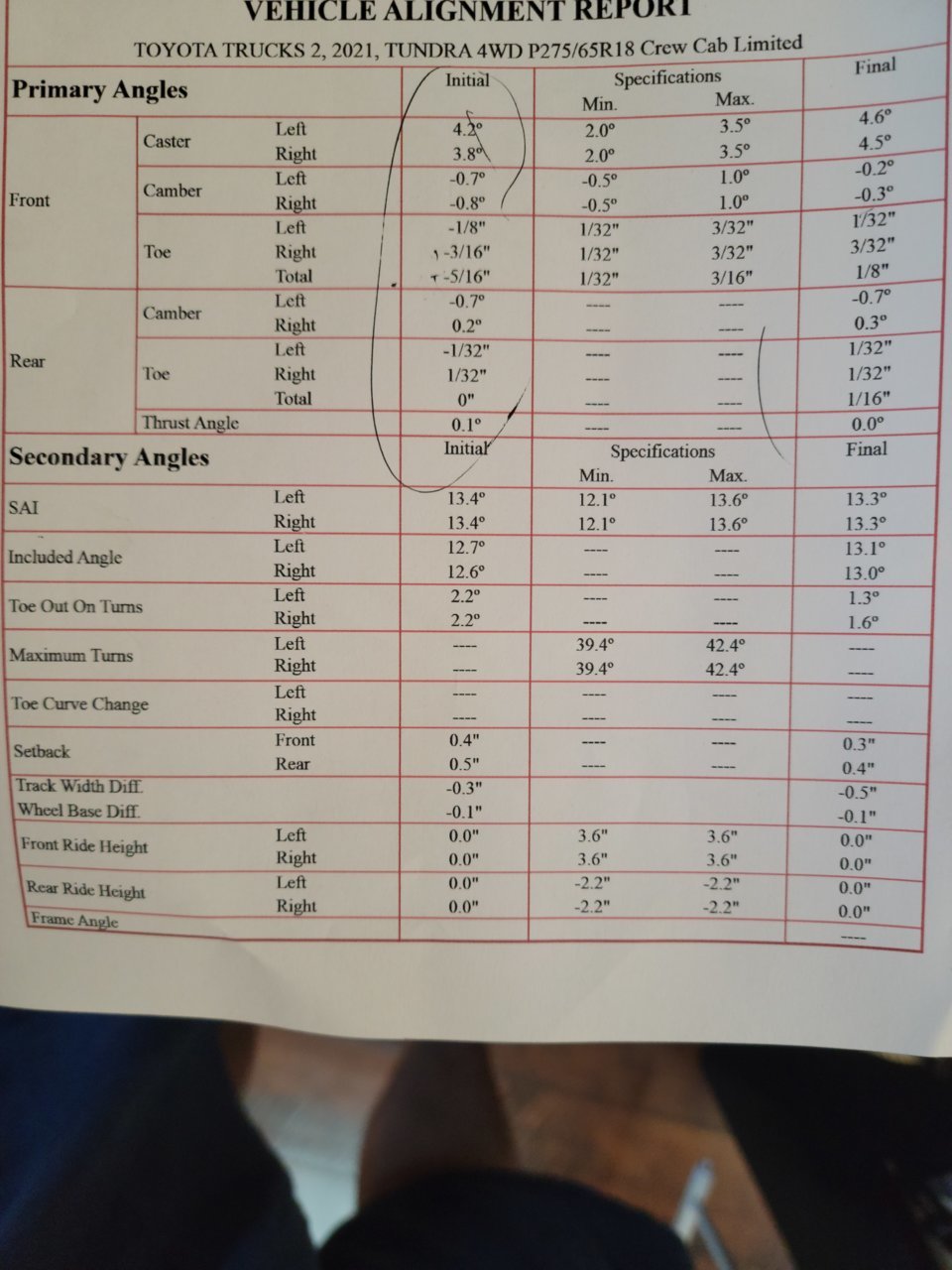

    So just got an alignment since it's been more than 5000 miles and more than a few offroad excursions, the truck needed it, could feel it.
    This is the results of the alignment, what do you guys think? This is supposedly a good shop, the Toyota offroad shop by me uses them.
    The trucks steering will is a few degrees clockwise which is annoying but the truck also slightly pulls right. Am I just not used to a high caster alignment?20220220_074901.jpg

    I'm no alignment expert, and final numbers seem tight, they are never the same each side. But steering wheel should be straight and the truck should not pull.
