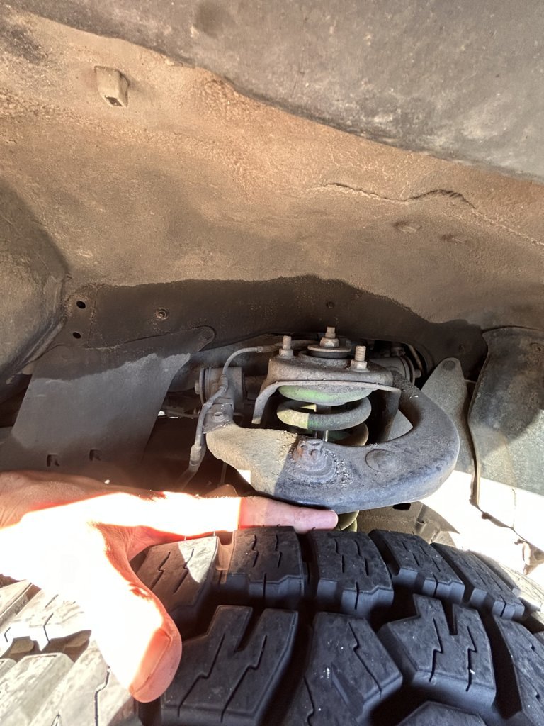

    Before answering, please tell us more about your setup. You're not doing anything really fucking stupid, like using struts to lift your truck and a strut spacer at the same time, are you?
    And wheels are scraping the top of the UCA, like when the suspension is at full extension, tire/wheel hanging fully down?

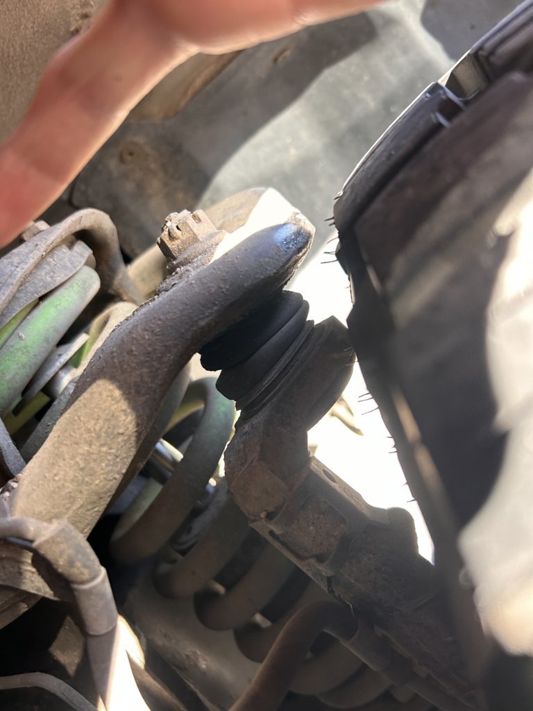

    No im not doing anything fucking stupid but unfortunately that’s a valid question lol, no shims anywhere, it has a 1 in lift via the coilover is actually 1 in longer, ( iron man 4x4) shocks.
    I am running 265/70/17 stock Tacoma wheels,
    As you can see the CV angle is acceptable aswell, really my only question is will I need lover studs for a 1/8 to 1/4 in spacer or shim or any other materials I would need
    edit- when driving on road my suspension never articulates enough to run the arm unless I hit train tracks or a big dip, but when it does droop you can see the shinny rubber it left on the edge of the arm

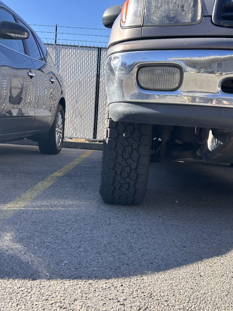

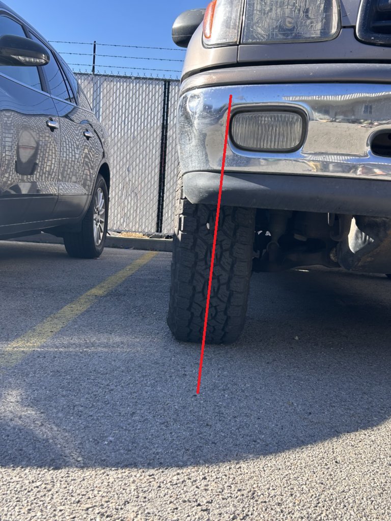

    What wheels are you rocking? It looks like the backspace is not ideal. You really don't want to have more than 4.75" backspace, with ideal being somewhere between 4.5" - 4.75".
    But I can also visually see your camber is way the fuck off and that may actually be contributing to your issue. Unless it's weird angles. Throw a 4ft level on things and check. (EDIT: I''m using the black stripe on the fence to gauge what true vertical is for this picture.)

    Offset is trash. Time for new wheels or 1" spacers for ideal clearance, I highly doubt a 5mm spacer will help.

    I got my alignment done a few months ago and it was good, but I’ll check it out, looks like the offset is the problem which is a bummer, thanks for the info yall
