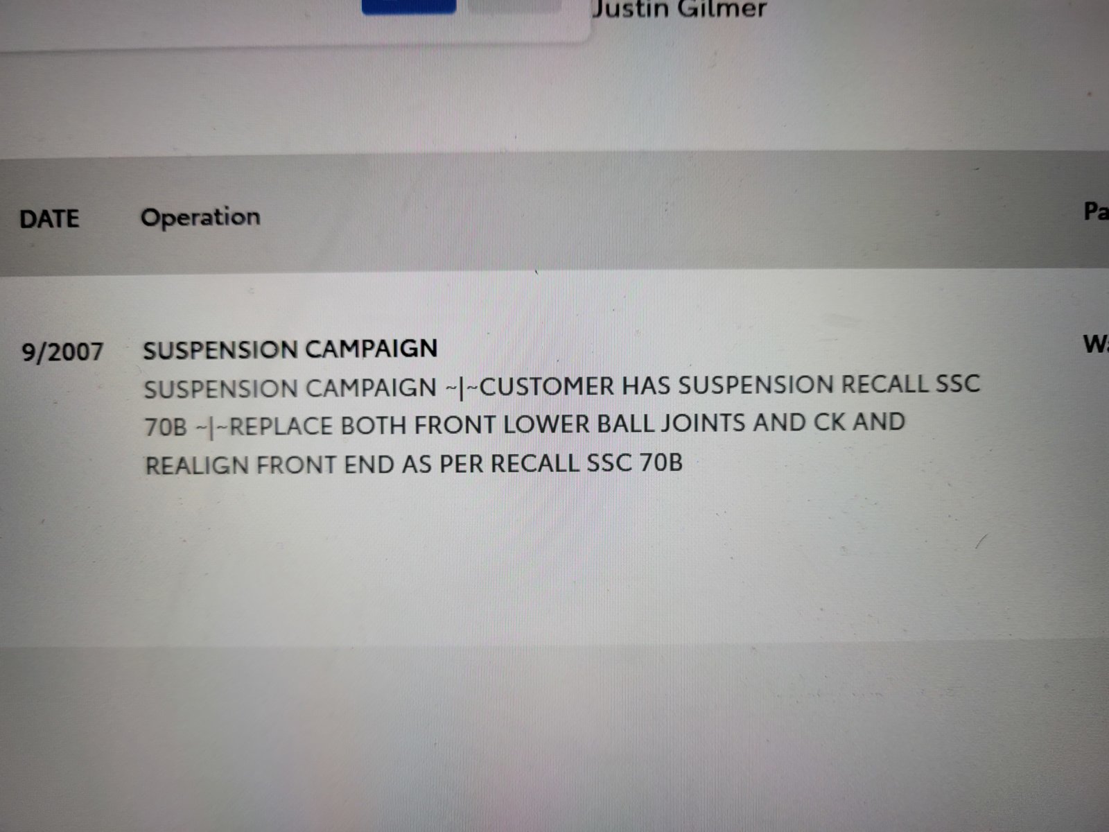

    I assume this means they were replaced under the recall?
    G_unit3000 likes this.

    Yes. How many miles since then?

    About 87K miles since then. Recall done at 10,200. About 97,200 now.

    You're due then. New LBJ's and bolts.

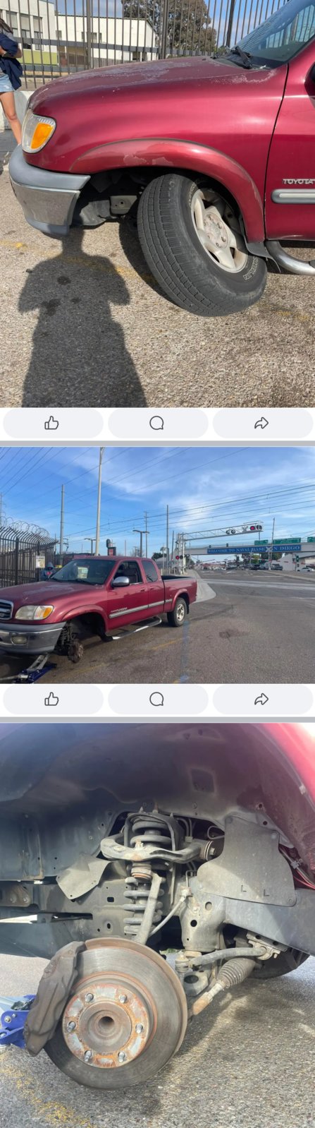

    Another one bites the dust.
    According to the person who posted these pictures, this is the second time the truck had a LBJ failure in 190k miles.

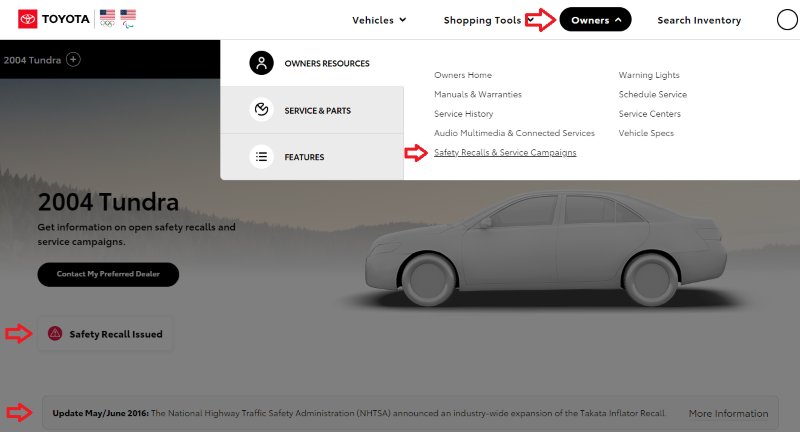

    So I've been trying to log-in / check the Toyota website for recall info.
    The site toyota.com/recall keeps saying 'Sorry an error occurred' . . . been that way since yesterday.
    Does anyone have a different link, or one that works?
    I triple checked that I'm entering the VIN correctly . . . maybe I'm missing something else . . .

    https://www.toyota.com/owners/
    Create an account, Input VIN, claim ownership, go to Owner > Safety Recalls
    Example for my truck. You can see I still have the Airbag recall outstanding.
    You can also call your local dealer.
