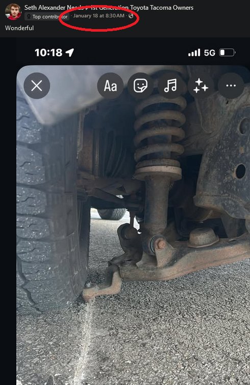

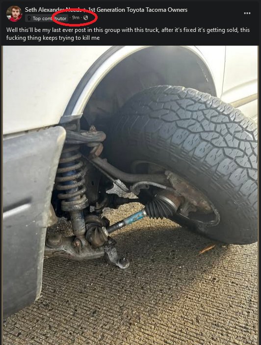

    Not a Tundra, but same difference. You can't make this shit up. Different sides, yes, but still.

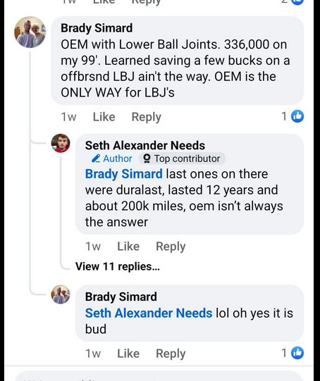

    I wouldn’t go 200k on OEM myself, never mind Duralast.

    "lasted 200k miles", in nearly the same breath as, "this truck is trying to kill me". How fucking ignorant, bass-ackwards can you be? More like he's trying to kill his truck. Are people really so dense they don't understand ball joints are a wear item?
    The stupidity is painful.

    It would be nice if you could reach trough the internet and bitch slap people.

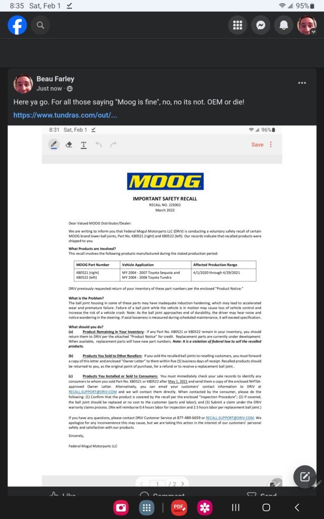

    Has anyone bothered to post this over there?
    https://static.nhtsa.gov/odi/rcl/2022/RCMN-22E002-1780.pdf
    These are parts Moog still sells today.

    Moog supposedly have a class action lawsuit against them for this but I can’t find it online. If I do, I’m sure a bunch of Facebook 1st gen Tundra owners will sign up.

    It's called animation. The idiot has given his truck free will.

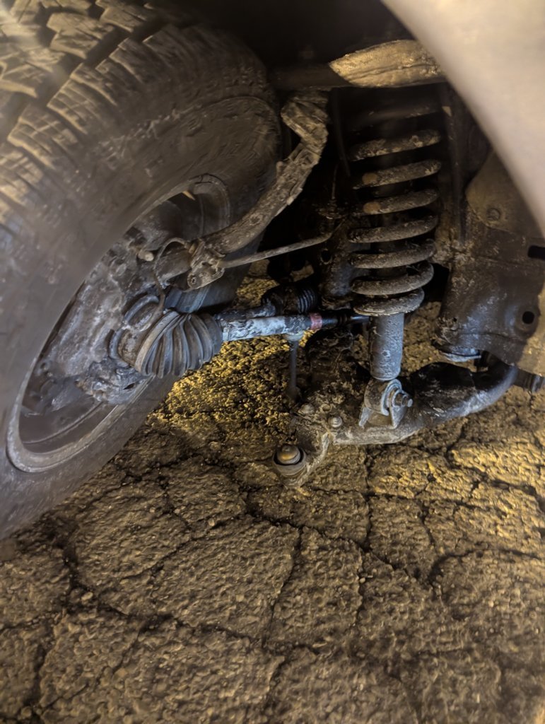

    Summary - LBJ failed after 133k miles, 17.5 years on a 2005 DC 4x4 that spent entire life in the Northeast and had the LBJs replaced in the 2007 Recall campaign. There was an early sign of leaking grease and a subtle wandering sensation but there were no noises, no grinding, and no popping.

    I too experienced the wander and generally sloppy looking boot and surrounding area and I too kept driving. I’m one of the lucky ones. I replaced mine with OEM + new dust / debris guards. In my hubris and general invincibility complex, I believed my 50k+ mile moogs would not collapse on me. Heck, I wasn’t even sure they were really bad as they had no physical symptoms when checked on the vehicle. Upon removal of the LBJs, it became readily apparent how worn they were. One was able to be rattled around in the joint. The design and implementation of these joints puts them in a stress or loaded situation at all times. Checking them on the vehicle may not produce the classic signs of failure. Use OEM. Change before they fail. They are about $200 a pair from Toyota. I will change mine at each timing belt interval as part of my 100K mile major maintenance interval.
