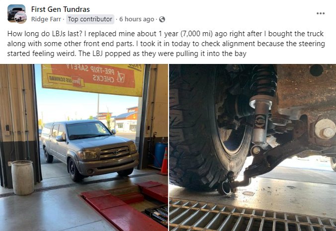

    Yeah this is one of those situations where you really can't fault the mechanic. Unless they know 1st gen Tundras and Tacomas and the LBJ problems, they don't know. I've heard the same. Often no warning at all before failure. Which is why so many people on Tacoma and Tundra forums recommend the ~100,000 service, regardless of all signs that they're "fine".
    Second generation Tacoma LBJs are like our UBJs. They're being compressed by the weight of the truck, not pulled apart by it. I'm guessing most (?) ball joints on other vehicles are like that. So even when there's play, it's still fairly safe. But not with ours.

    Truth. My passenger side lbj felt fine on the truck. Once removed, it was just rattling around in the cup. I almost died.

    The ones I removed recently that were leaking grease are still fine after removal. Better to be safe than sorry I guess.

    The guys on that Facebook group must be aware by now of the LBJ issue, so how do they let it keep happening?

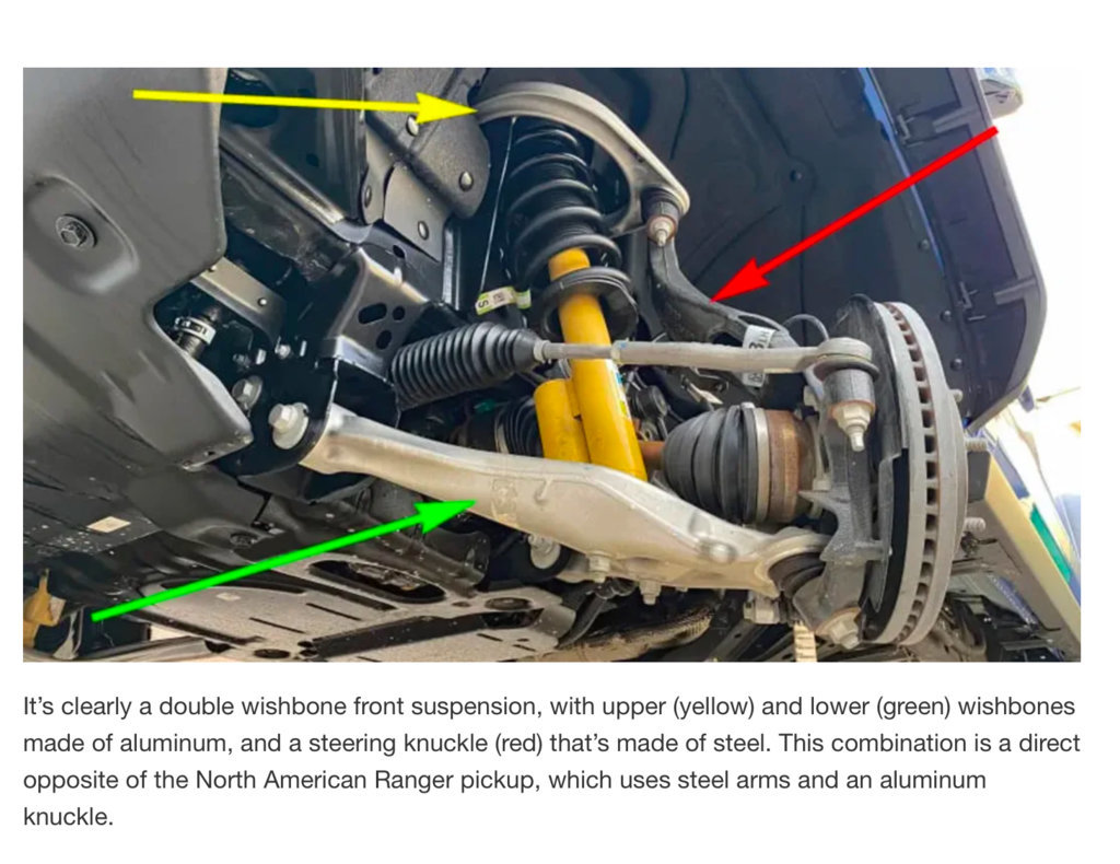

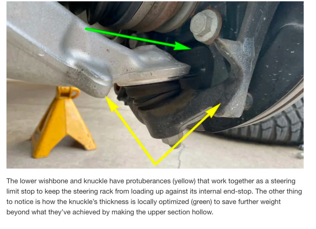

    I was hoping to see something obvious like the 1st gen Tacoma/Tundra design flaw, but no. There may be some other obvious issue, but they're at least set up so that the ball joint is being pushed together by the weight of the truck, not pulled apart.
    Not sure exactly what year model this is, but it's the new Bronco.
