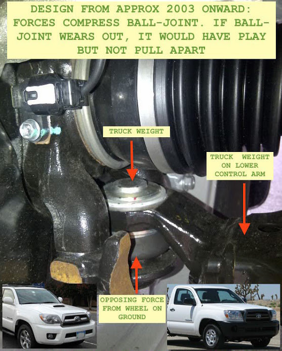

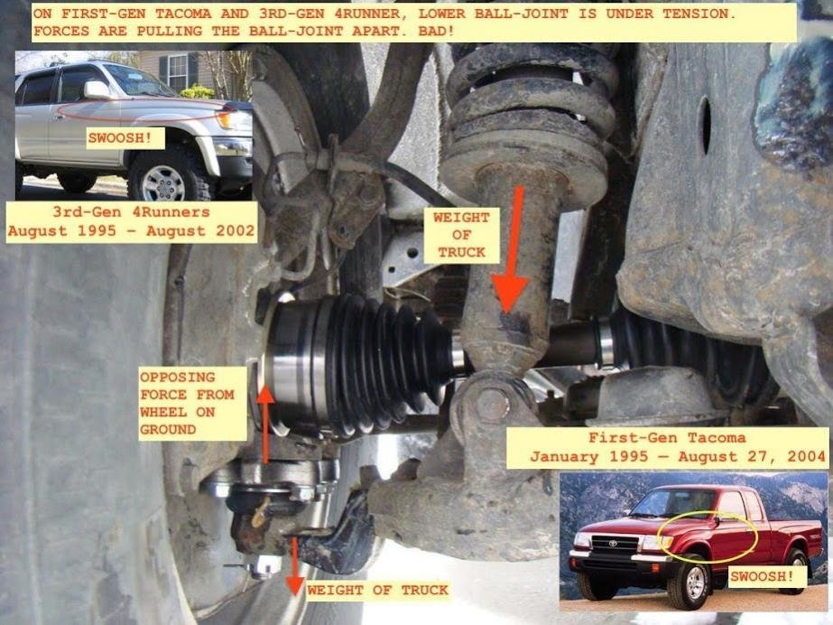

    From what I've been looking at, on an IFS setup, it looks like basically all LBJs are built in tension while the UBJs are in compression. On solid axles, it looks like they're all both in compression.
    What needs to be done is the lower portion of the spindle needs to be designed to go under the lower control arm.

    2002 AC 4wd V8 Limited
    It's not a feature of IFS, it's a bug.
