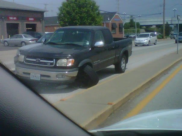

  16. Aug 21, 2024 at 9:02 AM
    #346
    Baller
    Baller New Member
    Jul 22, 2018
    #17275
    812
    '05 Tundra SR5 DC

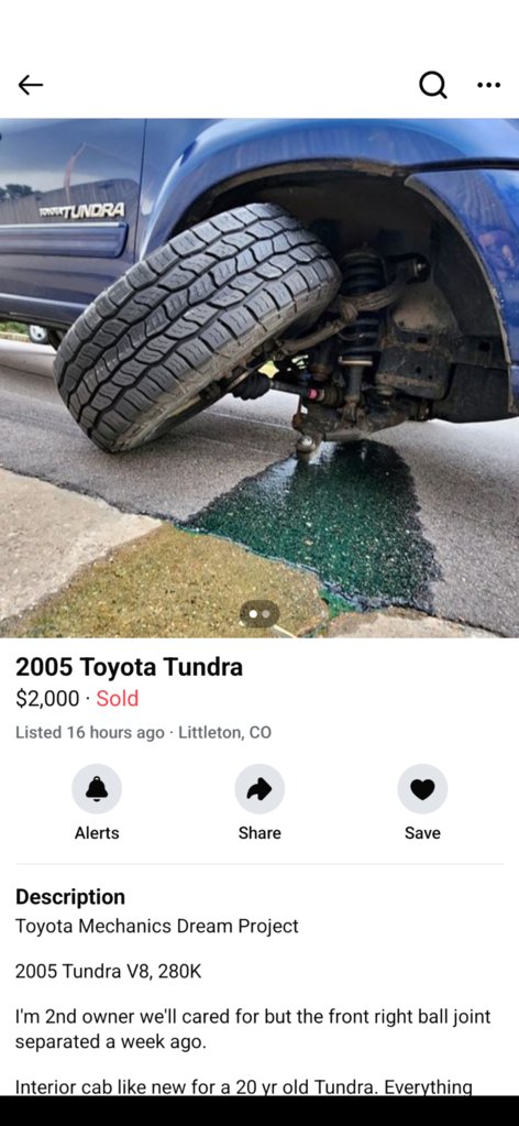

  28. Aug 24, 2024 at 11:07 AM
    #358
    FirstGenVol
    FirstGenVol [OP] Recovering mangler
    Dec 13, 2018
    #22934
    14,291
    East TN
    2002 AC TRD 4x4 V8
    This was a steal for someone
