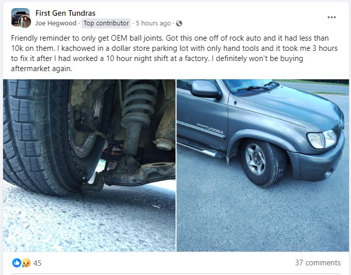

  6. Aug 18, 2024 at 7:54 AM
    #306
    des2mtn
    Jul 1, 2020
    #48721
    4,513
    SW
    2004 Black DC Limited 4x4
    Tonto cover
    Nut is on the bottom still attached, the ball on the LBJ definitely got pulled out of the socket. LBJ plate is still on the spindle.
  7. Aug 18, 2024 at 8:08 AM
    #307
    KNABORES
    KNABORES Sarcasm incoming
    Jan 1, 2020
    #40572
    14,329
    Arkansas
    Truth. Dodged a bullet with these moogs. They felt okay driving around, but the passenger side had a shit ton of play when removed from the truck and could be clunked back and forth in the ball-socket joint. New OEM ones feel great now.
