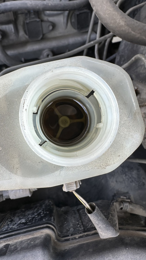

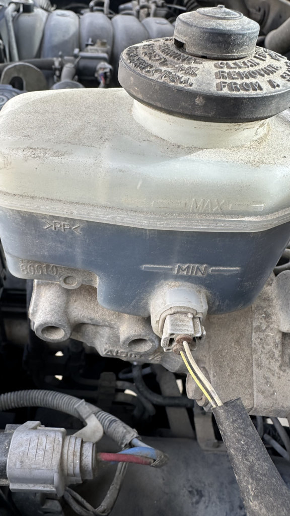

    Okay, so I checked and it looks like I do not have "Auto LSD" in the dash when I turn the key over one time. But let me know if there is some user error going on here..
    Also, looking back over my maintenance record, it looks like the rear brake shoes and drums were changed out about 35k miles (6 years ago). It seems like the brake drums should be good for a long time, but maybe it's time to change the shoes out? If so, do I need to bleed as well?
    Is there a scenario where it's only necessary to bleed the front brakes and that's fine or is it an all or nothing situation? I really just don't understand how brake drums work and the maintenance required there.

    Correct. Be very careful not to let the level get down to the bottom of the reservoir. If it does, you introduce air to the system.

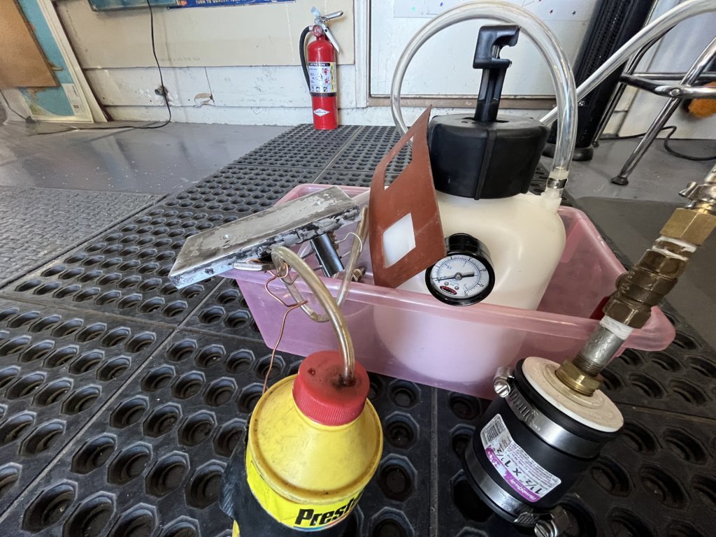

    I got one of these and love it. Never doing a bleed the old way again.
    Some notes on usage:
    It comes with a crappy chain and hooks that may or may not for your application. If it doesn't fit go to the hardware store and get some new hooks/chain.
    As far as pressure goes I would only pump it up as much as necessary. The reservoir is not designed to be a pressure vessel, so be nice to your old plastic. On my 01 highlander, the fluid starts to flow around 10psi or so. I usually got to 12psi and have to bump it up once or twice for a full bleed. (Haven't done the Tundra yet). Not sure if this makes a difference but usually run on the ignition and give the pedal a little push to get everything moving.

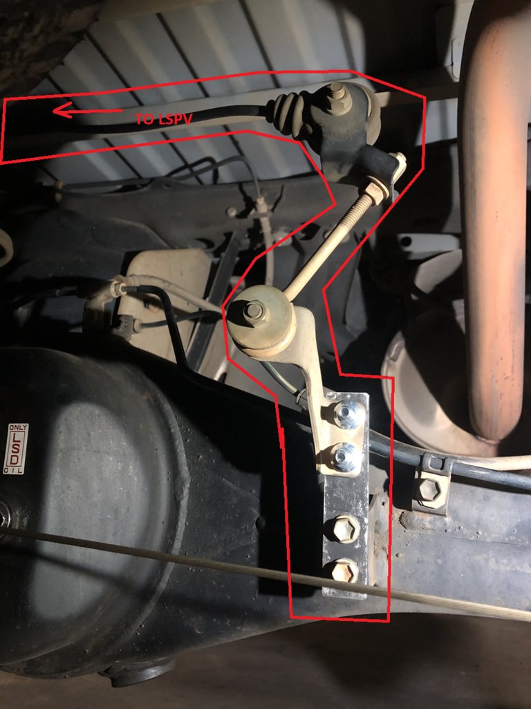

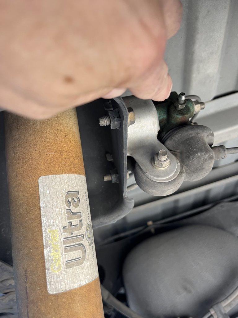

    Would appreciate some guidance on brake bleed. I have the 05 4.7 4x4 with no Auto LSD button. Can someone help me locate the bleeder screw for the LSPV? Never done this before, just reading the above thread. And what order should the LSPV be bled? Thank you

    The screw is the nipple itself. LSPV is 2nd in line. Passenger rear, LSPV, drivers rear, passenger front, driver front.

    Is it too much of a noob question to ask for a picture?
