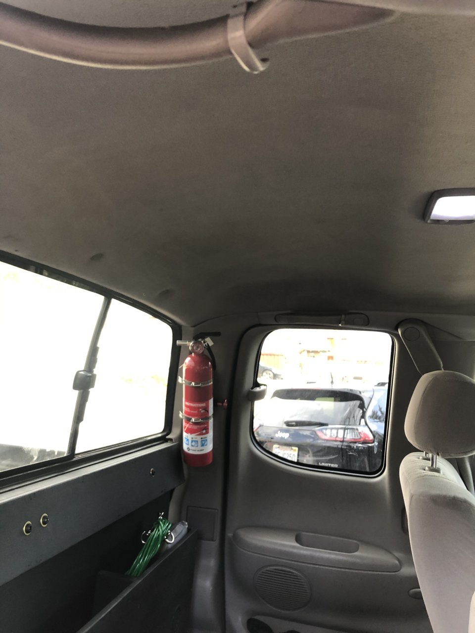

    Small update. Got a few strap down anchors installed. They seemed like they’d make a lot of noise so I pumped silicone in the top section and wrapped black electrical tap along the sides.
    Not pretty but they sure won’t be making noise.

    Got it installed for the most part. I’ll need to make a Z type slot/holder for the back side of the doors which I’ll work on tomorrow but overall came out pretty well I think.
    The “secret” compartment is basically hidden unless the passenger side seat is pulled forward.
    Just need to make a latch for the “rear/backside” of the doors so they stay down tight and I’m happy with it overall.

    I may have to borrow both your anchor idea and fire extinguisher mount idea.
