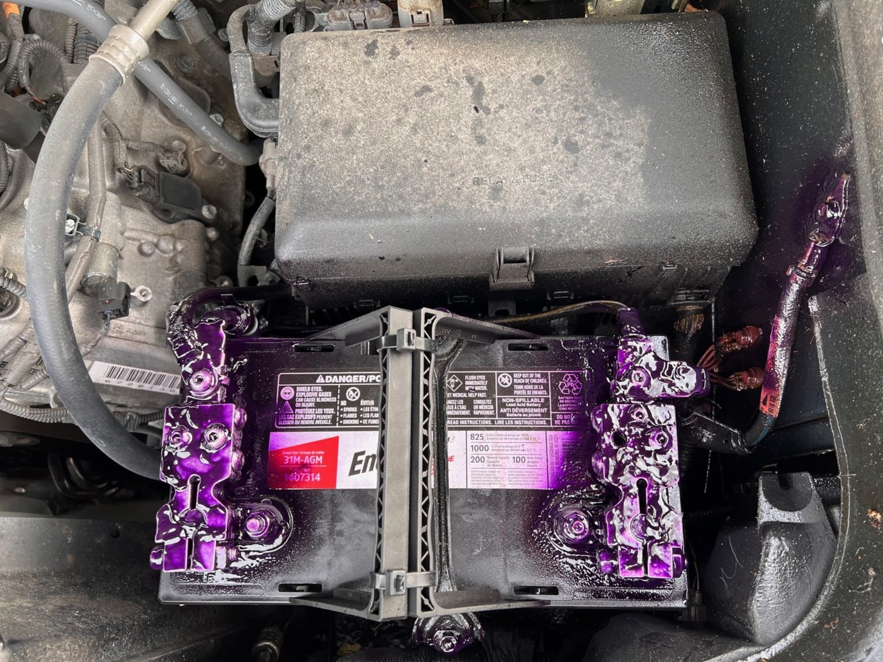

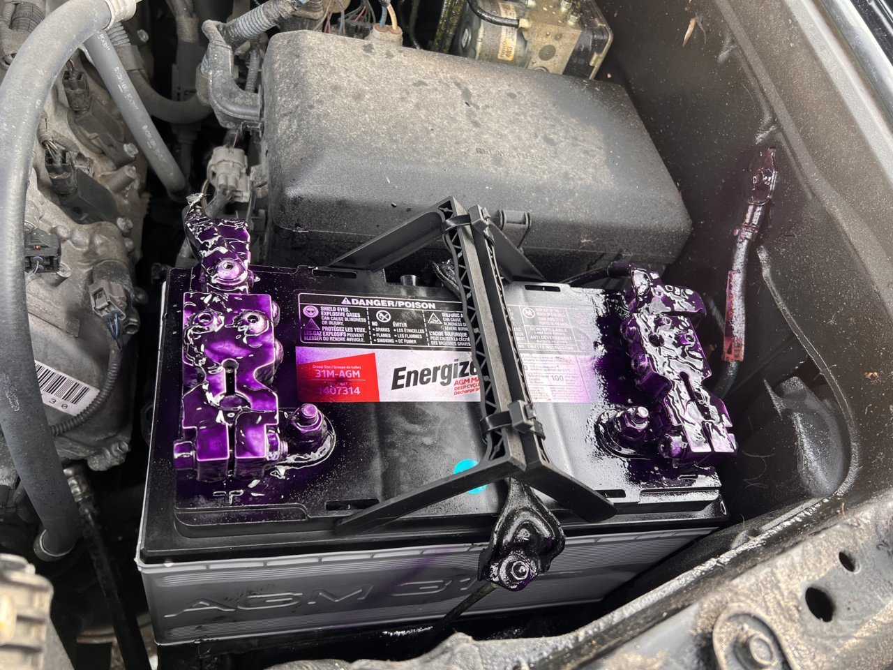

    2021 Tundra and everything is oily! you have to be proactive on that rust.
